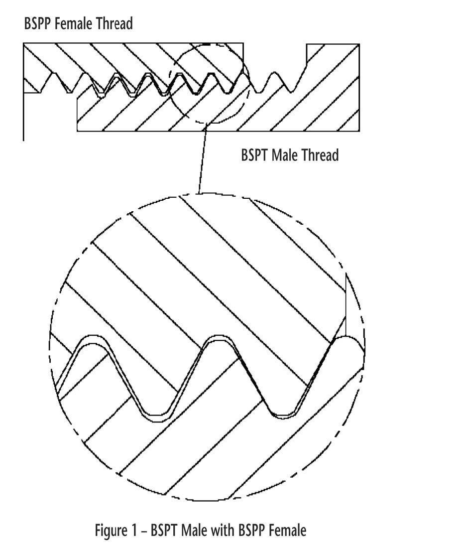

Since we are learning not arguing I will add this.
NPTF/NPSF (Dryseal) is a more demanding standard, harder to manufacture, and requires proper assembly technique to work. By the very nature of the design it is not well suited for reassembly.
Quite by accident I discovered that Kubota currently uses NPSF (straight threads) for the female ports in many of their hydraulic outlet blocks. The reason for that is almost surely because they are easier (and cheaper) to tap at the factory. The dealer techs assemble that "by the book" using a NPTF male hydraulic fitting and (gasp) PTFE tape.
All of that is 100% in accordance with the ANSI/ASME Dryseal standard and ISO/BSP does have an analog for the same reason - ease of manufacturing. ISO/BSP allows male R (tapered) thread to be paired with a female G (straight) thread and when used with a thread sealant it produces pressure tight joints.
The fittings in the plumbing section of your box store are generally NPT and poorly made at that. Bubba the plumber doesnt understand any of this thread standard nonsense so he goops everything up with sealant or tape to be safe. Time is money so he works fast and in the process occasionally contaminates the system with whatever sealant he is using. When he is called back because the customer's furnace wont light he discovers bits of dried PTFE paste sealant in the gas valve and bills accordingly :devilish:
All of that is 100% in accordance with the ANSI/ASME Dryseal standard and ISO/BSP does have an analog fir that and for the same reason - ease of manufacturing. ISO/BSP allows female R (tapered) thread to be paired with a male G (straight) thread and when used with a thread sealant it produces pressure tight joints.
