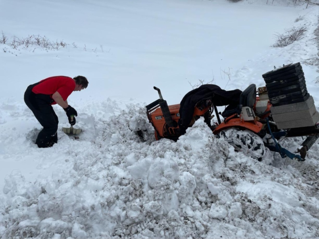

I watched this video. 2wheel drive, looks like a 6' blade in 8+" of snow. I'm hoping I do just a bit better .....
If my drivewaybas that flat and didn't have banks on either side I would be in good shape.
Below is an example of when I got a little overabitious the first year pushing the furrows over the edges. What you can't see is the large rocks under the tractor. It took me some time to dig out enough so I could get off the bank and back onto somewhat flat ground. I still couldn't get up the hill in the front lawn and ended up having to take the walkbehind snowblower and make a sort of path on the steepest section.
This was before I had the cast concrete weight made for the rear which works a lot better and lowers my center of gravity quite a bit
Ouch. Have done that with my side by side years ago getting to close to the edge.
You have nothing to be ashamed of ..... I did the same thing with a 78' F150 in a 4' deep slush covered skidder hole. My current driveway is 50' long and 20' wide. I bought the blade for a future house purchase. I wanted to get my tools before I retire. You are a better/bigger man then I for posting that photo.....glad it turned out ok.

aw, it's just some exercise and exercise is good, right ??!!!
bet the world heard some 4 letter words......
______ snow, nice ______snow,......fill in the blanks....
You know Mr. Jay, my wife tells me Bangladesh can hear me say those "fill in the blank words" when things like that happen.
I am a glass half full kind of guy (not) I didn't mind the excersise but that was probably the most amount of manual snow removal labor I did that winter on my property
