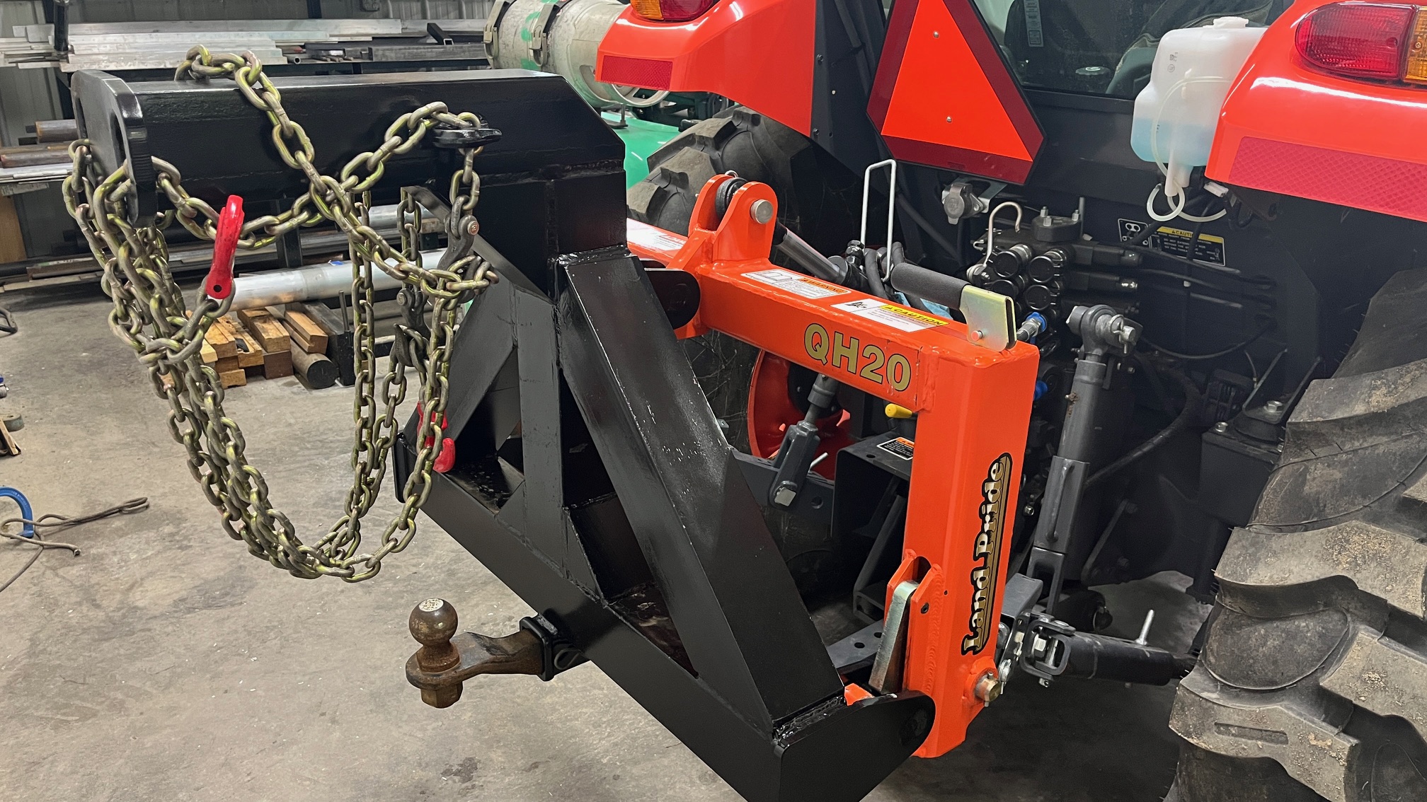

This is my 3pt ballast..............

Yeah, I need to make a stand for it..........I placed it on the quick hitch with the forklift.
I didn't think the stand through all the way... I have most of my old crap propped up on cider blocks... can't see why that would not work just fine.

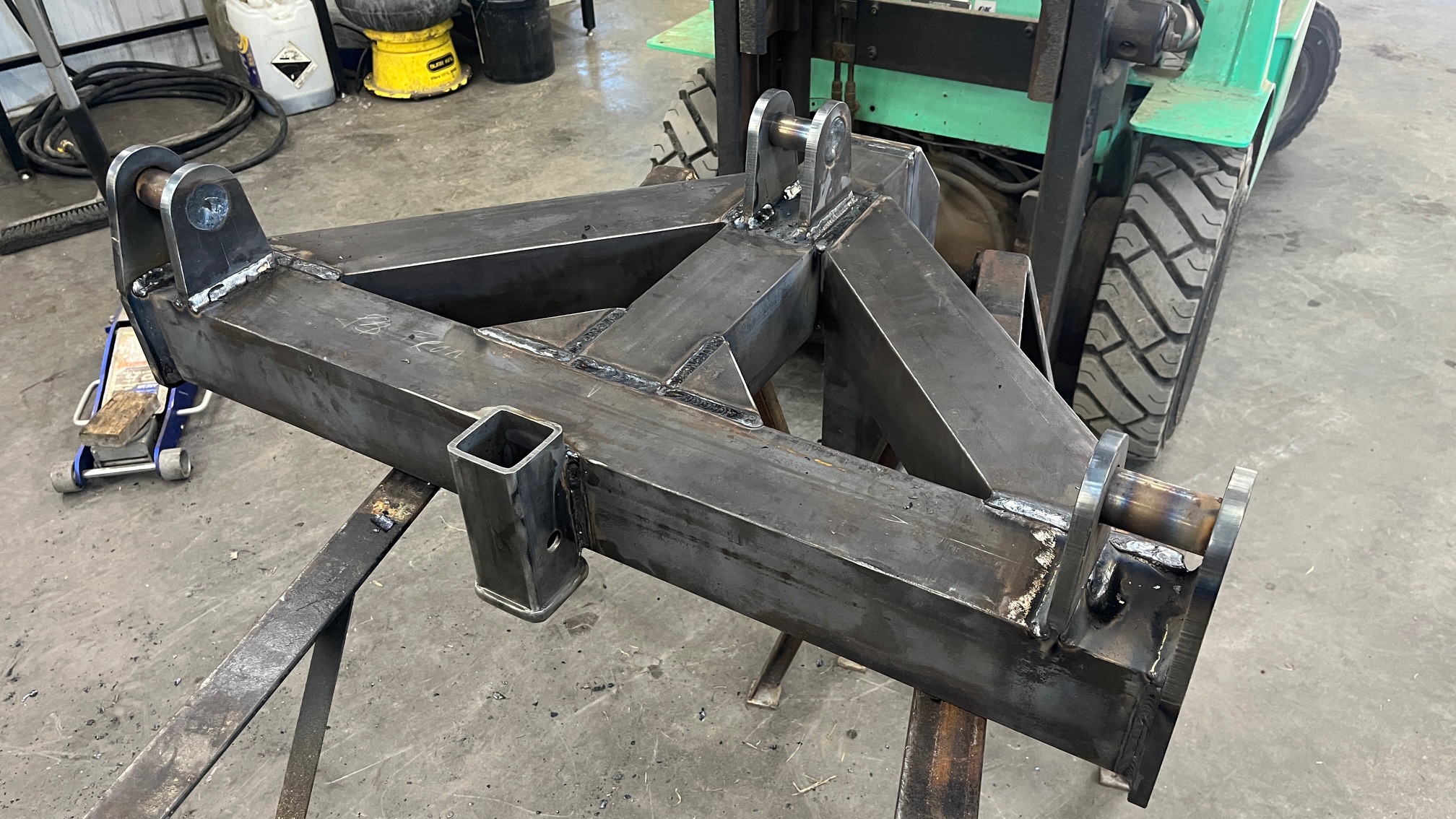

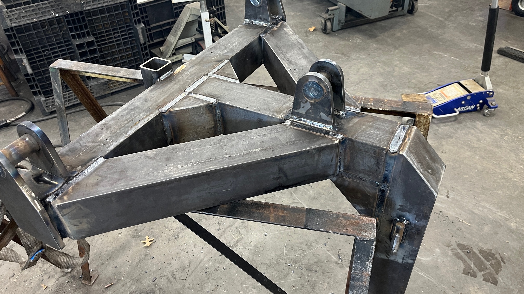

I never liked boxes or big hunks 'o crete hanging off the back of the tractor..........made myself something a bit more useful.
I've always had a trailer mover/log arm off the back. With this new orange rig I was gonna make one outa 4" sq tube when I had me an idear. Make it outa 4" sq solid. :eek:Gives me best of both worlds, a useful implement and close to 550 lbs for extra traction.šŸ˜Ž
That's pretty freakin' awesome! I imagine you preheated that steel prior to welding, given the mass.

Since you are working with solid material, do you do anything to get welds which involve the complete cross section of the steel pieces?
