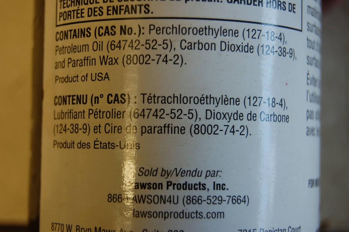

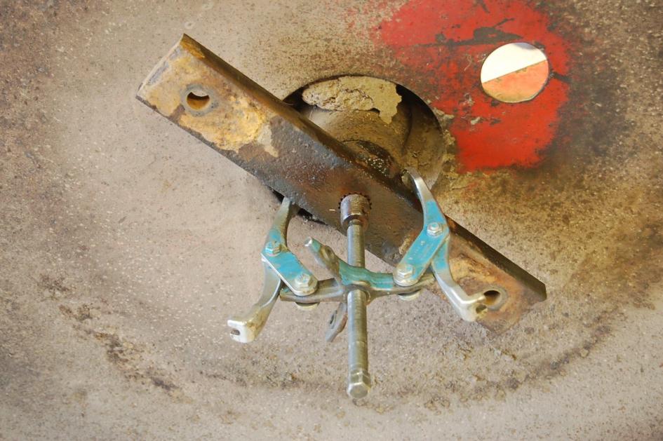

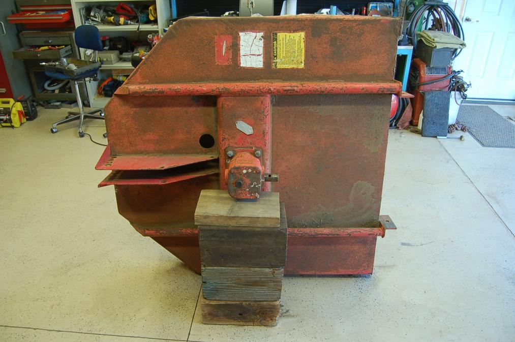

You may want to get it on its side and chained to something (tree?) so you have better access.
What Russell said :rolleyes:
That is what I did, I should have mentioned that :p
Also a hell of a lot easier to work on upright.
And once it is off, and going back on,
slather the hell out of that spline with anti-seize. :D
You will NOT regret it. :D
Why do you want it off?
Good question? my guess is general "serious" maintenance or resto.
I like to be sure things are "tear-down-able" (is that a word? :confused:) early on
so if I need to fix something it is not an issue later on....
Tooo much time on my hands ! :eek:
