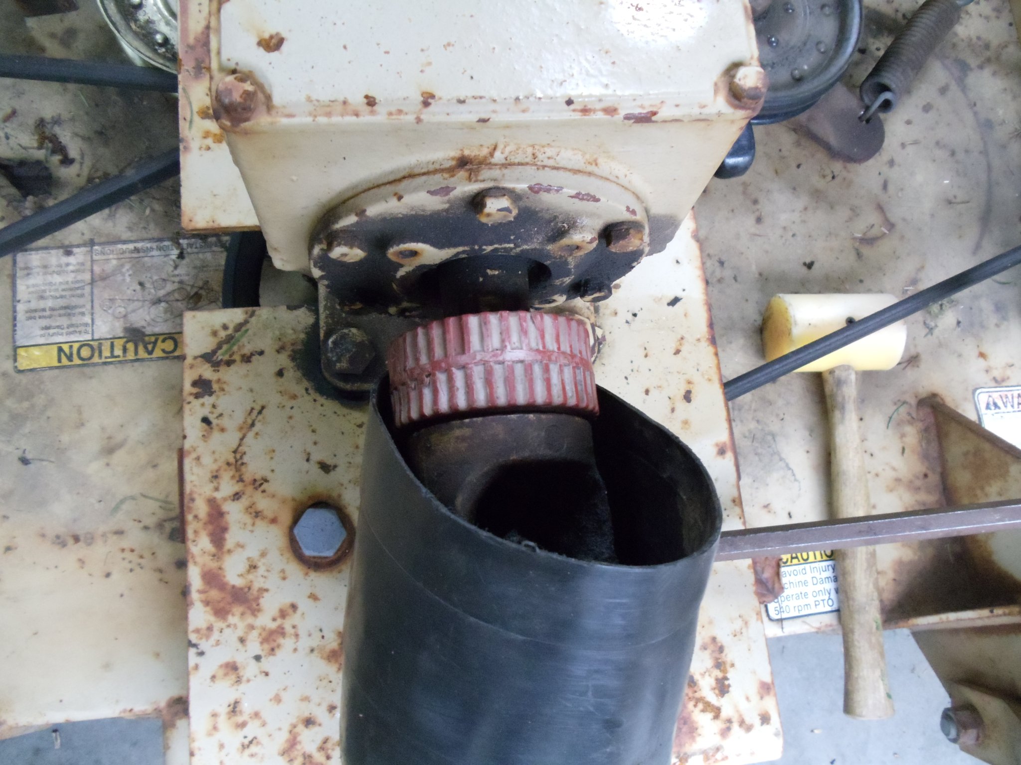

My neighbor gave me this land pride finish mower that had a sheared cutter blade bolt which he did not want to mess with. I am trying to remove the pto shaft which has what I believe to be a Eurocardan PTO Shaft. The shaft is stuck on and I am not sure which way the collar should rotate to release the detent ball. Any help would be much appreciated.

I have but because it is stuck on the gear shaft I do not know for sure that they rotate in the same direction to release the detent ball.

I've tried rotating it both ways, first in same direction as open end and then reverse. Its stuck. I don't mind tearing up the yoke but I don't want to tear up the mower shaft, and believe me it's coming off! :unsure:

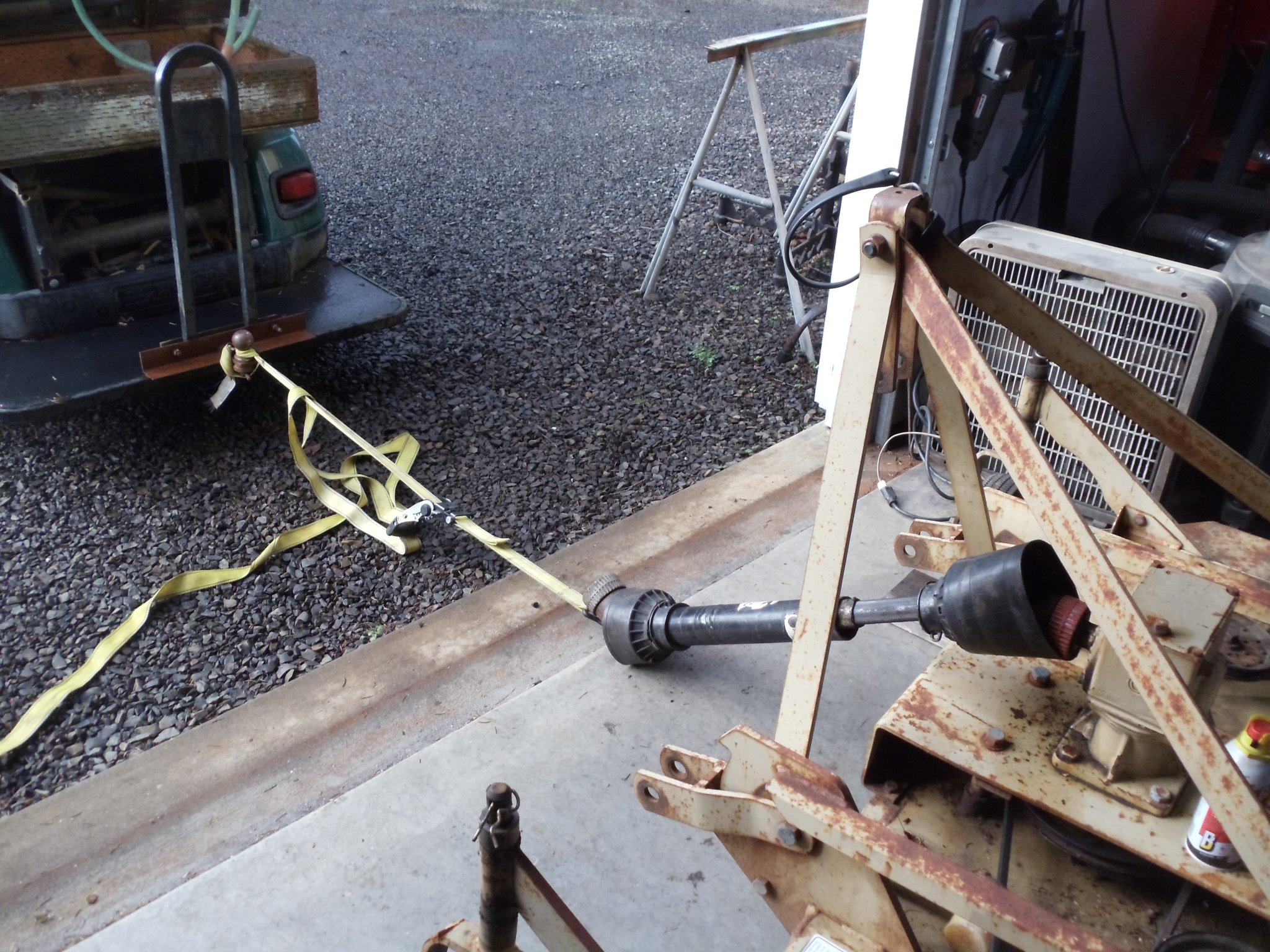

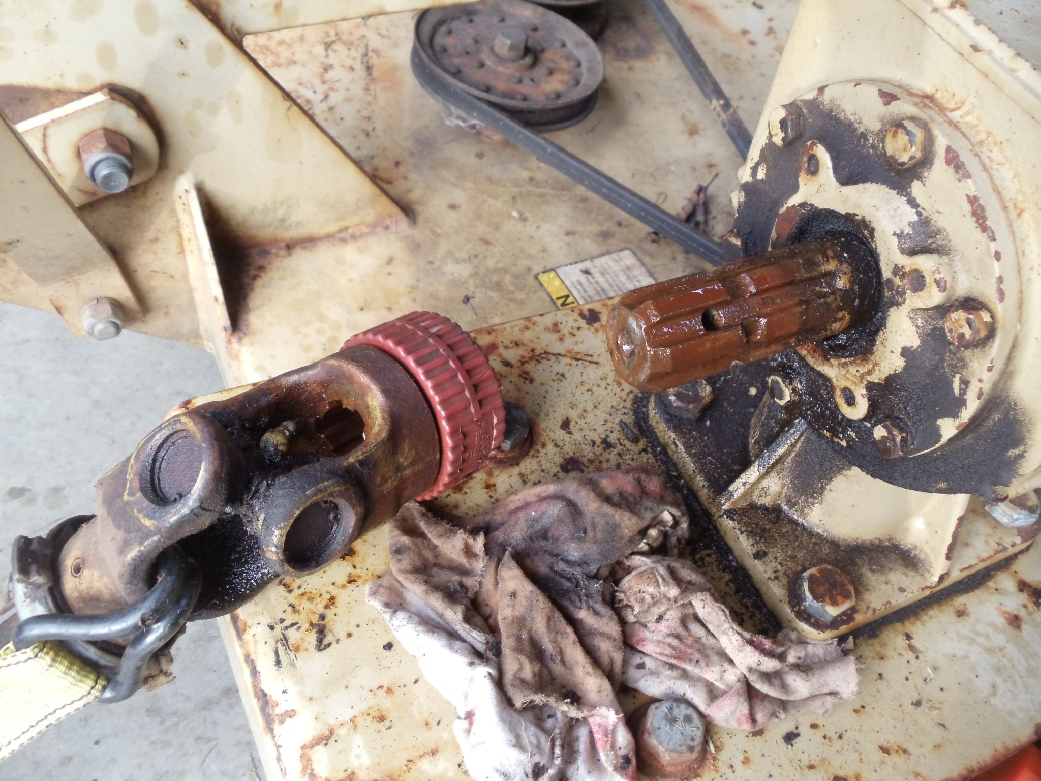

Success!
It finally pulled apart, with a little encouragement!
