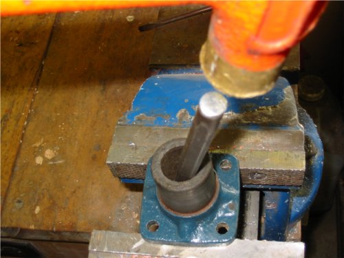

Hey Robert that idea worked great. I modified a bit had to use a long bolt with thin washer and was able to pry like a paint can lid
i got it out and now I am looking at the instruction part two and noticing I never took it out of the upper flange either. So that is where I am now. I think the instruction is a different model because mine dosent come apart like that at the bottom of the steering shaft plate.

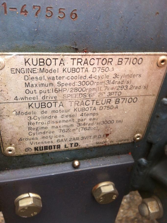

My shaft that holds the steering rod is about 12" long so it dosent look like the one in the pics. The serial number on my tractor is 7001-47556

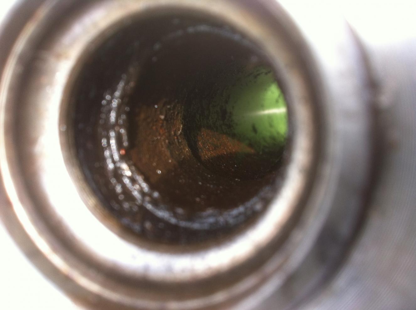

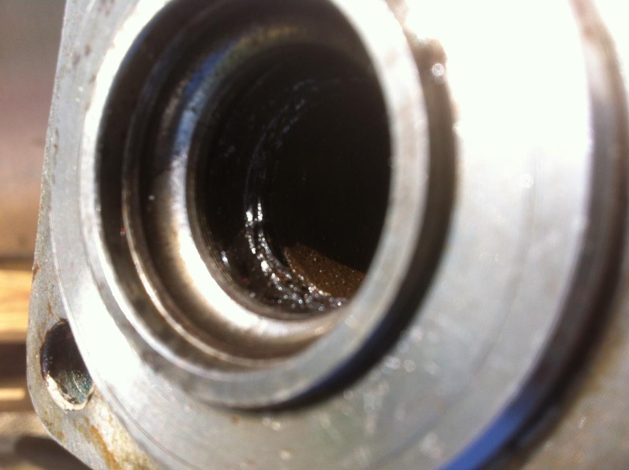

I am still having difficulty getting that thing out of there it is almost like it is part of the flange.
Here is how I am trying to do it...I am using a long 1/2" extension with socket at the end and beating it with a 4lb hammer.
I think the rubber seal is preventing me from getting a good hit on it..not sure but it feels like I am not hitting metal to metal. And then there is piece of split steel tubing in the end right before the rubber seal
Does that sleeve move? is it there just too push the race out? if so it would seem I have to get rid of the rubber seal first so it will hit against the race...

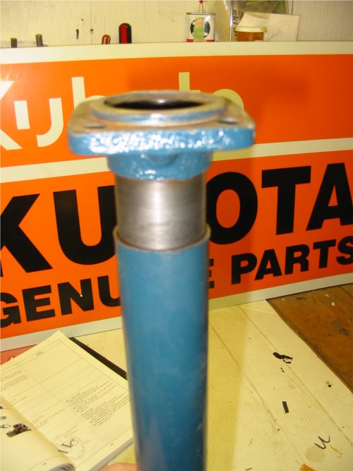

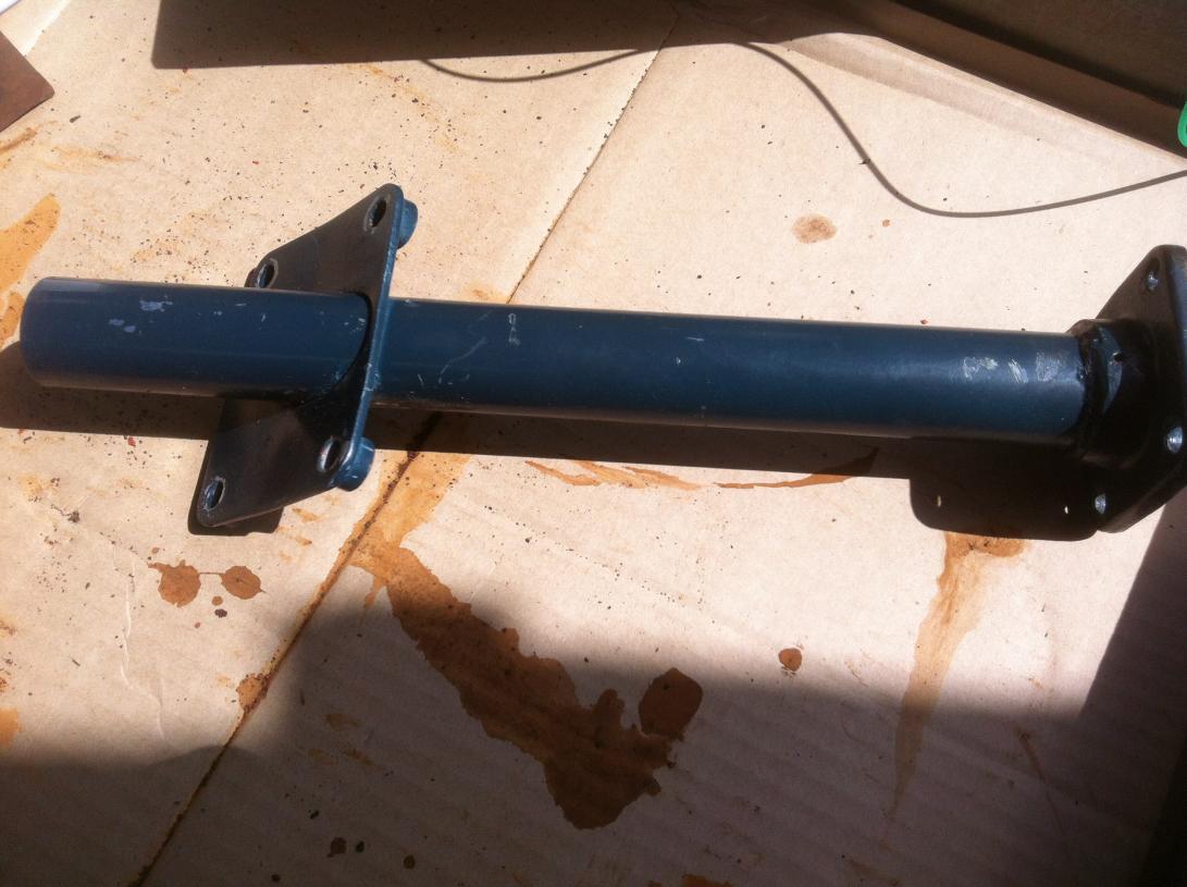

Oh jeese you still have the tube in there no wonder you can't get a grip on it. That has to come off leaving the bare flange. The lip of the race doesn't stick out far enough without that over of there. Lock the tube tightly in a vice (don't crush it though!) and then using two large screw drivers (or whatever you've got) to pry up on the flange. Mine was a little rusty and in there good but some patience and penetrating oil got it out without incident.
In the pic you posted it looks like there's something at the mating between the tube and flange. I'm hoping that's just RTV and not a weld bead.

Go back and read Vic's articles again, he had a description of how to get the tube off without destroying it. I think it was in part two. It should make it easier to get the race and seal out.
With all that said, I got mine out without taking the tube off; but my top race came out really easy, so easy I wondered if the new one would fit tight enough. The lower one was bad enough to more than make up for it though.
I would also clean all the rust out of the tube that you can; either by electrolysis or using a choreboy pot scrubber on a rod, then painting it the best you can.

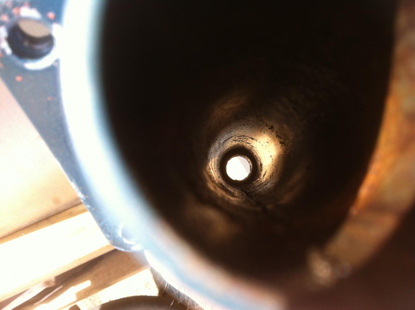

Stumpy and Robert...here are some better pics of the tube and race. I will go back and read Vics articles again. the tube is welded at the flange. On one of the pics you can see on the inside first the flange then the oil seal then this sleeve which if I could hit it squarly I bet it would hit the bottom of the race and knock it out. Now it is hitting the rubber first.
I wonder if thats how it came from the factory? Now I will go back and read some more and see what else I can try. I guess I could cut the tube and then get it re welded after I get that race out...back to vics article and stumpy the pics you attached are exactly what I was expecting to see after I beat it from the inside.. but I just cant get it to move....Ill post the progress.
Here are some hopefully better pics of the culprit...

As i said before, mine was welded too. This is what i used. Time meant more than a few bucks did at the time i did my rebuild. plus it was still cheaper than buying a questionable "good" replacement. My Dad told me many times that the right tool for the job will pay for itself over again. I have used it several times over for myself and other friends and family. Steering boxes, ford "n" distributors, etc.
Myself, it would be the right tool before cutting the tube.

After re reading several posts I forgot kytim had a similar problem and found a tool at harbor freight. I think I might take a trip to the cheap tool store....
Also need to figure out if that bead around the flange holding the tube in place is welded or epoxy sure would be nice if its epoxy or something like that...:D

Agreed Kytim, if that's welded and your's certainly looks that way Rick, I'd leave it alone. I do like the look of the bearing puller tool.

Well it doesn't look like you are taking the tube off the flange.
Like I said, mine came out easily, so easily I don't remember just how I got it out.
Here are a few ideas, they may work, you may have tried them already:
A long drift/ punch/ screwdriver (the most misused tool in existence) held at an angle inside the tube.
Put a slight bend 10-15* in the end of a punch, so you can catch the edge of the seal or race and tap it out. You may have to go around it a few times; but once it moves even a little bit, you are home free.
I used to have a slide hammer with external hooks that was used to pull pilot bearings from crankshafts. If yoiu had something similar and could get it behind the race, while the flange was solidly in a vise???
If these ideas don't work, I can come up with some more drastic measures, I am sure.

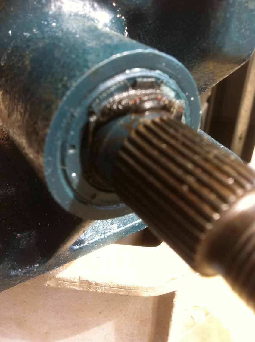

I also need to replace the pitman arm seal I think. It wasnt leaking but it dosent look good either.picture attached. From what I have read it seems that will come off easy. Its in the part 2 of steering rebuild so i have a guide.
I will post the progress
