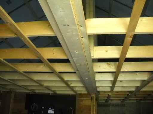

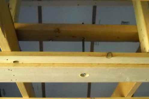

Finished strapping the ceiling joists and installed the framing for the winch trolley. Ran a 2x6 down the centerline right below the vertical members, nailed at each joist. Then I ran 2x4's above the joists where I could get them on the centerline and ran a piece of threaded rod up through and snugged it up. Bottom is countersunk so the barn door track the trolley runs in will be flush to the 2x6.

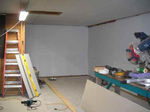

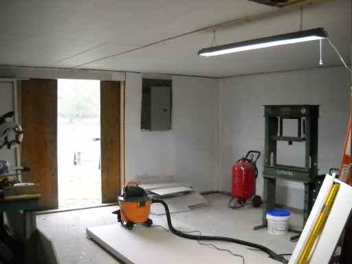

#1 Grandson came down for another work day and we got the major portion of the drywall hung. Just some narrow strips on the ceiling and a couple pieces on the lower part of the wall.
#2 Grandson is coming down tomorrow and we'll install the double man door. After that it's mud, paint and electrical.

Got all the drywall up, did a quick-and-dirty tape job (hey, it's just a shop...) and slapped a coat of primer on everything.
Rolling the ceiling about killed my shoulders, REALLY not looking forward to applying a second coat.
Hope to get #2 Grandson down this weekend to get the door installed and then it's on to the electrical.

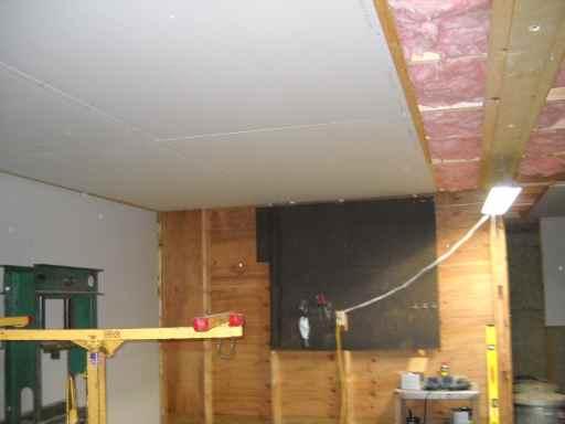

When I insulated The Shop To Be, I put R5 blue board between the rafters just under the tin roof, R19 batts in the ceiling joists and R15 rock wool in the stud bays. 1/2" dry wall on walls and ceiling.
It is 92° in the shade outside, and not a cloud in the sky. In my essentially uninsulated garage with the overhead doors open, it's 86°
In TSTB, with no windows and the door closed, it's 70° Started on the electrical as it was so comfy in there. Too freakin' hot for this old Yankee to be doing anything else.
If it keeps the warm in this Winter as well as it's keeping the hot out now, I'll be a happy camper.

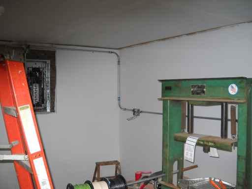

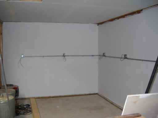

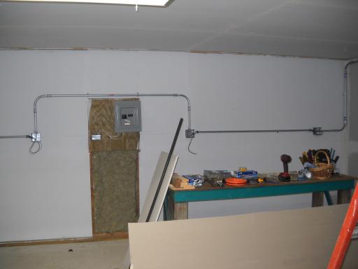

Conduit, boxes and wire run for outlets on the walls.
The up-and-over on the old breaker box is because it's my only source of power until the utility company hooks me up. Plus I'd have had to re-run a bunch of romex. Easier to just leave it.
I'll run it as a sub-panel off the new box once it's hooked up. Then I can pull the direct burial wire that feeds it now and put that last piece of drywall up.
Waiting on the LED shop lights to arrive, then I'll run the conduit, boxes and wire for them.
JimmyJazz
Aug 8, 2020
1,256
785
Pittsburgh, Pa
Why weren't the wires and and outlets installed in the wall as you had it opened up? It don't know much about this stuff and am not being critical of your efforts. Looks great.
PHPaul
Apr 2, 2015
1,120
1,206
Downeast Maine
www.eastovershoe.com
Jimmy, I did it that way because it's easier to modify if changes are needed down the road. Also, I don't have to worry about wiring in the wall being damaged when I hang shelves and such. Plus, it makes insulation much easier to do and more efficient as you don't have to work around wiring and boxes.
Houses are wired through the walls for aesthetics - most industrial wiring is done in conduit.
