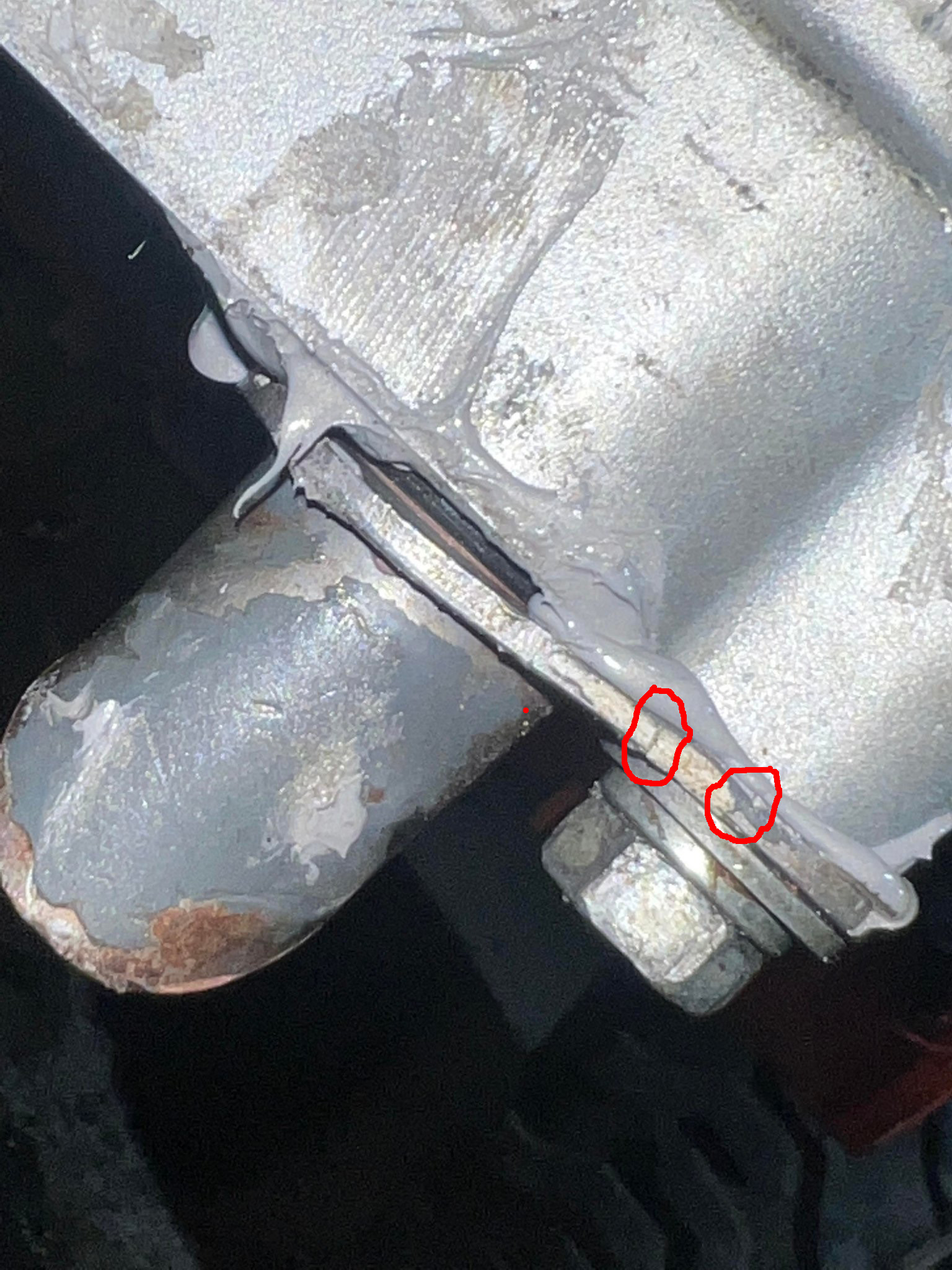

I'm looking at your picture, trying to figure out how this happened. I see two possibilities. First, it could have happened in the original accident. Second, it could have happened during reassembly after replacing the filter housing. The angle of the pipe and the return bend of the flange argue towards a failure of the pipe to fully seat, possibly due to the grey goo (gasket maker?) surrounding the pipe. I wonder if the apparent sealant prevented full engagement, and then torquing the bolt bent the flange.
Of course, it is equally possible that the flange was bent to that angle by the damage to the original housing. When installed in the new housing, the bent flange prevented the pipe from fully seating. Did you realize this was happening? Is that why sealant was applied?
Regardless of the cause, I am concerned about two possible cracks in the flange, circled in red, below:
I'm not certain they are cracks -- they could be some photographic artifact or perhaps some strings of sealant, but they do appear to be aligned with the bends. If they are cracks, they could be a point of future failure. I'm sure you are tired of giving Messicks money, but I think you should seriously consider replacing that pipe.
Personally, I'm not a fan of adding gasket makers or other sealants to o-ring sealed joints. I think it best to clean them well and apply a compatible lubricant to the O-ring (eg: a thin smear of the liquid to be sealed or perhaps some Parker Super-O Lube. Or even Vasoline). But: your tractor, your choice.
That situation certainly does look very "iffy" to me!

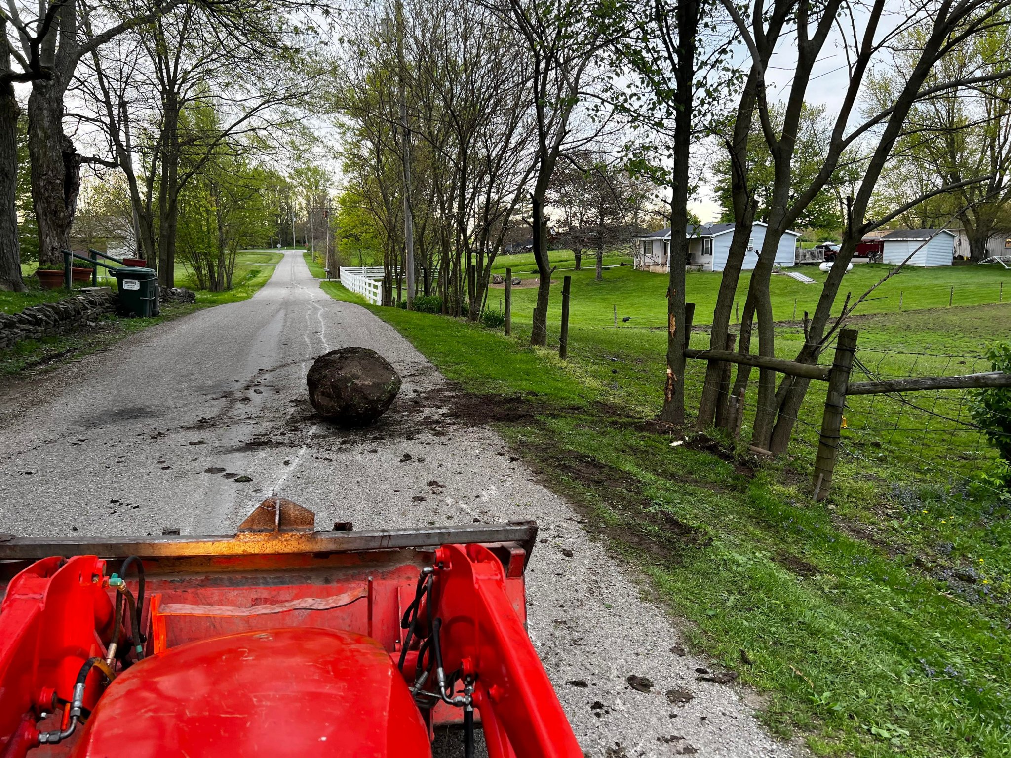

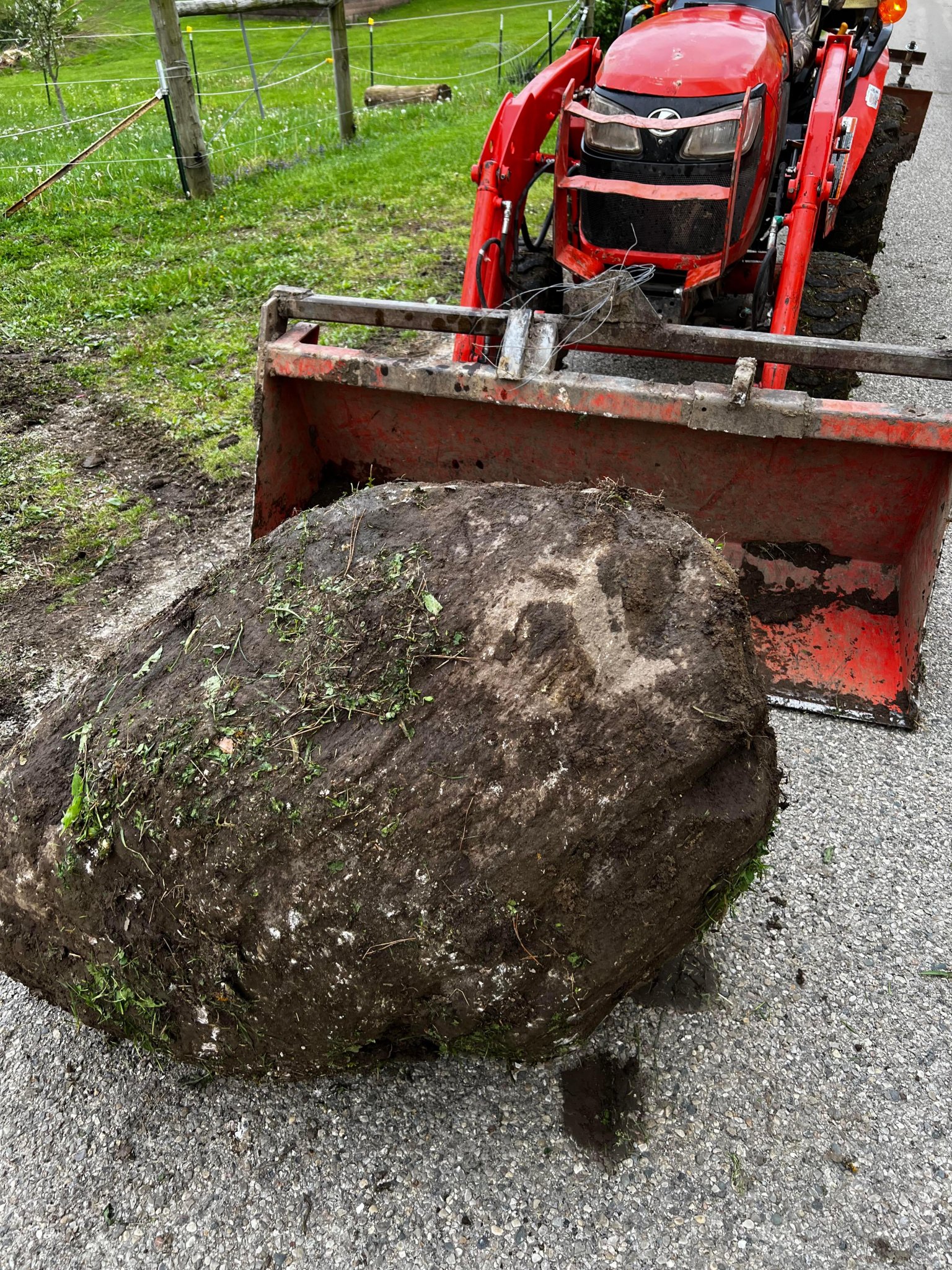

I was able to drill post holes yesterday. I was able to dig a huge rock out all in low. I was able to push that rock home in the low range. But sometimes the tractor will not move at all. You push the pedal and it has no resistance and does not move the tractor. One would think after it warmed up it would get better, but it doesn’t.
What now?
I was able to dig these rocks out of the ground and push and roll them to my house next door.
