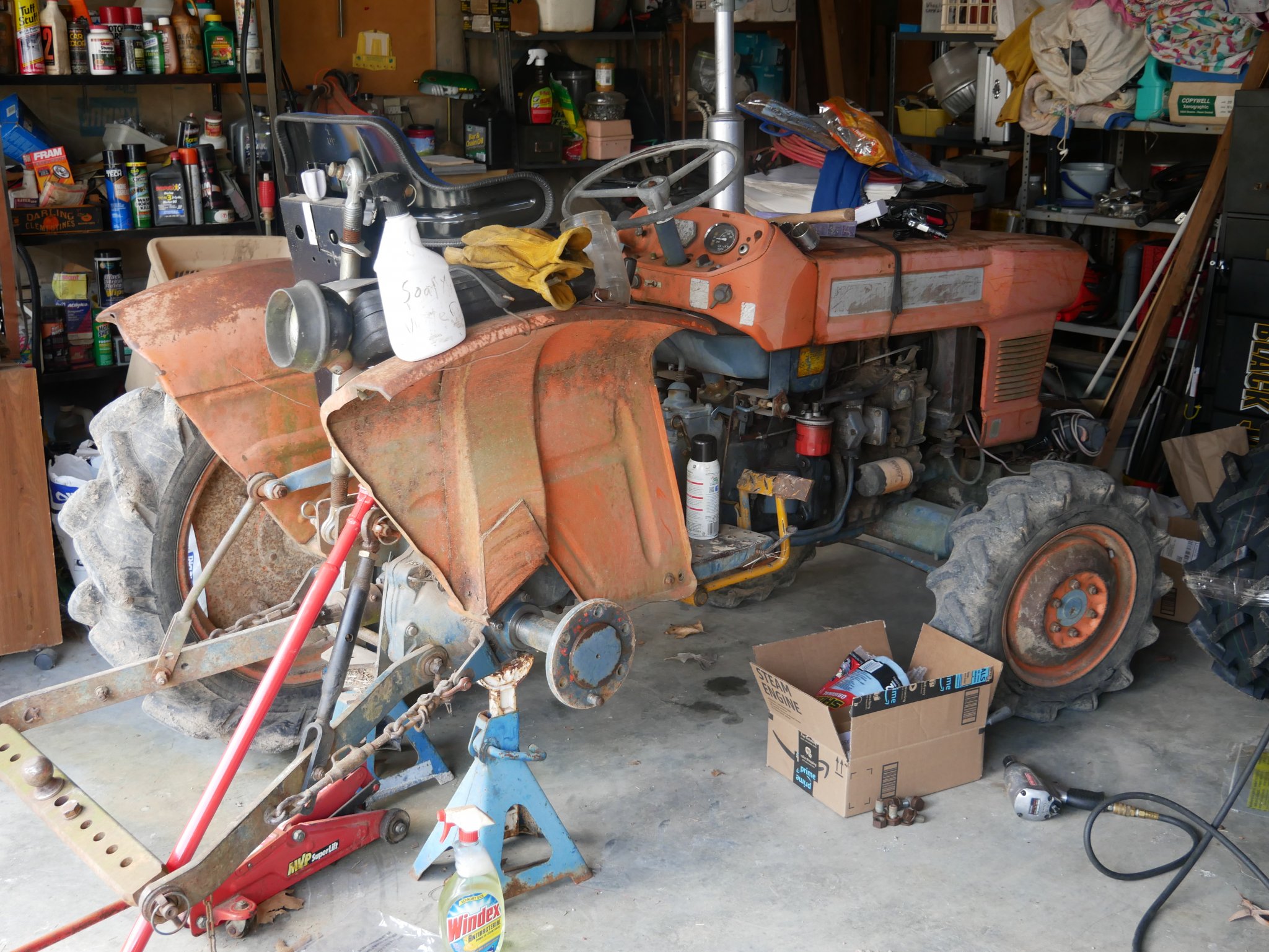

Hey Folks,
Well I have been sitting here going thru his archives of stuff and I found a few pics and prat numbers and suppliers for some tires, wheels, and exhaust for the L175.

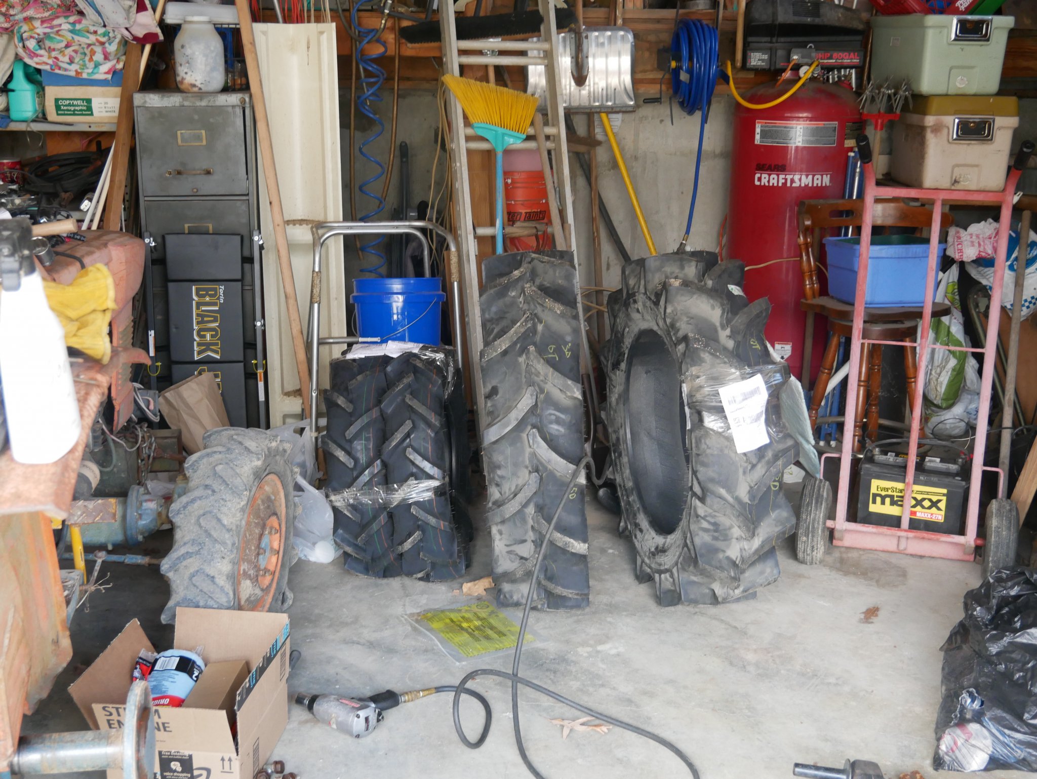

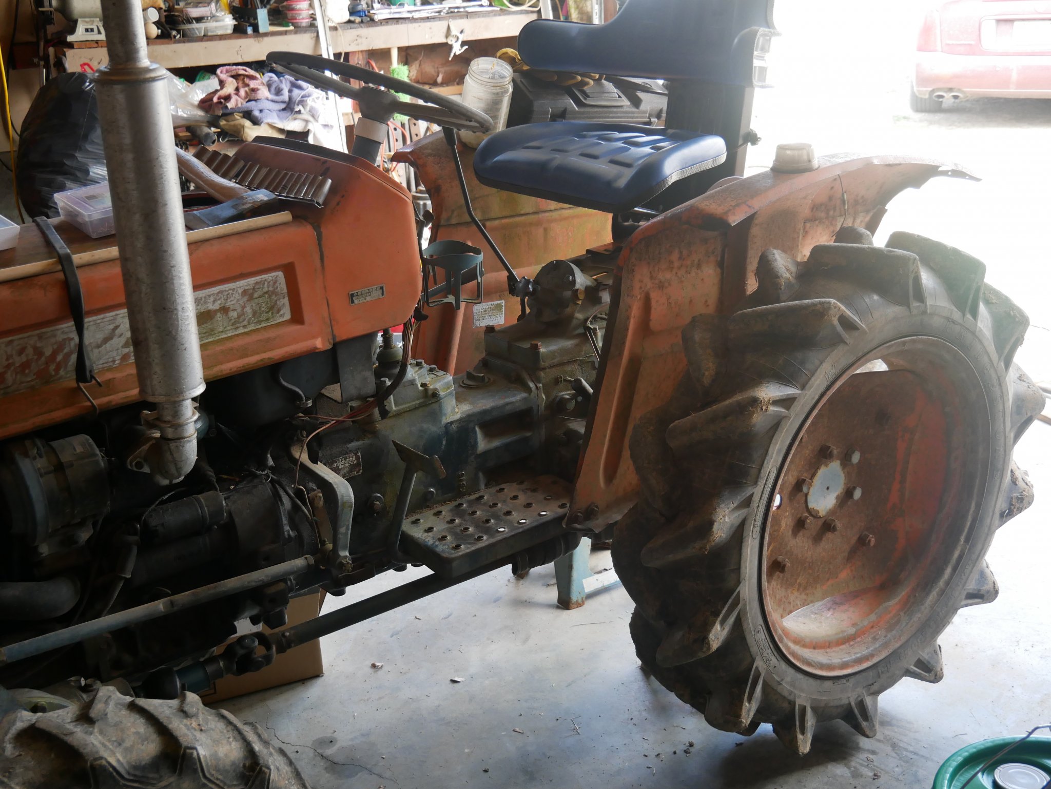

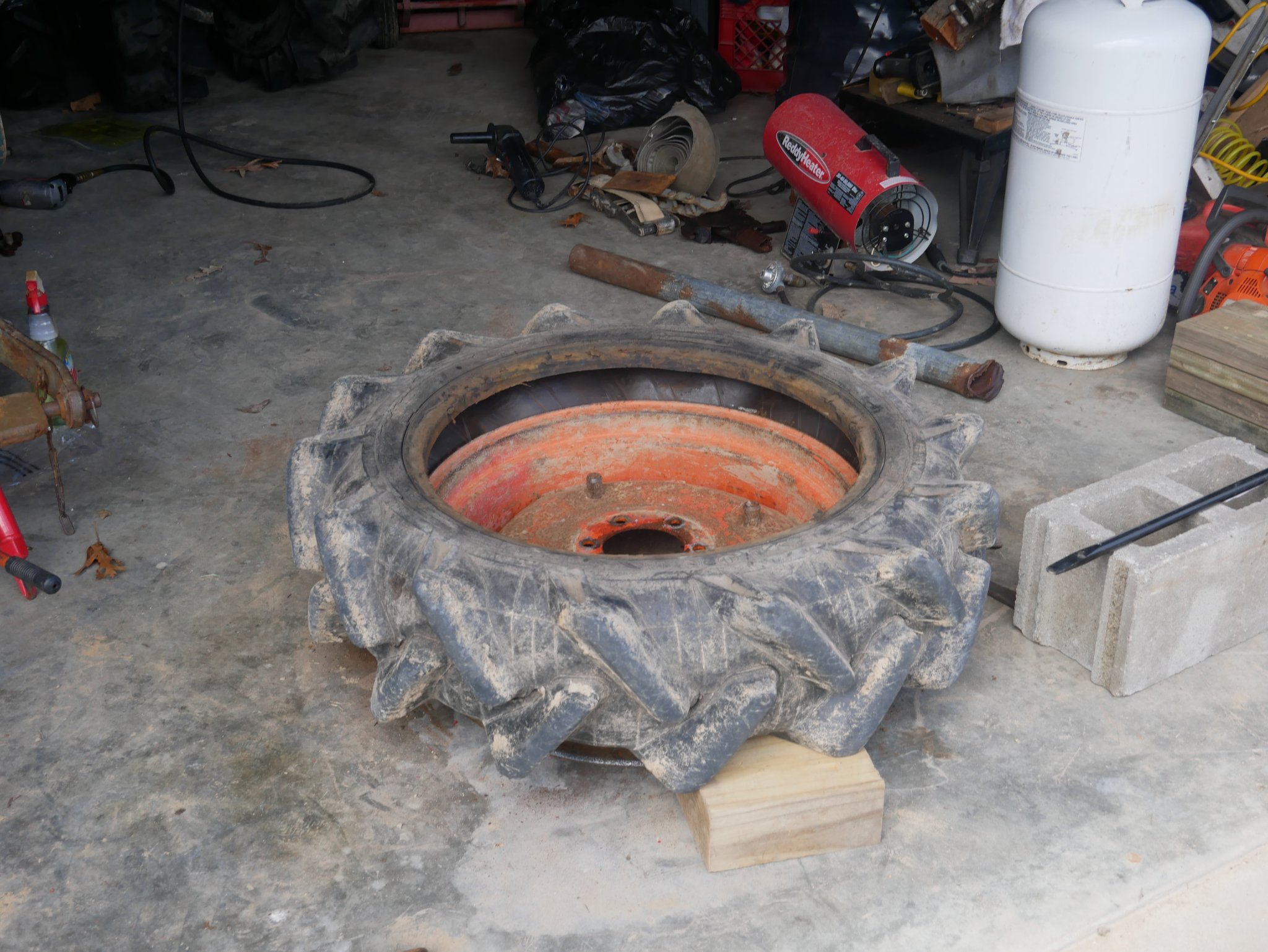

He put larger tires on it and had to have the rear wheels made I think.
Rear Wheel:
Part # 34159-27950
R-1 AG tire and wheel
Wheel P/N 34159-27950
Tire Size- 8.3/8-24
R-3 Turf tire and wheel
Wheel P/N 34159-27650
Tire Size 13.6-16

Hmmm, he put paint on things, but no pics, lol, I guess I will have to give a really nice bath when I start the pics of the PS upgrade, and show everything then, but ya'll get the idea.

Ahhh, now I remember, this was all to replace the Rice & Cane tires that it had when he bought it.

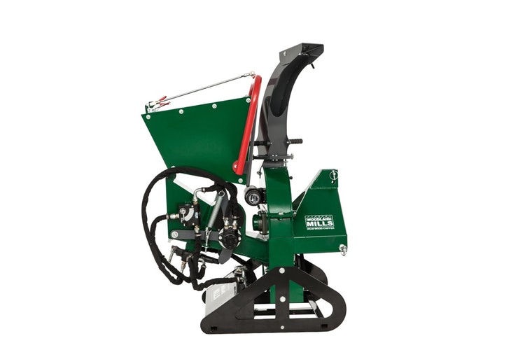

OK so while I am on a roll, and I will get rained out tomorrow anyway, sighs, here are more projects for your entertainment, (again the To-Do List).
Oh BTW we have already gone thru the 3pt hyd system, and stopped the drifting, and he turned up the pressure for a bit more lifting power.
So we just bought a new 3pt Tiller, no pics yet, still crated, (Kubota required), and this Chipper, still crated yes (Kubota requierd)....

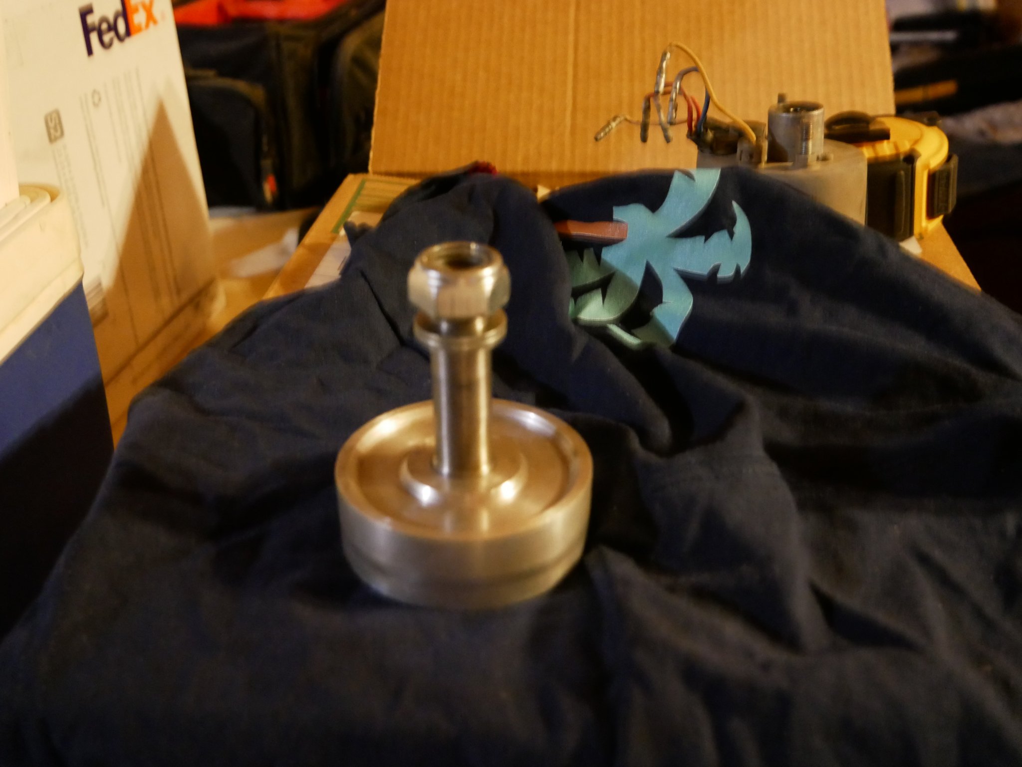

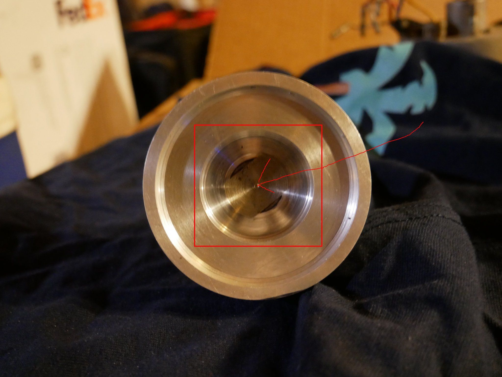

Well yesterday I tore all the new brackets, and PS pump off the front of the engine, and removed the new idler assembly we made, (it replaces the fan mount and fan pulley shaft and all), so I could recess the end of the bolt, (it was in the way of the new electric fan).
This morning both sides looked like this:
The arrow points to the "head" of the bolt/shaft, we reduced the thickness by half down to about 1/16", then we opened up the center, section in the box by 1/2", this hopefully will give me enough room to put the fan on the radiator and the little button, (spot on the fan where I believe there is a bearing) will have room inside that recessed area, before the very end of that head was in the way.
Now after we recessed the roller and shaved off the end of the bolt/shaft it looks like this:
I thought about using the original shaft/bolt, and fan mount and just replacing the pulley with the roller, but that would have made the fan run backwards, so this is why I am now using an electric fan.

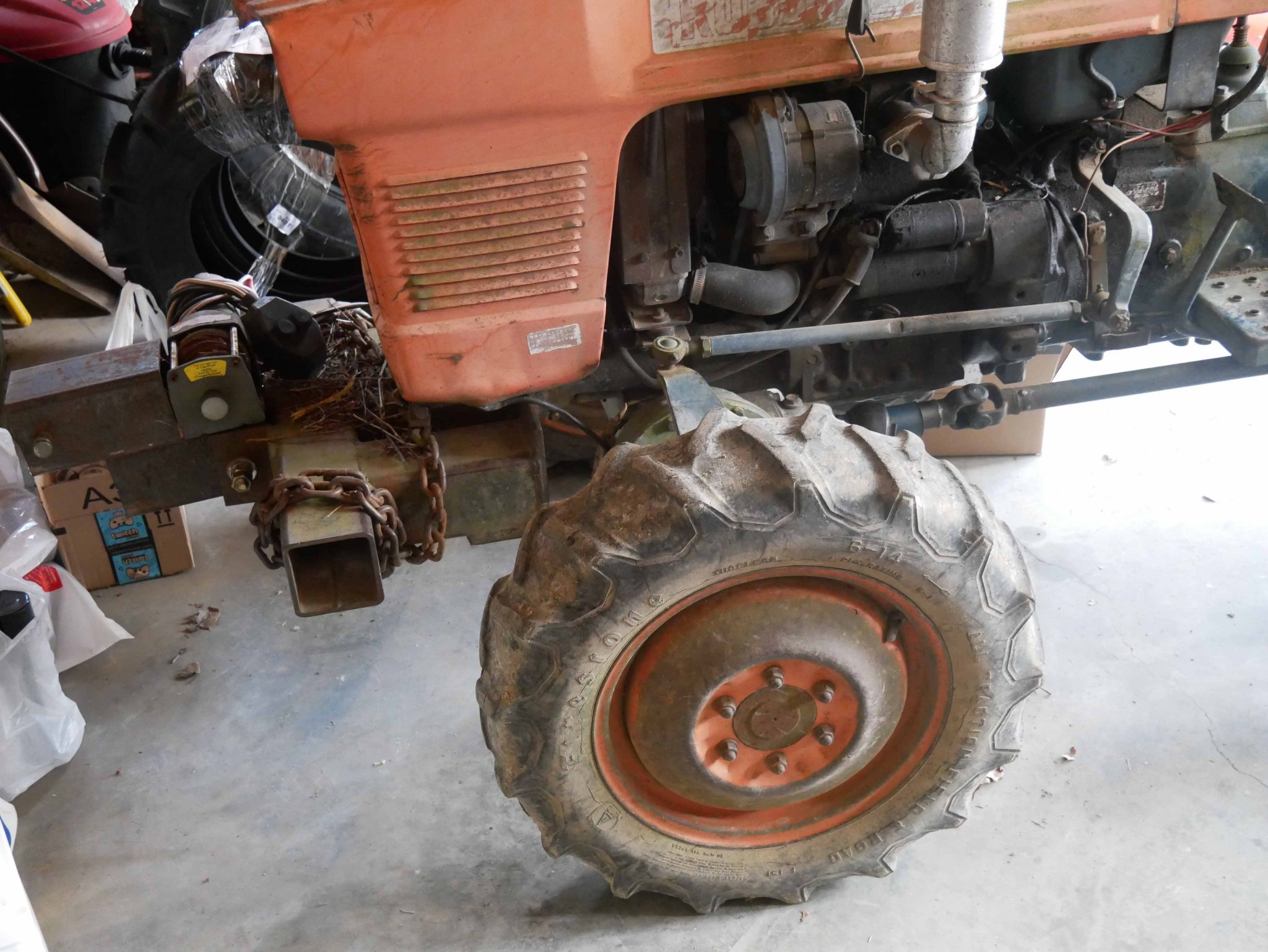

I'm trying to find where I can find tires for my Kubota 1500DT. The old ones are 6.00 14's (front). I tried Kennedy with no luck. Thank you, Chris.
Hey Chris,
Like I said I was giving information from notes left to me, but after thinking about it the front wheels are the ones he had made, and he did that so he could put the larger/wider tires on it.
I love the stance it has with the new tires, it doesn't look so skinny and unstable now.
It looks like The Wolf Man has ya covered though, :)
