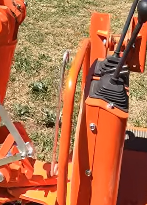

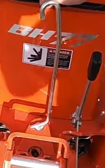

swing hook lock for use during transport. drops in a set of holes so the bh boom can't swing during transport. dropped in position to stop the swing.
View attachment 171034 View attachment 171035
here it is in its holder when operating the BH. at the bottom you can see the rnd hole it would be placed in when you want no swing during transport.
Don't be an idiot like me and "temporarily" store the swing lock pin in the BH pin hole when the BH has been swung to the side.
Then immediately forget and muscle-memory swing the boom back. POP. Sheared a chunk of the swung (top) pin hole clear off and into the snow beneath.
They're NOT made to keep the boom off to the side.
I can't use the swing lock pin anymore. May try having a welder reattach the chunk. May not, rarely trailer the machine anymore.

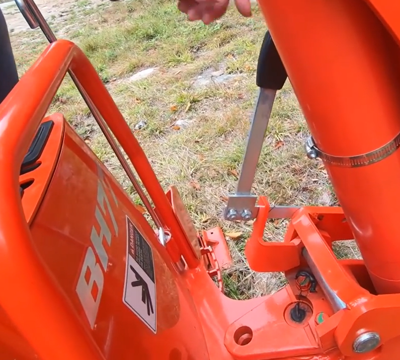

Thanks for the reply. That welded tube to the grab bar, holds the silver rod for Bh77 arm rotational stop while in transit. I'm going to use that welded tube holder for now , as a point to put a tall 3 ft. Pipe in. This so I can have a grab handle to pull myself up onto the BH77.
I'm 71, and just had left knee replaced 2x. Need all the help I can get. The Std. BH77 grab bar looks like a xxxx. I will latter fab one like it, as high as the seat top. Pic of the one one on my old Ford works well. Also adding Grated Steps to the Outrigger Arm Pistons from Specialty Repair Sales Canada. My old Ford had these built in already that covered the lower Hyd. hoses.

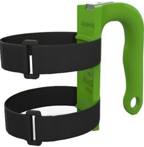

Thanks. Very nice gripper. No place to mount on a Cabbed B2650, or the BH77. Just had left knee replaced 2nd. time. Can't lift legs up too high any more, so just ordered this step for the pistons. Going to fab a taller pipe bar around the existing short BH77 joysticks bar to also grab onto.
My old Ford 1910 758B backhoe attachment has a very tall bar up over the stick controls to grab. And also came with a step at the base on the outrigger at pin on the feet. Perfect for me to still get up. Trying to duplicate this, with my Kubota replacement.
Pic of the add on step from Canada, if the file is not too large. Again, the one on my old Ford, was a pivot step,off the pin on the foot, so it was about 6 inches lower than this one.
