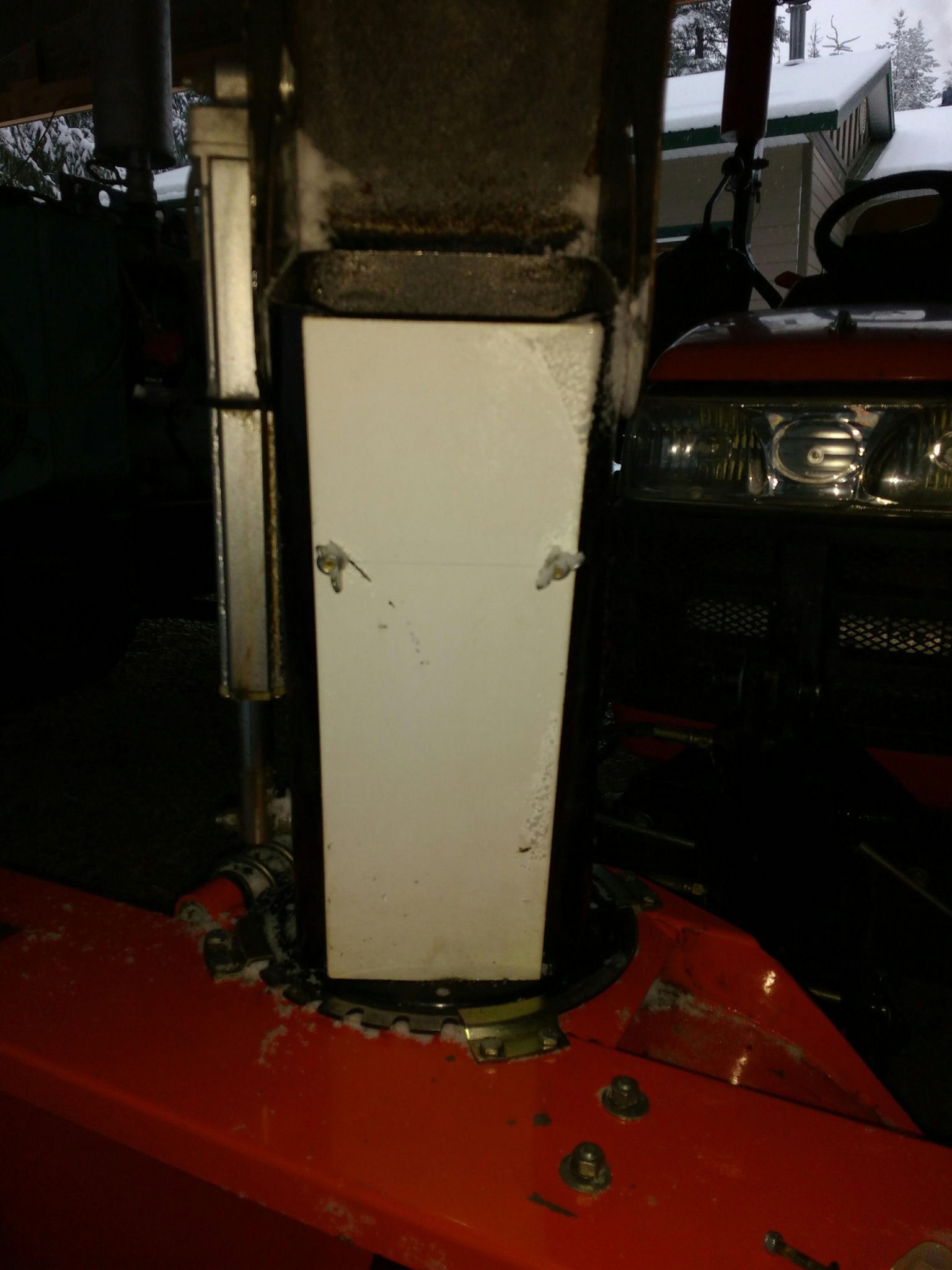

Chute guard was turfed as soon as I cleared my first blockage. However, I did replace it with and easily removable solid piece of heavy gauge tin, fastened with wingnuts for convenience. An enclosed chute doesn't allow airflow to spill out of the column, and gives you better blowing distance. snwblwrchute1.jpg

The “wingnut” man! Whatever works for you!

I am inclined to think that should it clog, you are going to have a difficult time removing that piece of tin in order to clear the clog. I have had my chute clog even though the bars were not on the chute, and it was very moist heavy snow, almost like a slushy. I attribute it to taking too much snow into the front of the snowblower and overwhelming the mechanics of the machine. Now if it is heavy wet snow, I use the highest speed that the augers will handle, and only take half bites of the snow. Takes a little longer to clear the driveway, but not as much time as it does to clear a clogged blower. Another thing that causes a clogged chute is breaking a shear pin and not realizing that it has broken.
