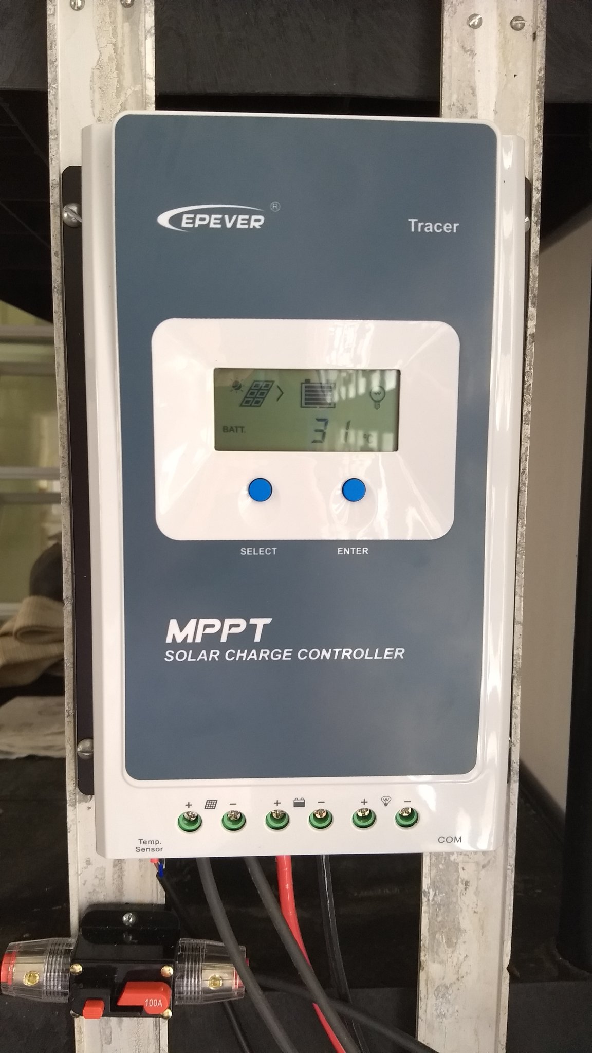

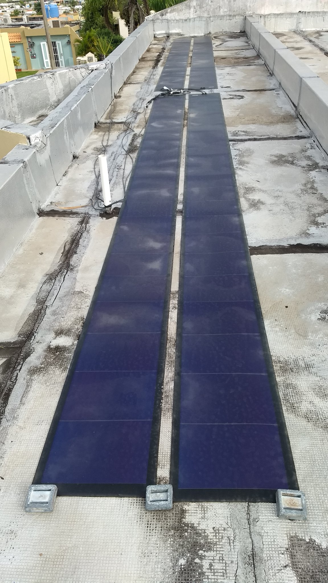

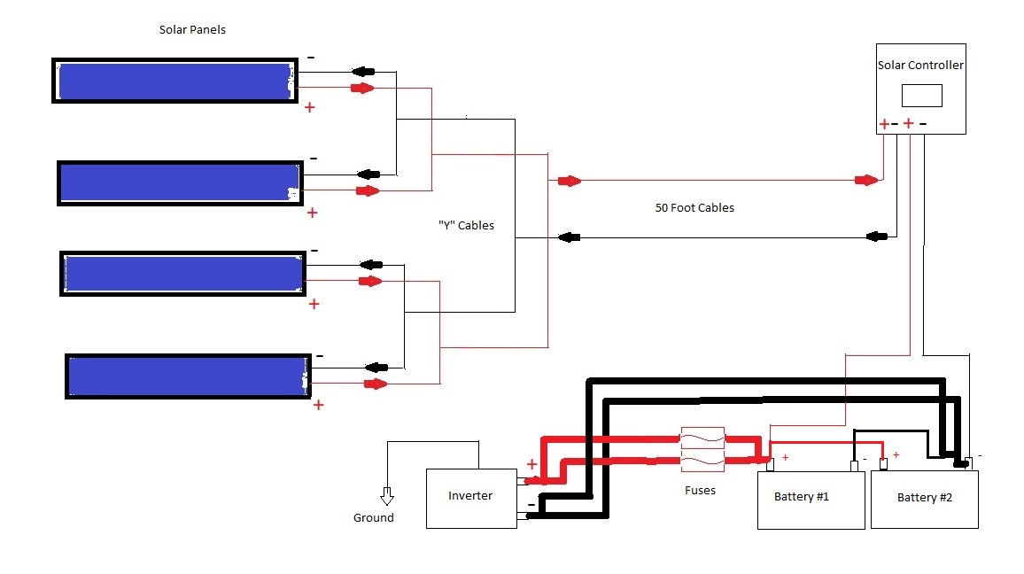

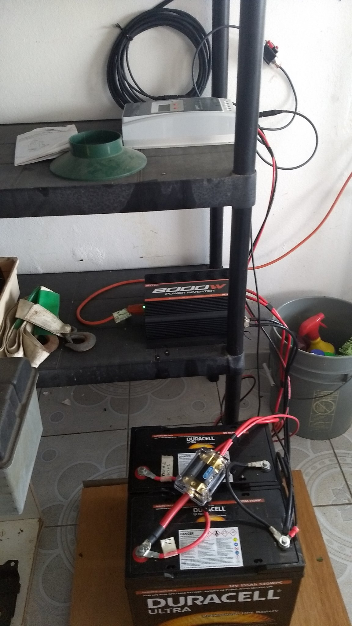

Just to give you an idea, I put this together in a hurry for my sister after hurricane Maria hit Puerto Rico in 2017 so that she could run her fridge, charge phones and have a few LED lights. I did not know anything about solar power so I watched a bunch of Youtube videos and read anything useful about the topic from the internet. She was without power for over a year.
I could get everything but the batteries in the main land. The 4 panels were 136 watts each and measure 216 in. long X 1.5 in. wide.
They were originally intended to be installed (bonded) on metal roofs but they were shipped rolled up and that made it perfect for direct shipping to PR. The AGM batteries were obtained from a Batteries plus store in PR, luckily, since it was next to impossible to source things locally after the hurricane.
The Epever MPPT (Maximum Power Point Tracking) Charge controller and the 2000 Watt inverter were delivered to me so that I could prewired them before shipping (kind of like a kit with instructions). Then my nephew in PR could connect the panels and the batteries. It worked right off the bat! The whole thing was a little over $2000.
I could get everything but the batteries in the main land. The 4 panels were 136 watts each and measure 216 in. long X 1.5 in. wide. View attachment 165413 They were originally intended to be installed (bonded) on metal roofs but they were shipped rolled up and that made it perfect for direct shipping to PR. The AGM batteries were obtained from a Batteries plus store in PR, luckily, since it was next to impossible to source things locally after the hurricane. View attachment 165415 View attachment 165414 The Epever MPPT (Maximum Power Point Tracking) Charge controller and the 2000 Watt inverter were delivered to me so that I could prewired them before shipping (kind of like a kit with instructions). Then my nephew in PR could connect the panels and the batteries. It worked right off the bat! The whole thing was a little over $2000. View attachment 165417

Controller
Inverter
Batteries These days you might be able to get a longer life Lithium-Iron Phosphate (LiFePo4) battery than these.
On top of that you are going to need a fuse between the battery and the inverter similar to this. A breaker/switch to connect/disconnect the solar panels. Y cables to connect the solar panels in parallel. Extension cables to reach between the solar panels and the controller. Plus you might need some miscellaneous cables and hardware that you will see that you need as you go.
