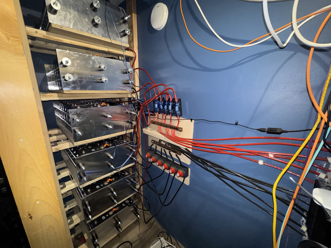

Lifepo4 cells are the way to go at this point for battery. They're dirt cheap and last a really long time.

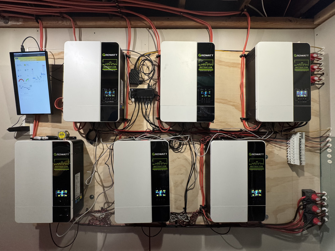

My whole house is off grid solar, with a 11kw array, 18kw of inverter power, and 90kwh of battery. I took advantage of the 30% tax credit last year, and I'll do the same again this year. I built everything myself.
I just bought another 90kwh of battery because the tax credit ends this year. I don't support the tax credit, but I'll sure use it while it exists.
My utility cart is also electric. I charge it up and run for days, no mess with gas engine, oil changes, or anything else that can go wrong. It's a 1998 club carryall and runs like new after i converted it to lifepo4 battery.
I have a boiler for heat and hot water, but I just bought a heat pump hot water heater and heat pump heater (also 30% rebate) so my heat and hot water will be electric.
All these electric things are virtually maintenance free and last quite long. There is a learning curve, and there are a ton of companies trying to take advantage of people. However, if you can do it or know someone that can help, you can save thousands over the long run.
And if you're like me, power outages are frequent. At least 1-2 times a month, for hours or sometimes days on end.
And I still have a grid connection, but only use it if we have mulitple cloudy days to top off the batteries.

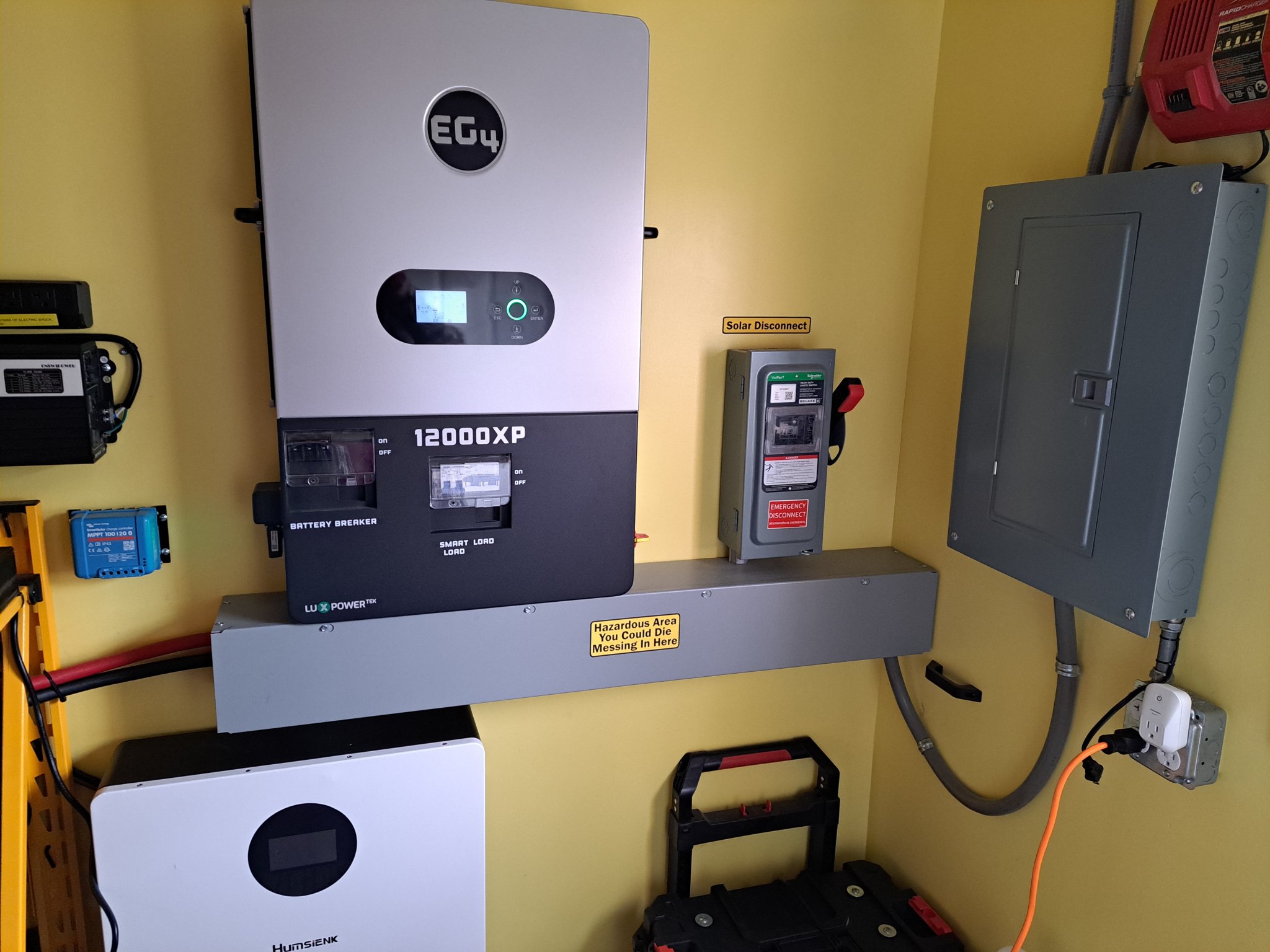

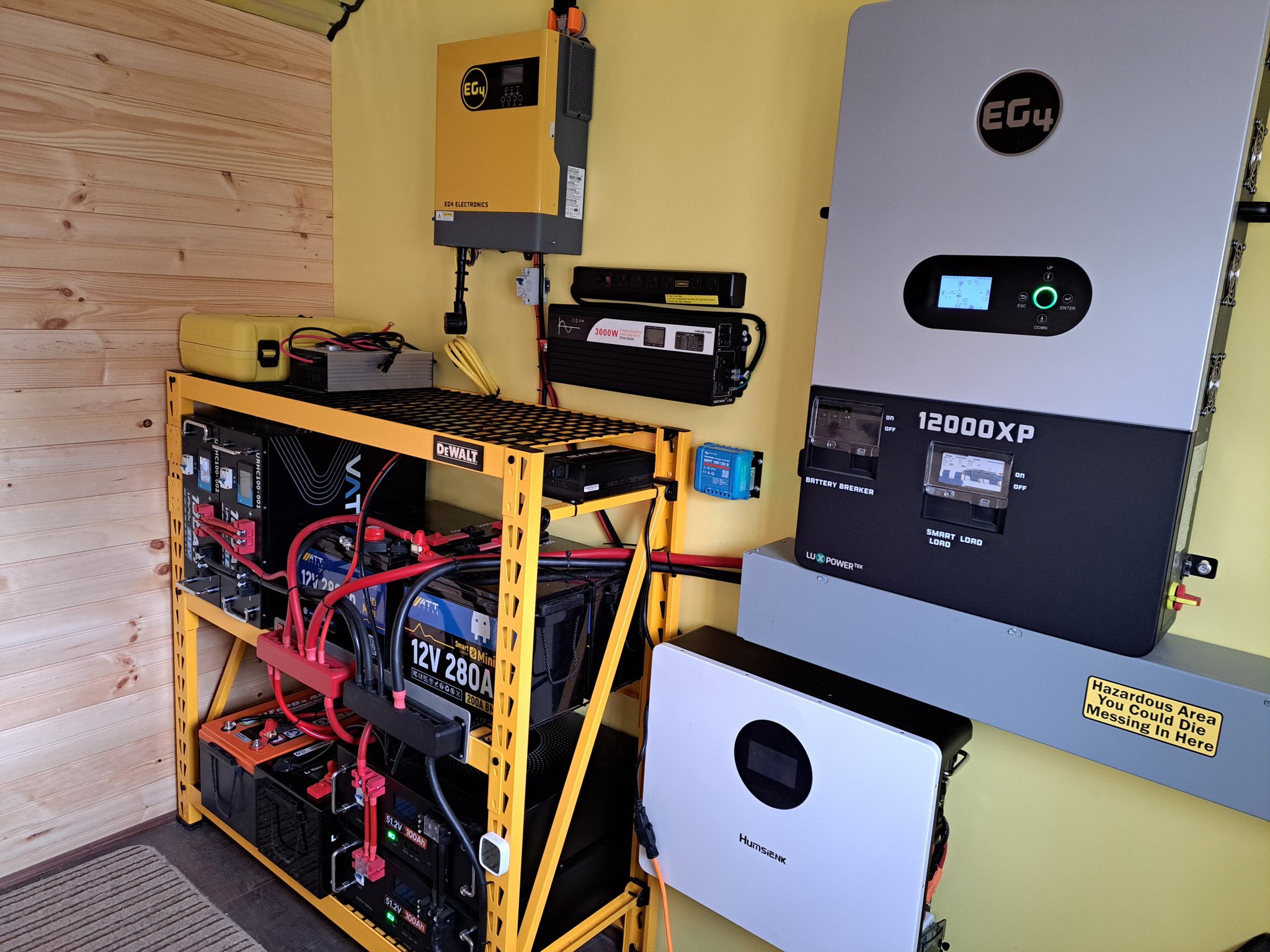

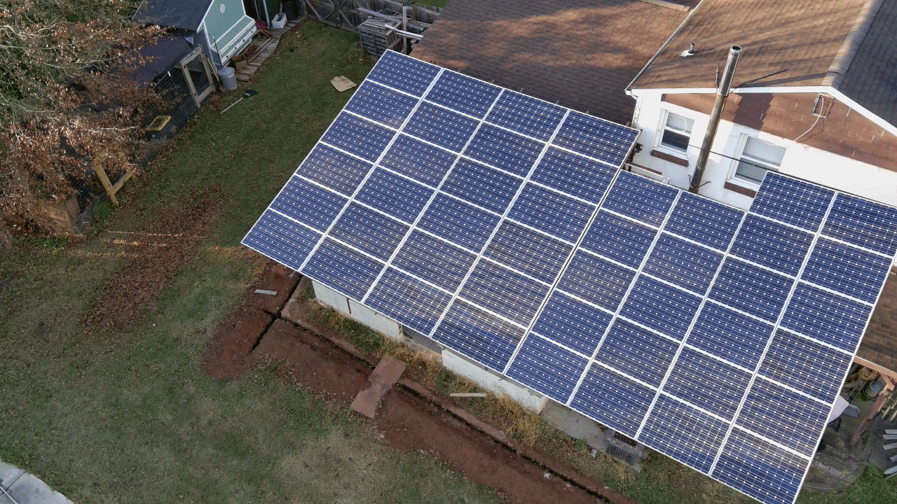

I took a couple pics in my solar backup power shed.
