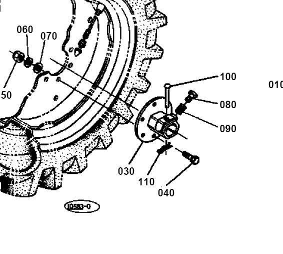

I think what both lsmurphy and I are saying is that you've either lost or broke the pin not the bolt, There are supposed to be both.
bolt tightens hub but the pin keeps it from moving side to side.
100 is the pin and 110 is the hair pin that holds the pin
80 is the bolt and on some there is also a nut too.

There is a locating pin that you are missing (if it were there, the hub couldn't walk on the axle), and then there is the large bolt that clamps the hub to the axle. You will need to loosen that large bolt, and the hub/wheel will then slide where you want it. You will see numerous holes in the axle- you need to get two hardened pins (soft steel pins will just bend), put the hubs where you want them in conjuction with the holes in the hub and axle lining up, put the pin in and tighten the bolt. Alot- it takes a good bit of torque to keep the hub stationary. It would be even better if you upgrade to new hubs that are better designed, but they are pricey-
