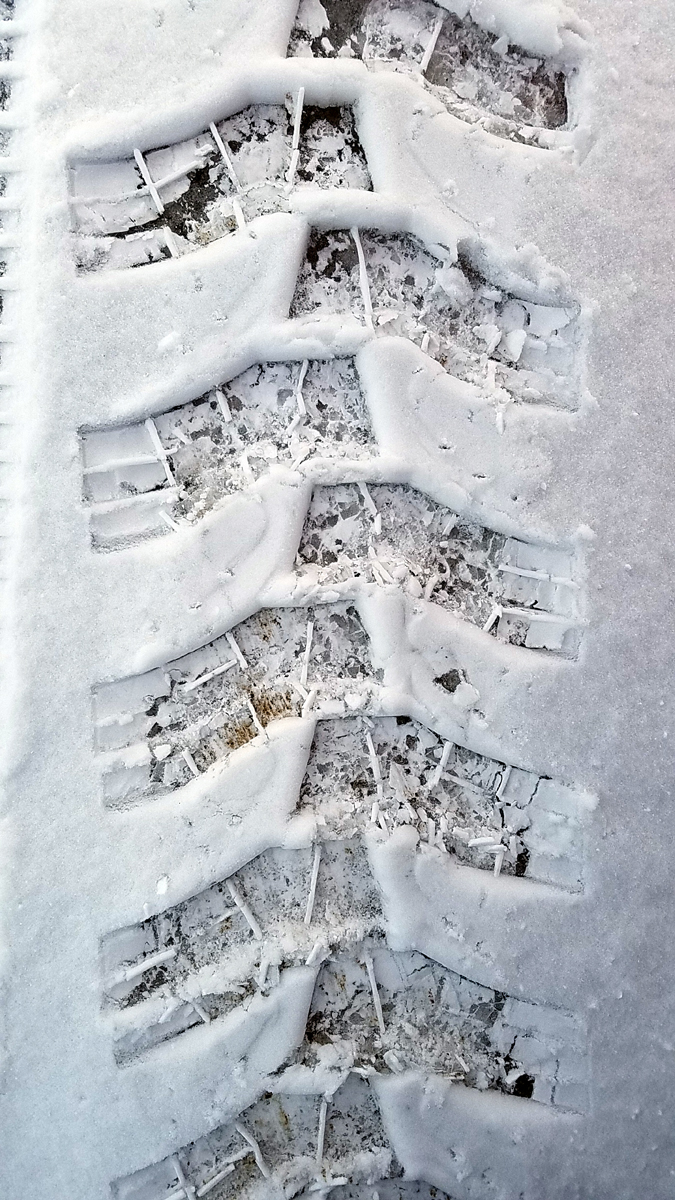

I ran the snow blower this morning, only an inch or so of snow, but I did jump out and take the obligatory tread pattern photo. :ROFLMAO: This was after backing up and pulling forward so not as clean a pattern as it could be.

I am not sure what can be felt by the operator in terms of traction, but in those picks it is clear that there is some compression of the snow which would create some amount of additional friction (traction). 👍 So I think you improved it…I would also offer based on your slip and slide story, if not wanting to cork your boots, Katoolas are a simple solution (easy on/off) traction aid.

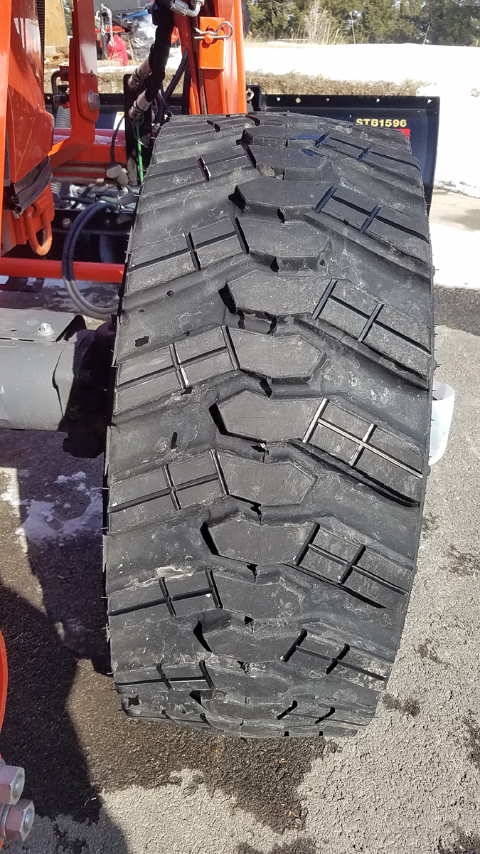

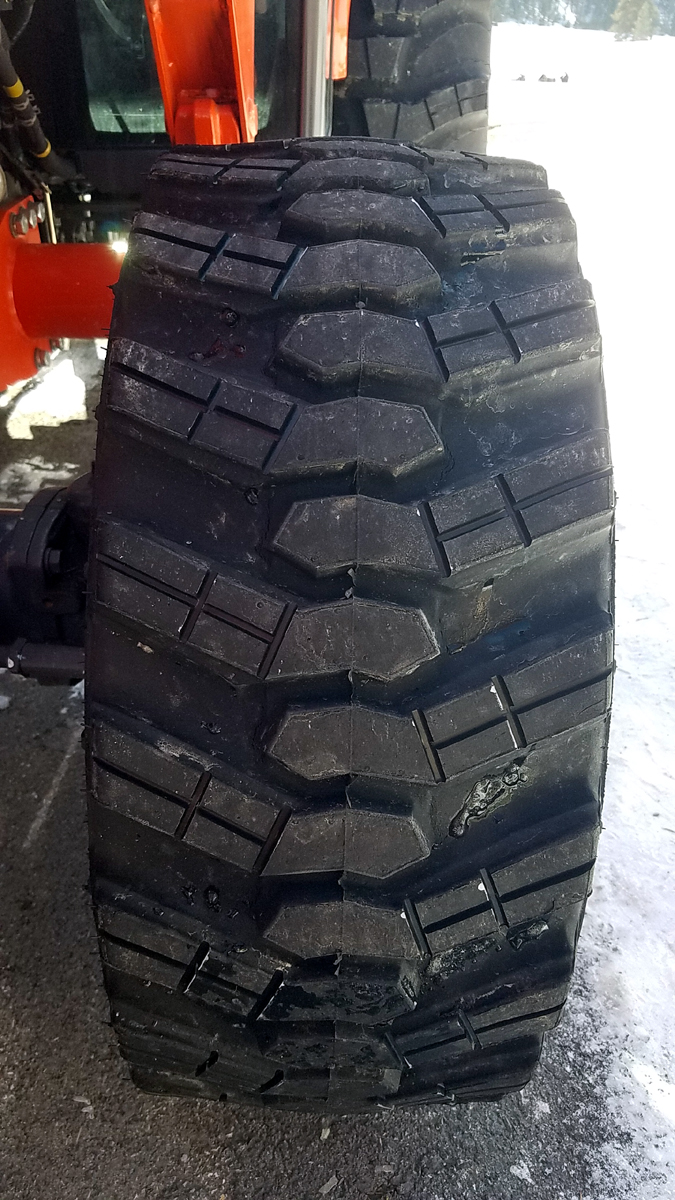

I finished the front tires yesterday afternoon and then moved a bunch of snow that had drifted all over the driveways.

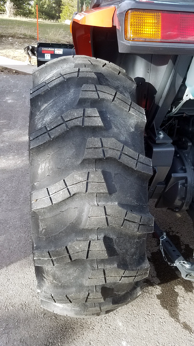

Here are the front tires. I might do a little more to the rear tires when I get back from a work trip in a week or so.

Edges give traction in snow. Snow also packs in the grooves giving snow to snow grip like a snow ball. My grooves are a little deeper and pick up gravel to give a few “studs”.

Well, it's time for someone to tell me "step away from the groover!" :ROFLMAO: Yesterday I decided to do a little more grooving and now I'm done with the R4 tires on the MX. If no one wants to use I'll send it back to @pokey1416 with some Montana honey and a few Andrew Jacksons!

@pokey1416 has been incredibly generous and I'll be sending him something even if the groover heads in a different direction. By the way, I'm still using the same blade I started with and I've made a lot of cuts.

Definitely like the grooved R4 over the R14. Need a tuff tire on TLBs. My traction improvement was on lawn, pasture, and mud on our hillside farm. Not the plow pulling traction of R1s. Like the R4 tuffness, 10ply on M59 front with extra tall lugs, and flotation on fields, orchards, and woods.
R1 tires wore quickly with heavy FEL work. I have used chainsaw carving wheel on the side grinder. Mud boggers use chainsaws to block their tires.
