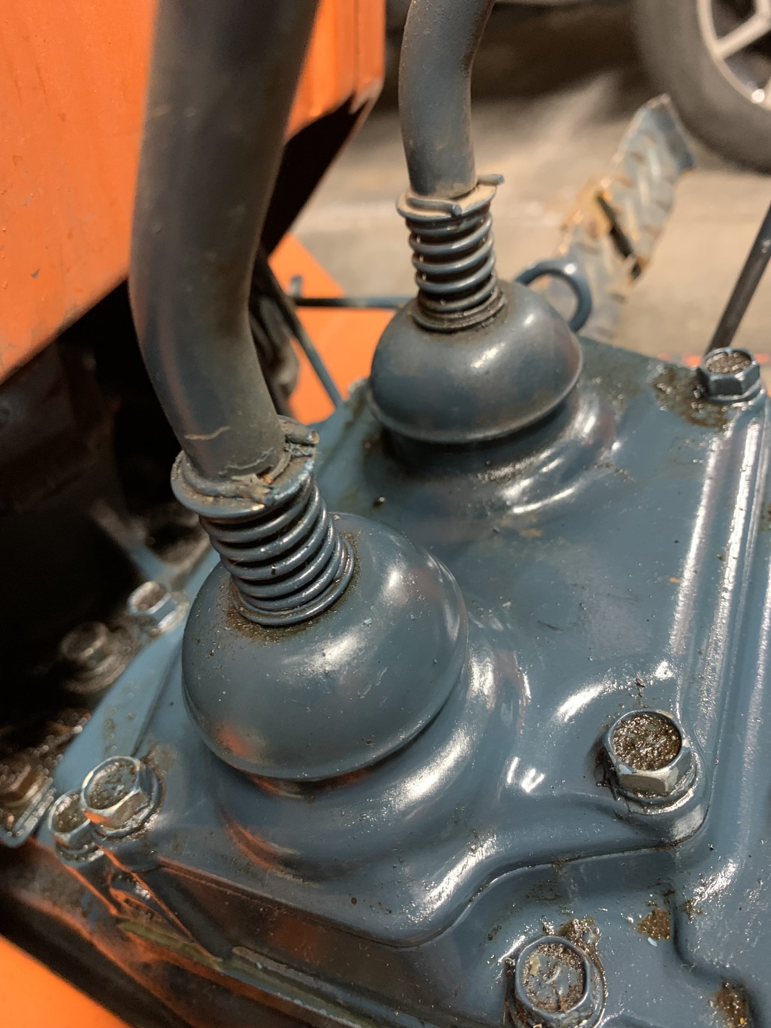

Shifter levers leaking hydraulic fluid from the boots where they enter the transmission.
mstracka
Kubota L2202DT, 60 inch wide Meteor snowblower
Mar 30, 2022
Hayward, Wisconsin
Tractor is an L2202 DT (grey market, approx. 1960-1970 vintage). 3 cyl. diesel. Question is: Can the cover that the shifter levers go through be removed safely such that the seals can be replaced? Is this a relatively easy repair and reassembly?

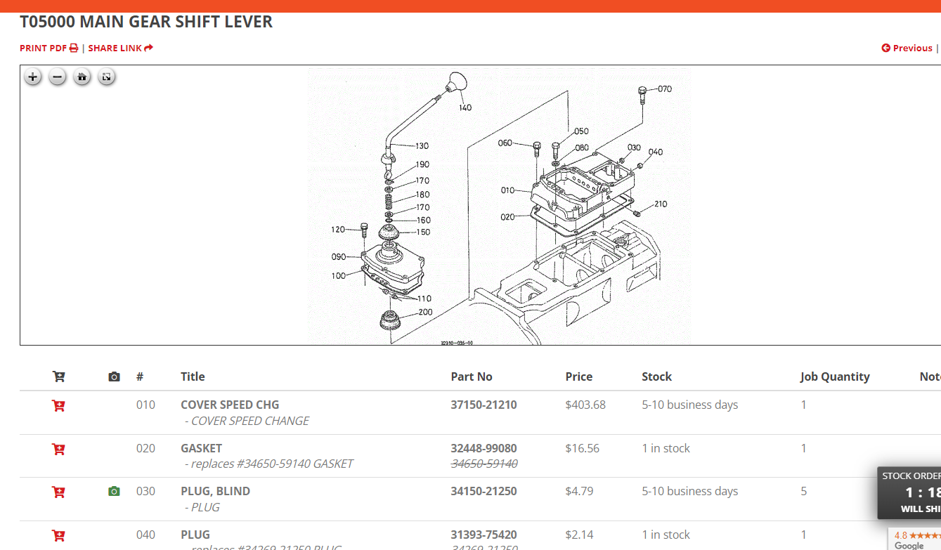

Make sure the gear case housing vent is not obstructed. As far as the boot/seal they are replaceable, finding the correct part # will be the larger chore.
This is off a l2350dt for close reference

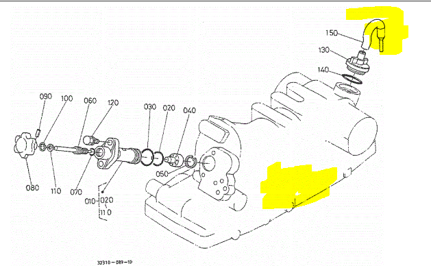

Generally, it is located with a rubber candy cane in one of these two spots under the seat.
Dirt daubers like to clog the tube. Usually I take them off roll them in between your fingers to break up the blockage, and blow a little compressed air in them.
