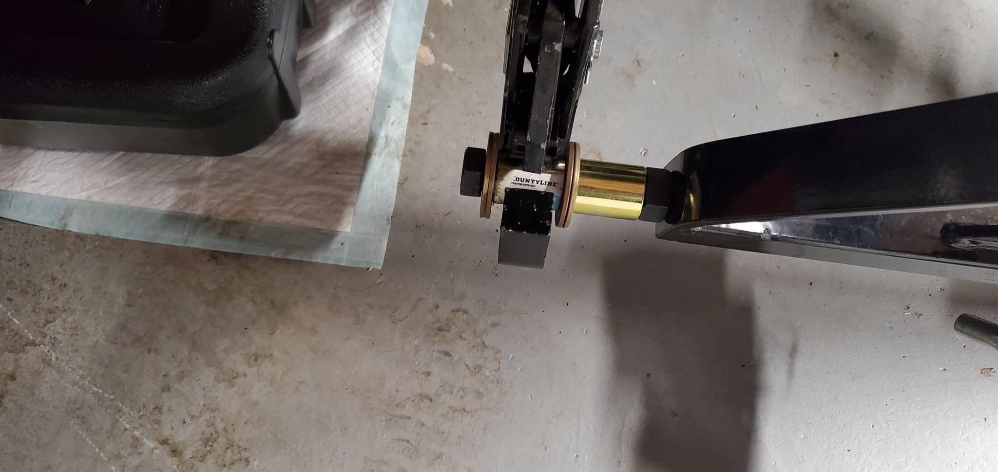

I bought a bunch of new metric sockets to do my 50hr service. I only had up to 19mm, now i have full set up to 35mm i think. I had sockets up to 1 1/8" - for hitch ball nuts. Better to have and not need than need and not have.
Here's a closeup view of the setup. 22mm bolt, nut , washers and 2 sets of bushings. The washers keep the hitch from sliding sideways and bushings fit the quick hitch.
Thanks!
