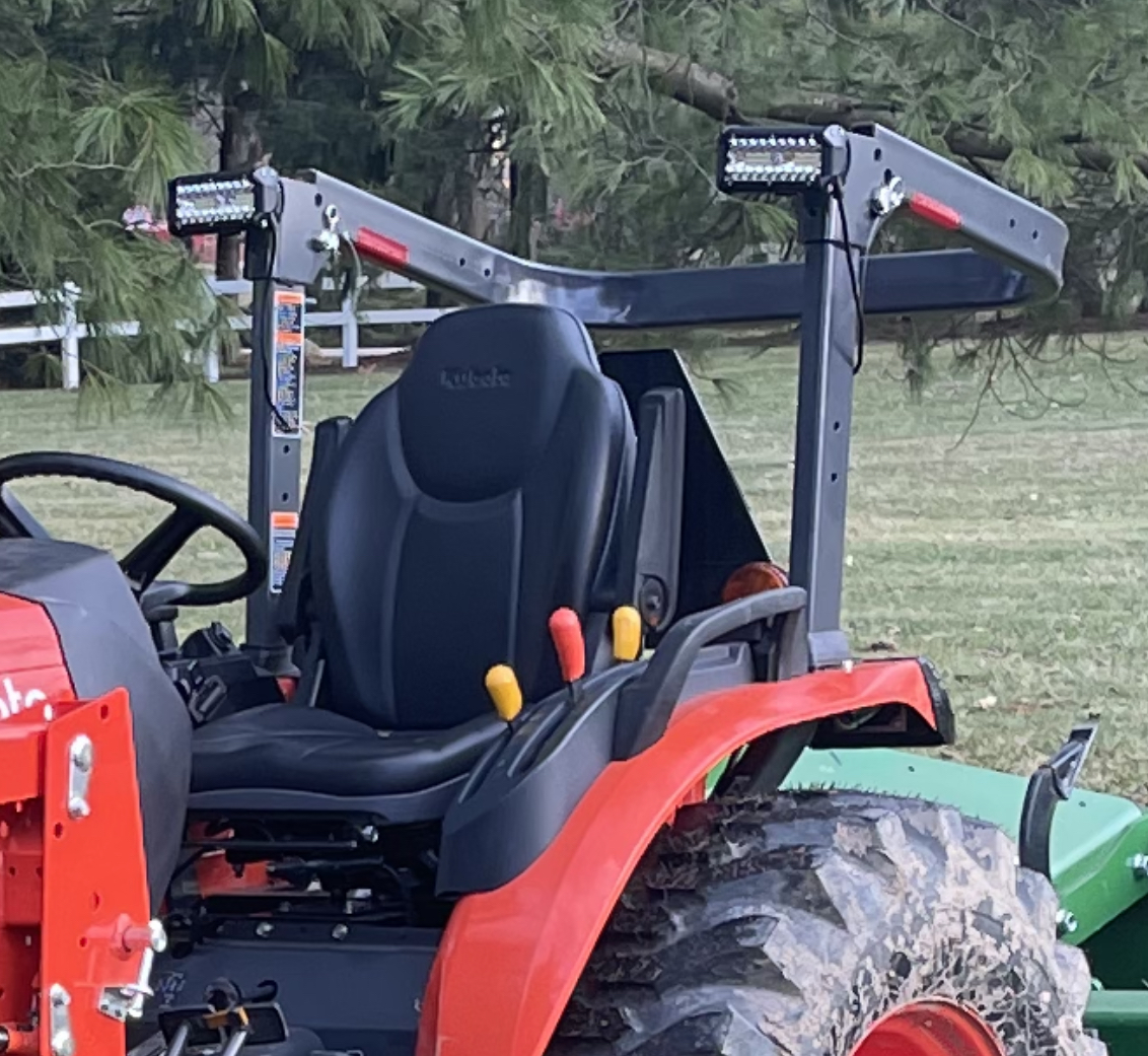

I used the holes already in the ROPS along with rubber washers so not to scrape and dig into paint.. plus helps keep them securely in place. The rears are mounted with the same bolt as front lights, and are switched separately. The main switch is under the seat. Nuttin fancy but works!

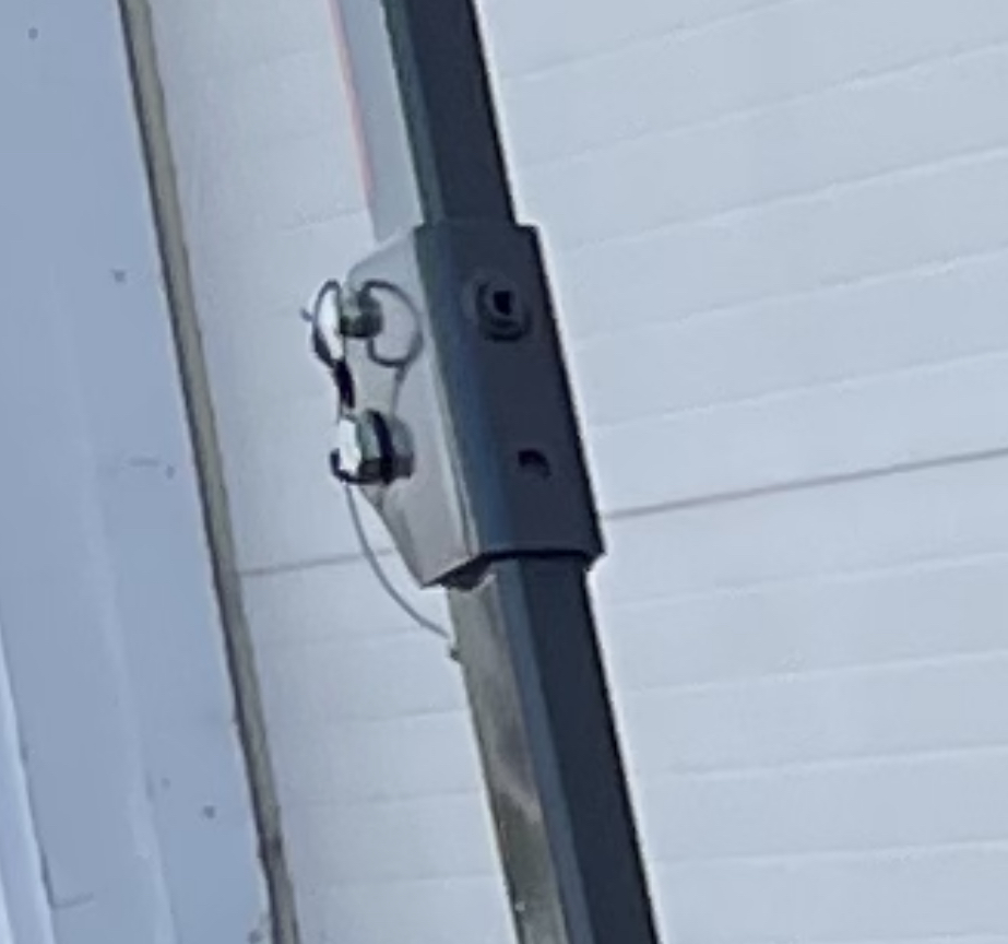

Where my ROPs fold there is a bracket with a welded nut. I modified the bracket that came with my LEDs to accept a bolt that threads into that nut. Then just added a jam nut to hold aim. Simple, sturdy and cheap.

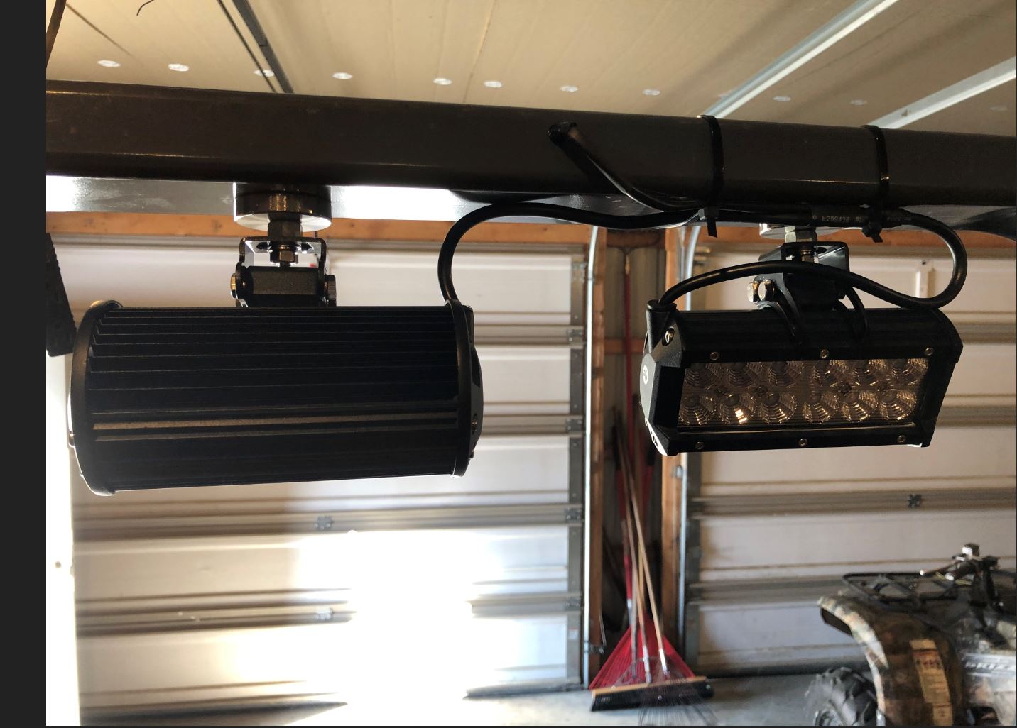

Ok. here is what I used:
Magnets: https://www.amazon.com/gp/product/B07JKWCVTX/ref=ppx_yo_dt_b_asin_title_o00_s00?ie=UTF8&psc=1
Lights/wiring harness:
hope that helps. If you use the same magnets, cut the mounting stud down so you don't need to use any spacers. It will help prevent the lights from vibrating/movement.

Nope. I didn't. They really don't move at all. You can force them to move/spin but they really aren't going anywhere easily. Don't get your finger between the magnet and ROPS.
I did have to replace the light brackets once. As you can see in my pic above, I used a nut (as a spacer) between the magnet and the light bracket because magnet stud was too long. The light brackets fatigued/cracked when running the three point stump grinder for three days. The vibration from the grinder was just too much for the light brackets not sitting flush against the magnet base.
The fix was to cut down the studs on the magnet and eliminate the nut "spacer". Now the light brackets sits flush against the magnet base. If you do the same, thread the nut on the stud all the way down to the magnet before cutting off excess stud. The nut will "chase" the threads for you when you back it off. (only added for clarity, some folks have never heard of that before).

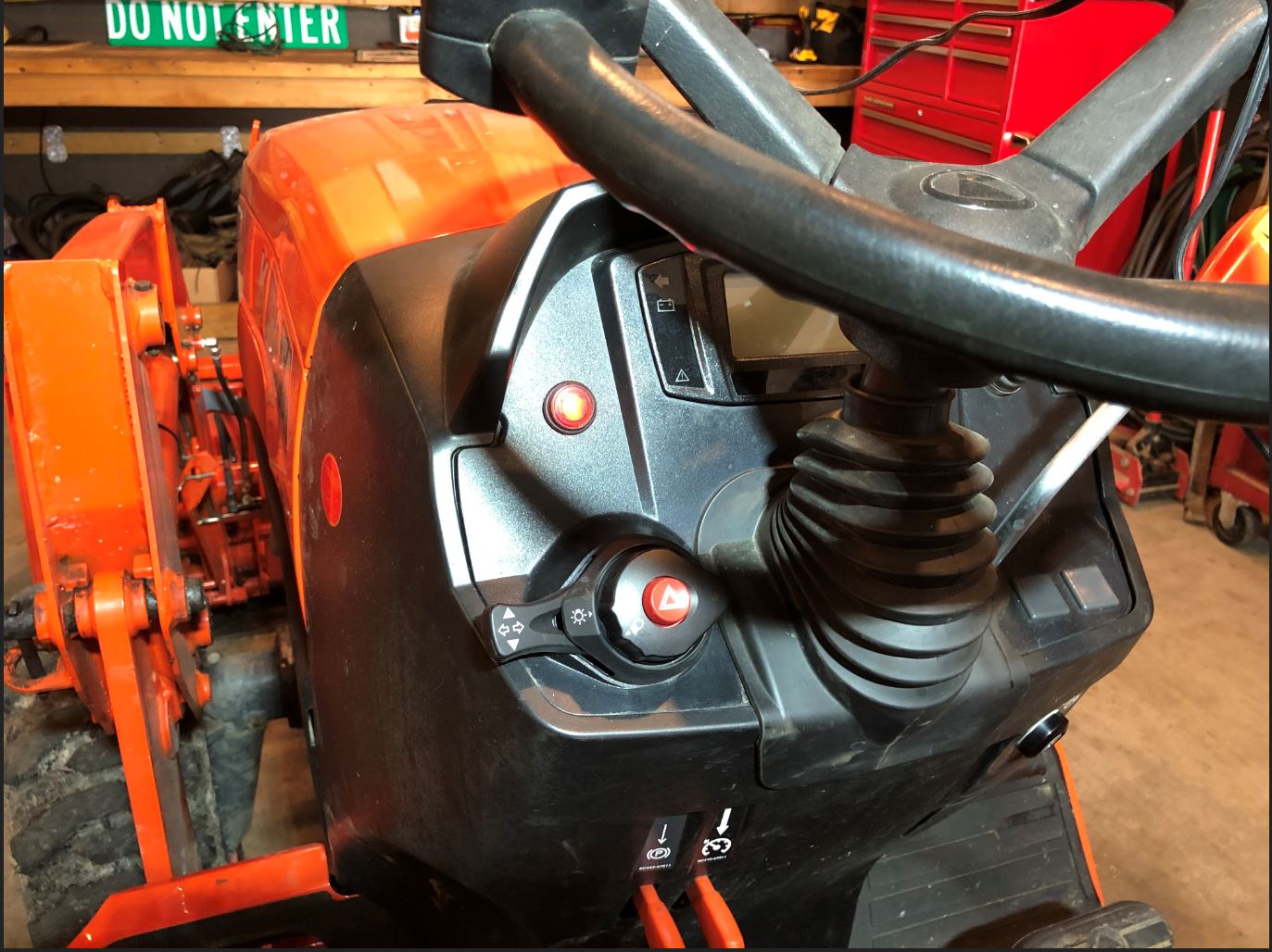

I did purchase some additional wire in order to wire it they way I wanted. Its connected to the battery using the wiring harness and relay, with the switch mounted on the dash. Ran the wires along the chassis and up thru the bottom of the ROPS and out the factory hole in the top of the ROPS. It was pretty easy to do.
Wiring it that way, I can turn the lights on with ignition off. The switch included in the kit will glow bright red when the lights are on.

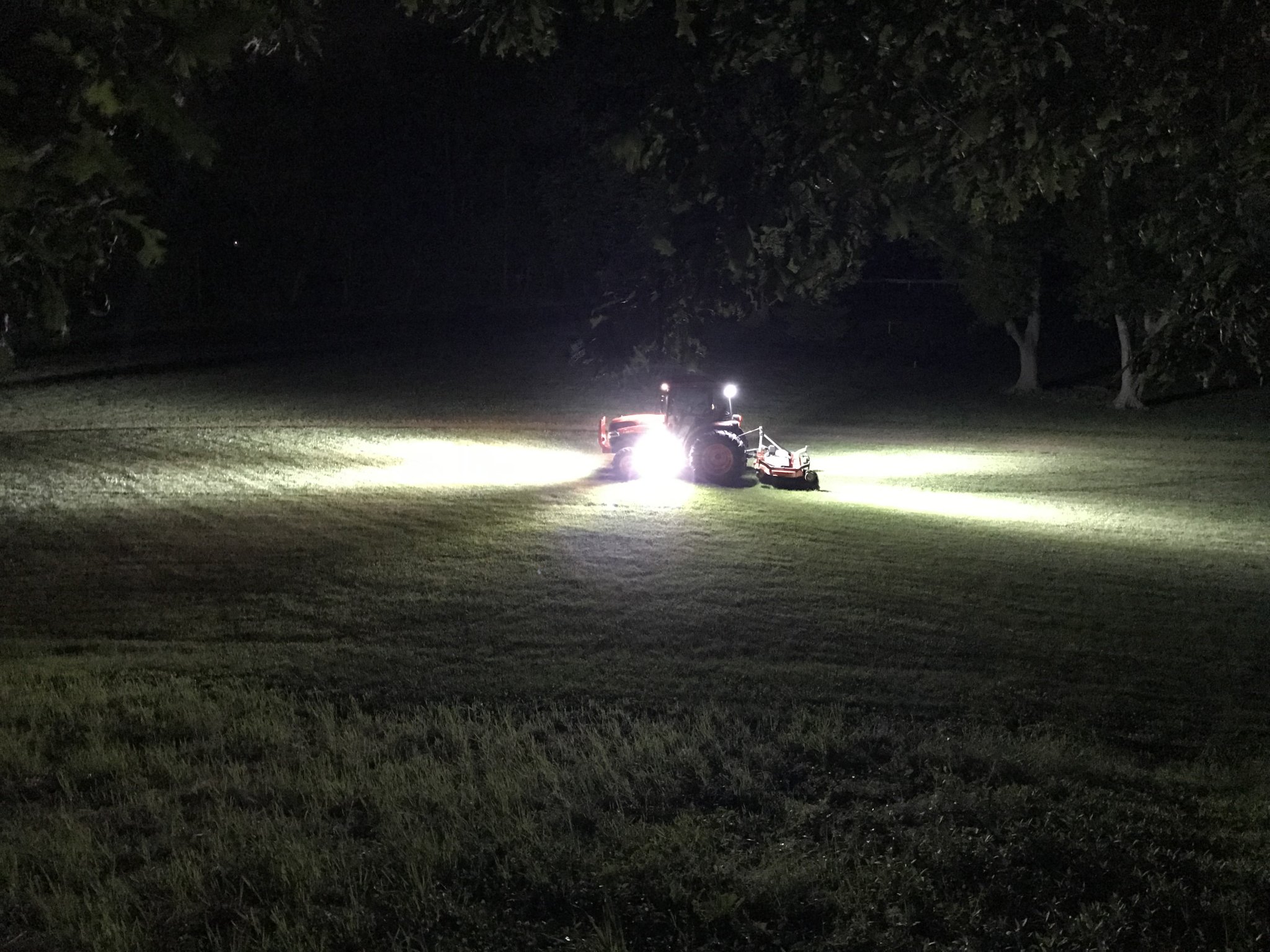

I never cared for ROPS-mounted lights. They attracted bugs in warm weather that made operating the tractor less enjoyable. They also caused glare in my glasses because the ROPS was slightly behind me.
I did have aux lights mounted on fenders, loader frames and grille guards that eliminated the glare, kept the bugs farther away from my head and still provided sufficient light to do work at night. The cabs on the two most recent tractors allowed mounting lights at the roof and did away with glare and bugs. With the L4240 I also mounted lights on the grille guard in in the loader mount tubes (that stay on the tractor with the loader removed). Most times when I mow after dark, the cab-mounted lights lighting the hood are a distraction, so I kill them.
The LED's I use are Maxxima MWL42 for the cab (front and back), and the grille guard. The side lights are small cubes that fit into the tubes mentioned. I think I was paying around $60 each for the MWL42's at the time. Flood pattern is the only thing used on my tractors for good full coverage. There's no benefit for me to use spots or something that illuminates the area for 1//4 mile ahead. Top speed for the L4240 is around 18MPH - and a whole lot less when mowing:)
