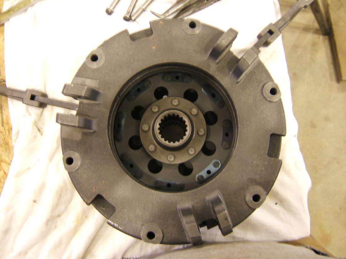

A couple of thoughts that I have run into before with these type of clutches in big trucks. 1. Was the clutch assembly in one piece or did you have to stack it up and put it on.
The clutch assembly came in one piece except for the first stage friction plate.
I ran into troubles before with the clutches that have a secondary flywheel in the middle that you can put that piece in backwards because it would fir but actually the ears that held it in place were actually not in the center and if put in wrong the clutch would not release. 2. Could you post some pictures of the flywheel and the pieces of the clutch not bolted in place?

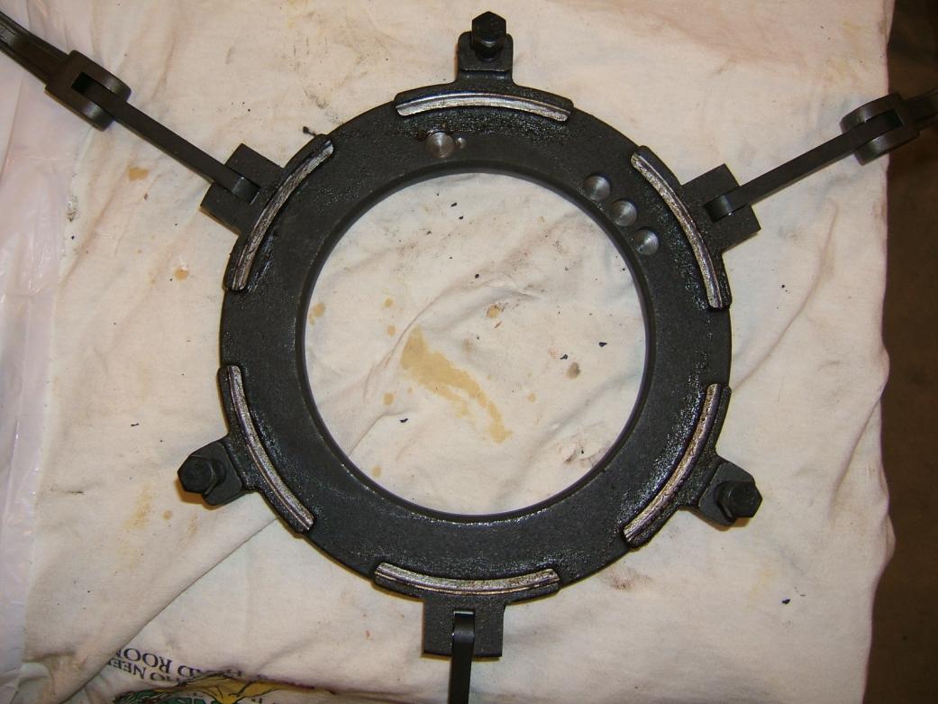

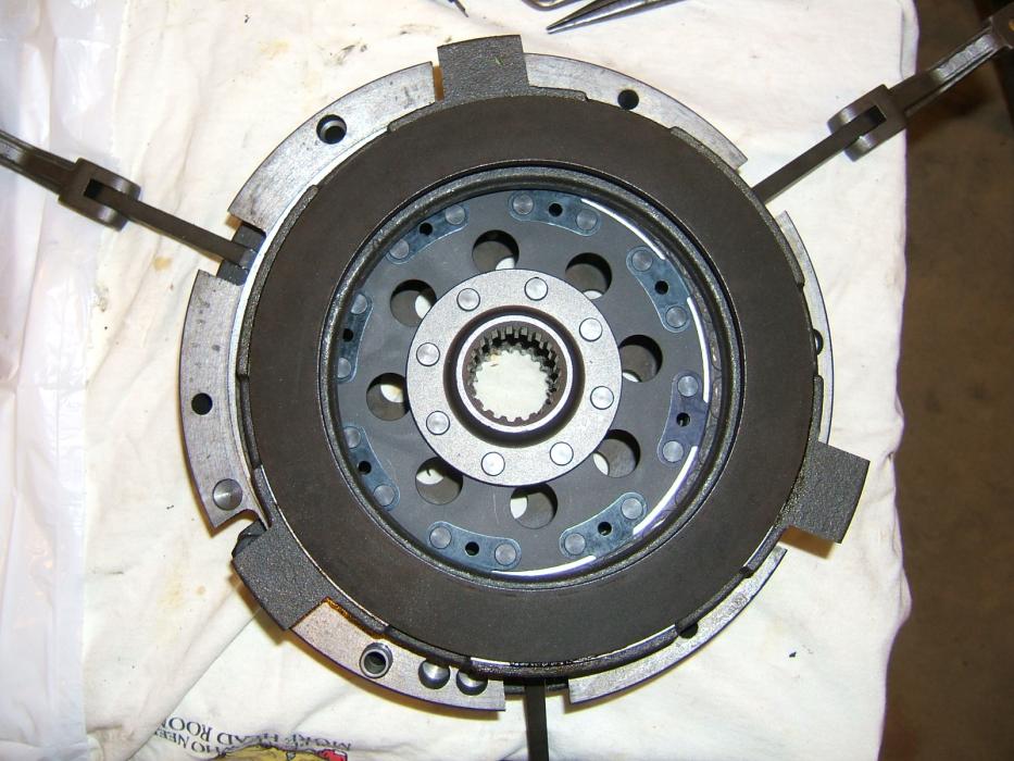

Attached some pics, batteries now dead and no spares, will have to post additional tomorrow if the ones already posted are not sufficient.
Also a picture of the throwout bearing on the forks. Posted It might help to see the individual parts to see what might be going wrong. Clutches, particularly ones with more than one stage can be awfully frustrating particularly if the parts are not marked well. Good ones will have a mark on it saying which side is the flywheel side,
Friction plate that contacts the flywheel will only fit on one way.
but many don't. I am sure the answer is there somewheres but it can be extremely frustrating getting there. The worst thing can sometimes be getting the two clutch disc splines to line up. I have taken this clutch apart and bolted everything back up including the first part of the trans so many times that getting the two clutch disc splines to line up takes me about 2 min now.
I assume you are using a line up tool when you put the clutch on?
I do not have a two stage alignment tool. To align the second stage I center it in the top clutch cover. To align the first stage I use a socket wrapped in tape so it will just fit into the center of the first stage disc and the socket just fits into the center of the flywheel. Using this method I can get the trans slid into place in 2 - 3 min. then bolt up the trans.

BAP, here are the pics I promised: Tried to attach a schematic of the clutch but everything that I tried failed. The schematic can be found on the third page under ENGINE not under clutch. It is a L275DT

In your attached schematic of the clutch, it was item #4 that I was referring to that I have seen be able to be put in backwards and hole the clutch up. We also one time had a clutch that we could never make work and got the parts place to give us another one and it worked fine. We never could figure out what was wrong with the first one. Just about drove us crazy laying on our backs under a ten-wheeler putting a 13speed Road Ranger transmission in and out many times trying to make it work. It could very well be that the clutch is not the right one.

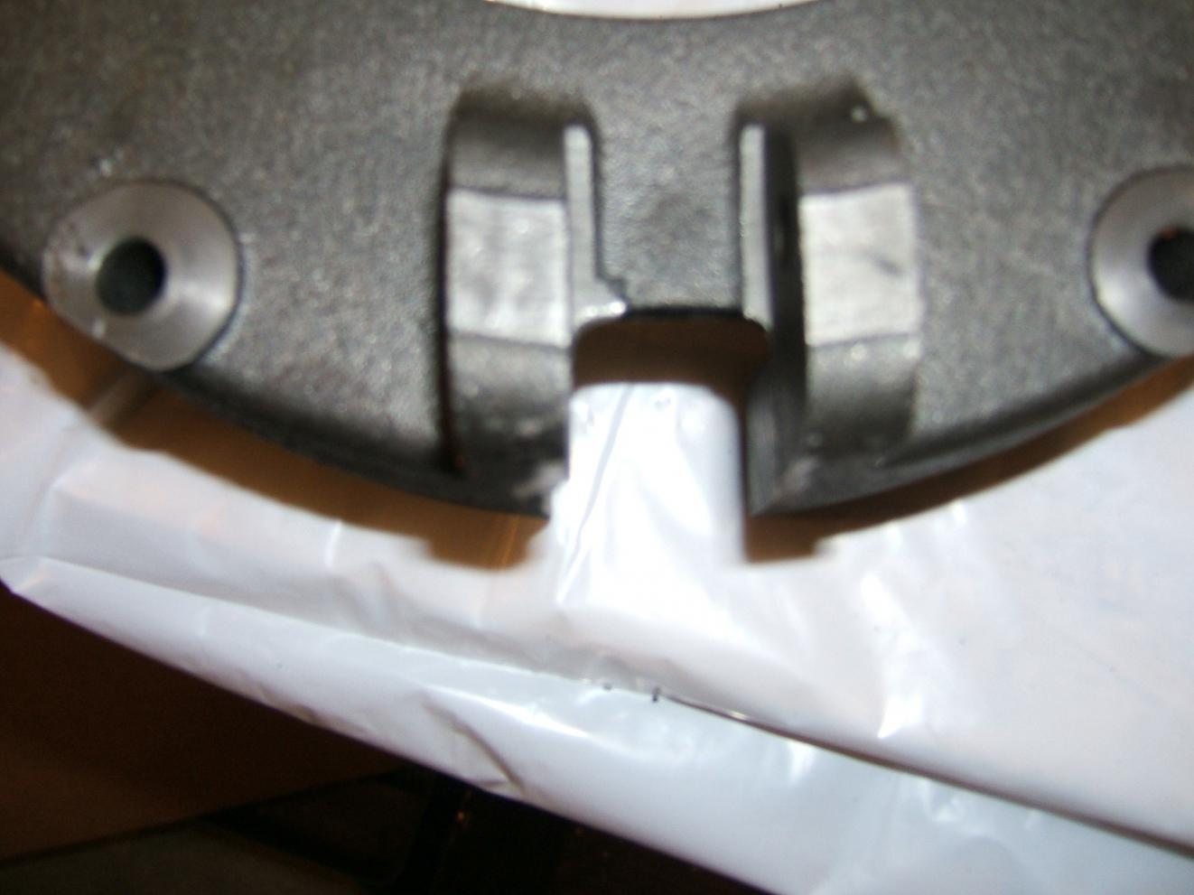

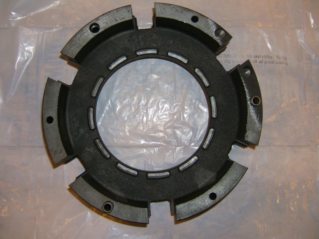

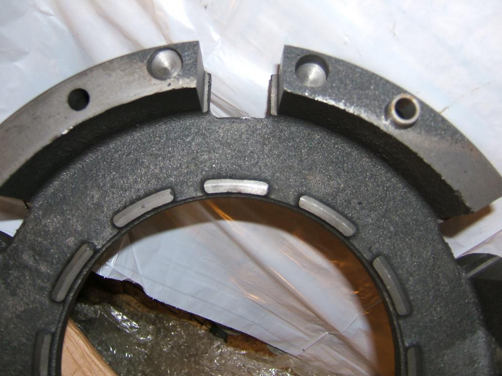

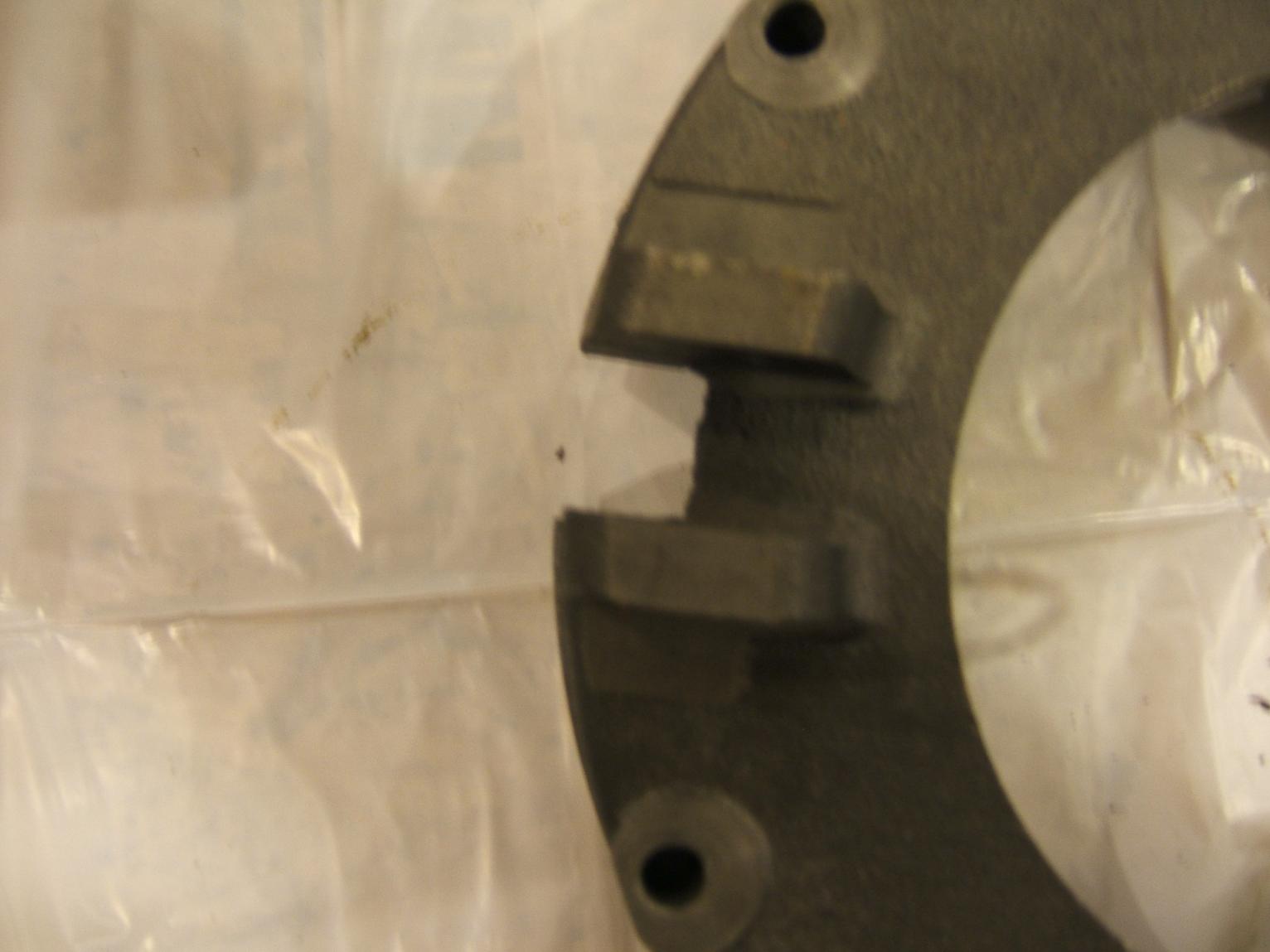

Thanks for your response. Part #4 in this clutch assembly is flat on one side to act as a pressure plate, the other side is recessed and has ridges to hold the spring disc in place.
In the forth picture in post #51 you can see the back side of part #4.

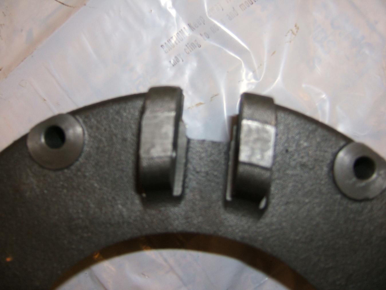

The QC on the machining in the parts leaves a lot to be desired. Given the close tolerances needed for the clutch to work I am inclined to believe that this is a bad clutch pack, the second one. In the last set of pics I tried to show some of the material left behind that should have been removed. I cleaned some of it up and in the morning I will try to install it again. If that doesn't work I will have to try and find another source for the assembly. This is the second assembly from the same supplier.
