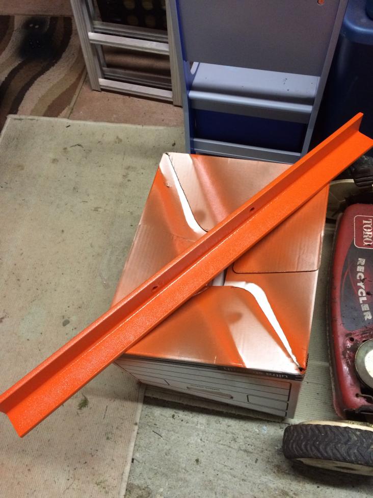

Great job looks new. [emoji106] as far as the bumper goes I'll put a few pictures of mine. I was worried about the hood and steering, so I got a 30" piece of 2x2 angle iron, drilled a couple of holes and bolted it on.

WoW! That things looks sweet! Why didn't I ever think of that ???
Now all I have to do is track down some angle iron and paint it with the whole other can I have of Kubota Orange. I can't thank you enough for the idea!!!
It's far less expensive to go your route and I have no guarantee if the OEM bumper for the T2080A will fit my T2080. My only thinking is that may be a little wide for my needs and taste, But the look and function of the iron will be spot on I think!
Only difference will be I plan on making mine to be 24-26" long. Now onto where I would find a piece of iron.....

I got mine out of the scrap bin at work hit it with the wire wheel and orange paint. Sticks out just far enough not to bump hood and wide enough nothing can get in-between the tire and steering. I have a lot of obstacles trees bushes etc. it's hard to watch all four corners at the same time LOL

Well got me a 2X2 piece of angle iron from a local Metal Works and it's actually 31" long. I don't think that will make that big of a difference. Just finished brushing it off and hitting it with the bench grinder/wire wheel. Down to bare metal and ready for the Self Etching Primer and following up with paint. Gonna put about 3 coats on it for layers of build up.... That way I shouldn't have to touch it for a while!
Pics to follow.... Wish me luck! :)

You shouldn't have to go that extreme Bare metal and etching , just get any rust off and smooth it out paint is cheap.

That's true! I was just doing it with product I already have. Once I got it smoothed I coated it once with some Self Etching Primer and I still had 1 1/2 cans of the Kubota Orange II I picked up from the local dealer without anything in the near future to paint on this thing so I figured I would put about 3 coats.... no biggie. I just did the top and bottom last night and I'm going to do the inside of the bend tonight. Should be installing tomorrow and posting pics. I want my to come out just like yours! I even painted the hardware black as well. :D

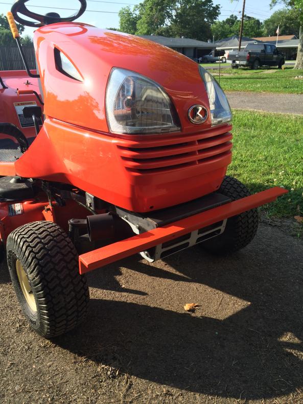

Ok without further adue. What do you get when you cross this.......
With this............
The end result... I think it came out pretty good myself. 2X2 1/8 think angle iron is pretty stout IMO. With it bolted good and tight I can't see it bending :D Yours was the model and still looks better!

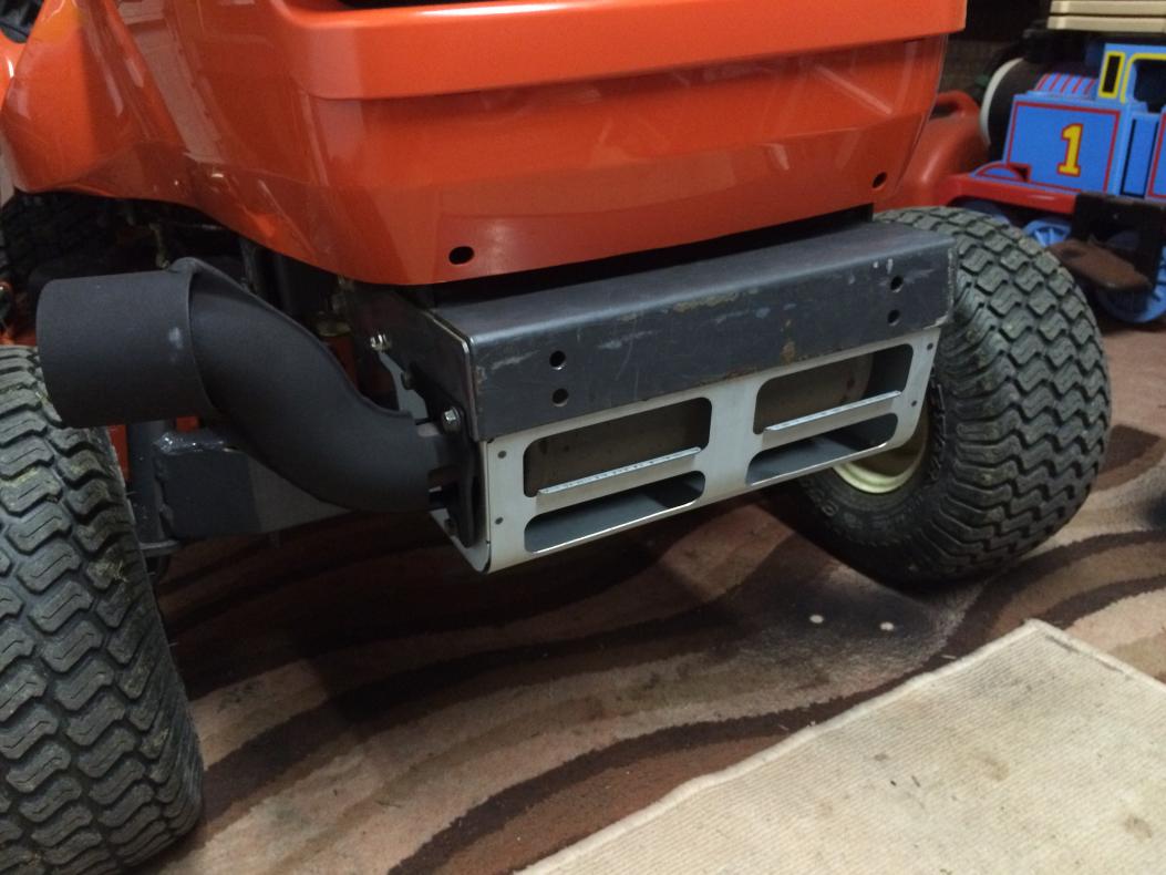

Ok well just don't make it look better than mine lol. Btw I like that little twist on the exhaust do you know if that is stock parts or fabbed up? I added some lights on the back of mine this fall thought maybe you like to see them.
Sorry forgot to answer your question about the twist on the exhaust. That's actually stock for this model. And I think everyone in this series. It's actually called the Tail Pipe which bolts to the frame and muffler cover. I kinda diverts the exhaust from the front tire I think. Not sure what the technical purpose is :confused:
I took that off and painted it with some 2000 deg paint which gives it a flat finish and definitely made it look better. Kinda in rough shape before hand.

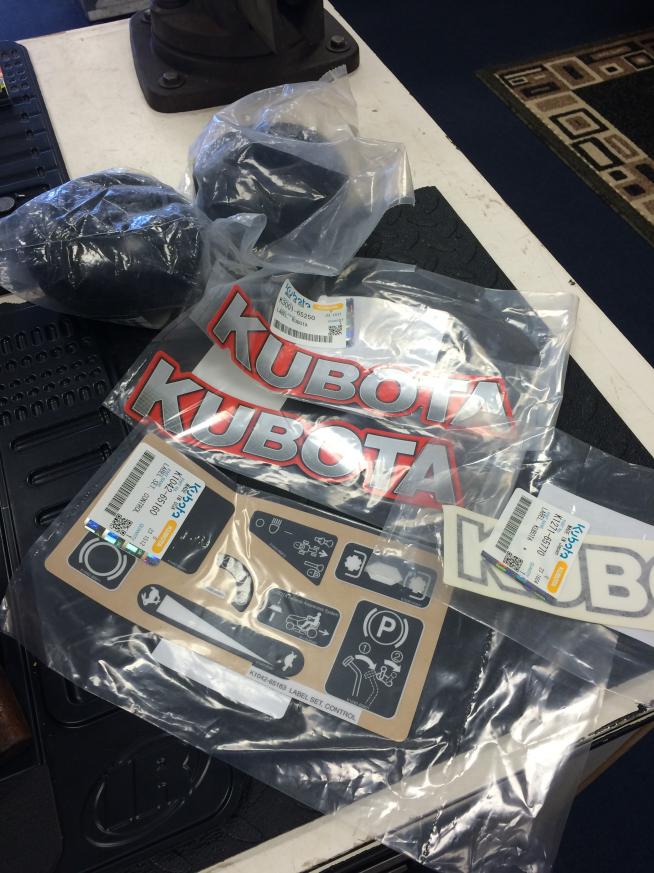

Thanks for the vid! Whenever you have time that would be cool to see! Forget the washing and waxing.... I've been putting some pics up even though it's a little dirty. I'll take some more pics tomorrow now that I've got the decals on. It dresses it up nicely. I even got the decal kit that covers all the older ones on the dash and foot area for the brake and parking lock. Throttle, turn key, light switch, and cruise control. I'll post a pic of the hour meter I installed as well. Regardless I don't know how many were put on it when I got it.... I just like to keep up with for service purposes. :)
