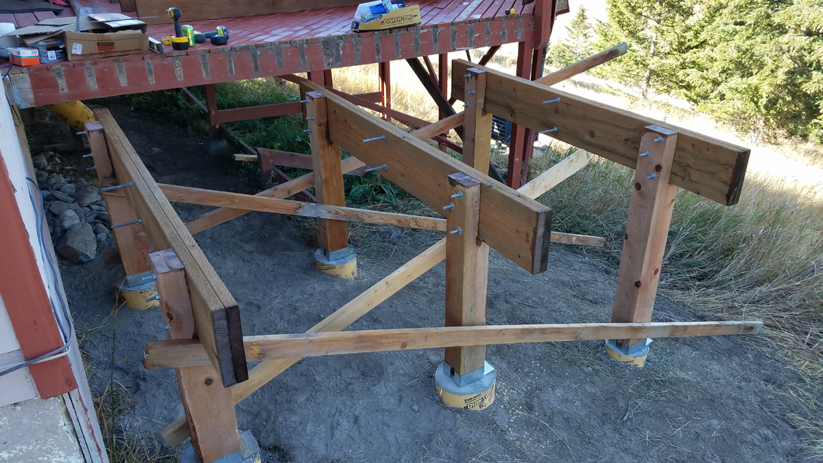

I rented a PHD when I built the 10ft x 10ft deck for the hot tub in 2016 (see below) It was a standalone, counterbalanced unit on wheels and it worked well, even on a significant slope. I opted for the 12" auger and dug down at least 36" in order to place sonotubes.
I plan on replacing the POS deck on the house next year and will use steel posts set in concrete, but need to figure out how to get the M6060 and PHD to that side of the house without rolling the tractor.
