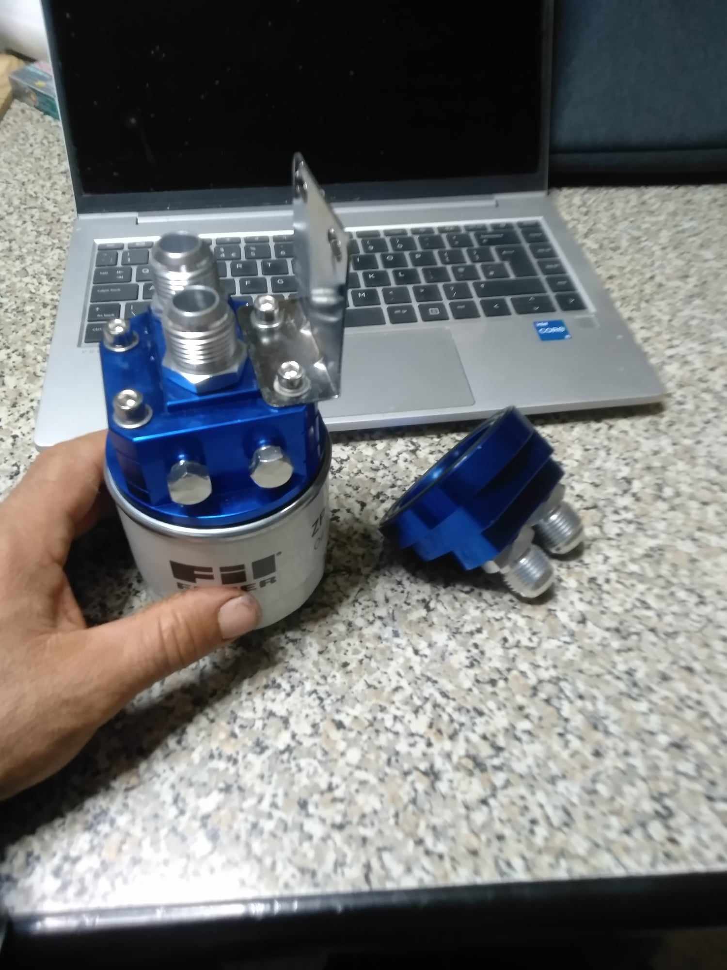

hello
The adaptors arrived today. the mounting plate looks flimsy but if I push on with the idea (find time) I will fabricate something better. The two bolts at the side are for oil pressure and oil temperature senders Should I decide to install them.
I did fit a pressure gauge but i had to use 6 or so adaptors/reducers to clear the pressure sender away from the exhaust manifold.
I need to study well the way oil circulates within the oil filter to avoid messing up the filtration circuit :D
The linking lines will probably be metal lines (the sort used in hydraulic systems). Everything will be properly guarded. I have some OCD traits when it comes to these kind of things :D
In reply to the messages about over heating. It is heavily worked but things like radiator and oil levels are checked regularly
PS... the thread on the filter end looks ok.. filter tightens up well and evenly but on the adaptor that fits to the block it looks off and when i screw them up there is a gap... I guess I just threw away 40Euros :( doh. will see... will be collected dust
