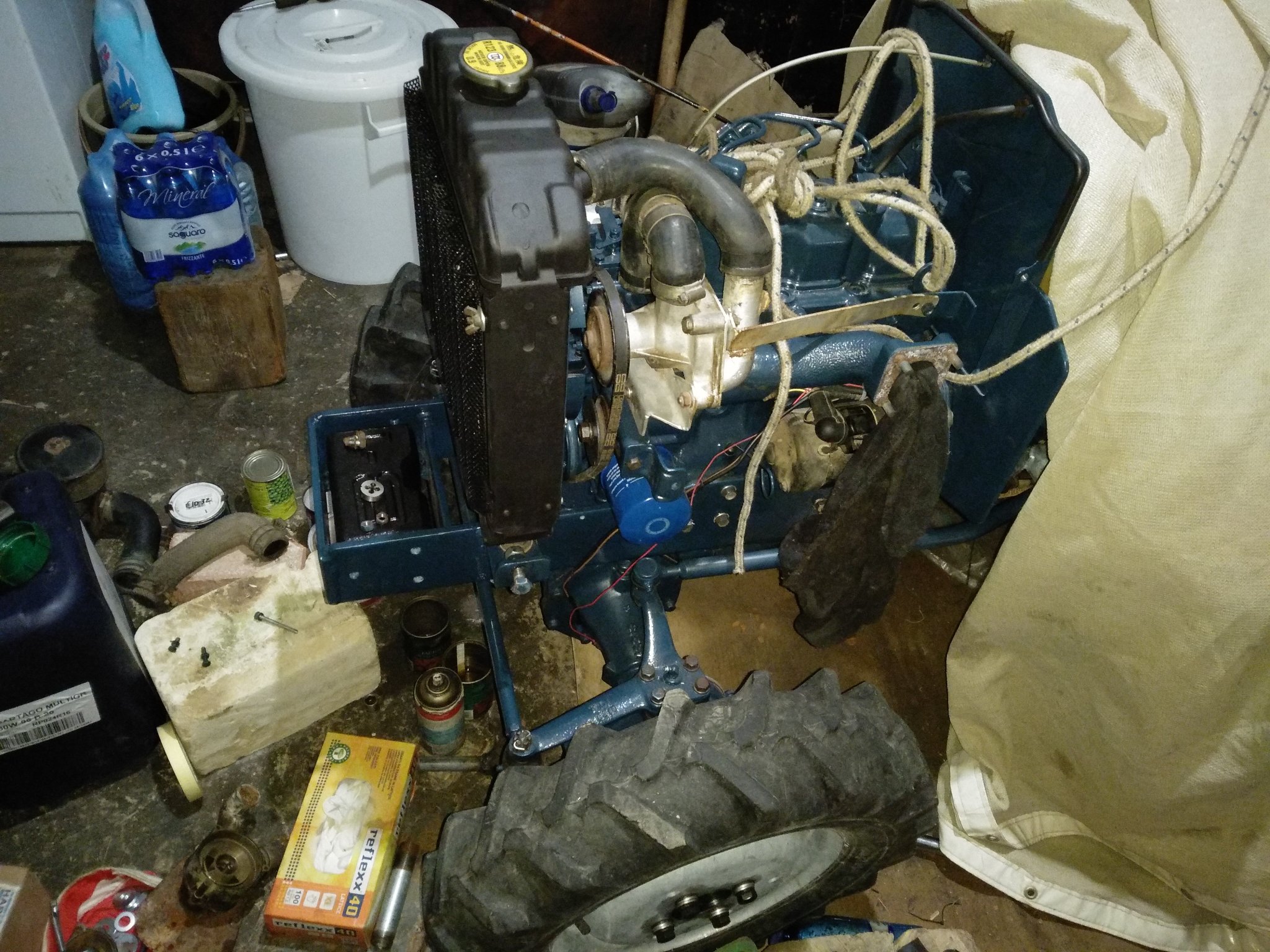

Has anyone considered installing a remote engine oil filter kit on a B7001 tractor?
Not to advertise but I have ordered this:
I would like to located the oil filter in front of the radiator and possibly add a small 15cm x 8 cm motorbike engine oil cooler like this:
I have toyed with this idea for years to make it easy to change oil filter. 100hrs of work for me clock up fast and sometimes I have to change it within less than a month. It could also add as a cooling benefit.
thoughts?
I do not have many loved ones so If it reaches me before Xmas I may spend some times messing about with it to test it on the worn D750 before I transfer it to the thermosyphon D850 along with the automotive water pump.
joseph

I'm not against relocating an oil filter.
As a old school atv mudder I have done it in the past to get stock filters more out of the way of danger.
In front of radiator though would have me give a sober second thought as i also run a woodlot and would not want to put the extra oil lines in way of snags and filter in way of stick pokes. Potential of increasing a risk factor / increasing stuff in way of danger for little or no reason?

Not to throw a wet towel on the thought - but I too do not see the huge advantage of moving the filter. If I am correct, it is very similar if not the same as the US B7100.
Getting the oil filter off is not really a problem on the B7100 - sure there is a bit of mess dripping and cleaning of oil residue.
The only advantage as the filter body said that would be true is that you "could" place a larger capacity oil filter on it.
As for the oil - like all things in the engine - you DO want that oil to get hot, rather hot too, to burn off any condensation that has found its way into the pan. If your oil is getting about 230 F / 110 C and NO HOTTER then you are perfect as it sits.
Now if we were talking about relocated a FUEL filter on lets say a BX ......... shoooot I am ALL IN on that :LOL:

Relocating a filter isn't that big of a deal. If it makes access easier, why not?
I wouldn't add an oil cooler though. If the manufacturer didn't, there probably isn't a need. Besides, without a thermostat to control flow, you could take too much heat out of the oil. Especially after first starting.

I’m with above on this one. Oil filter relocated sure why not try if your doing them once a month and it’s a pain in the a**. The oil cooler id probably not do. If it ain’t broke don’t fix it.

I used a similar adapter to relocate the filter on my MR-2 race car since I was changing the oil after every track day, and I also put an oil temp sensor in that sandwich block.
My oil temp readings were getting crazy high, so I installed a big oil cooler - still didn't solve the problem. It took me far too long to figure out that the aluminum sandwich block holding the temp sensor was right next to the exhaust manifold - so my oil wasn't really 285°, but that darned block sure was!
Once I relocated the temp sensor, I determined I didn't *really* need the oil cooler after all.
So I'm with the others - relocate for convenience yes, but a cooler is probably not called for.

Thanks for the input.
I have always been a bit concerned about the coolant pump with no stat in it. But it keeps temps at around 85 degrees when under heavy load for long stretches.
as said The oil filter relocation is purely to help make it easy to change it. I will think about a good location where it is away from danger. I found this a better option than butchering the side panels. The tractor has a hydraulic pump at the front with a guard up front as well. I can add to it to protect the filter.
with regards to the oil cooler which is quite small in size, Malta is a bit hot and temperatures are rarely under 15'C I used to give it 15w40 engine oil but I have a drum of 10w40 diesel truck semi synthetic oil which is i could use in the D850 once installed.
i just over think my way through life I know. :) I need a little project like this because I am growing really dull :(
