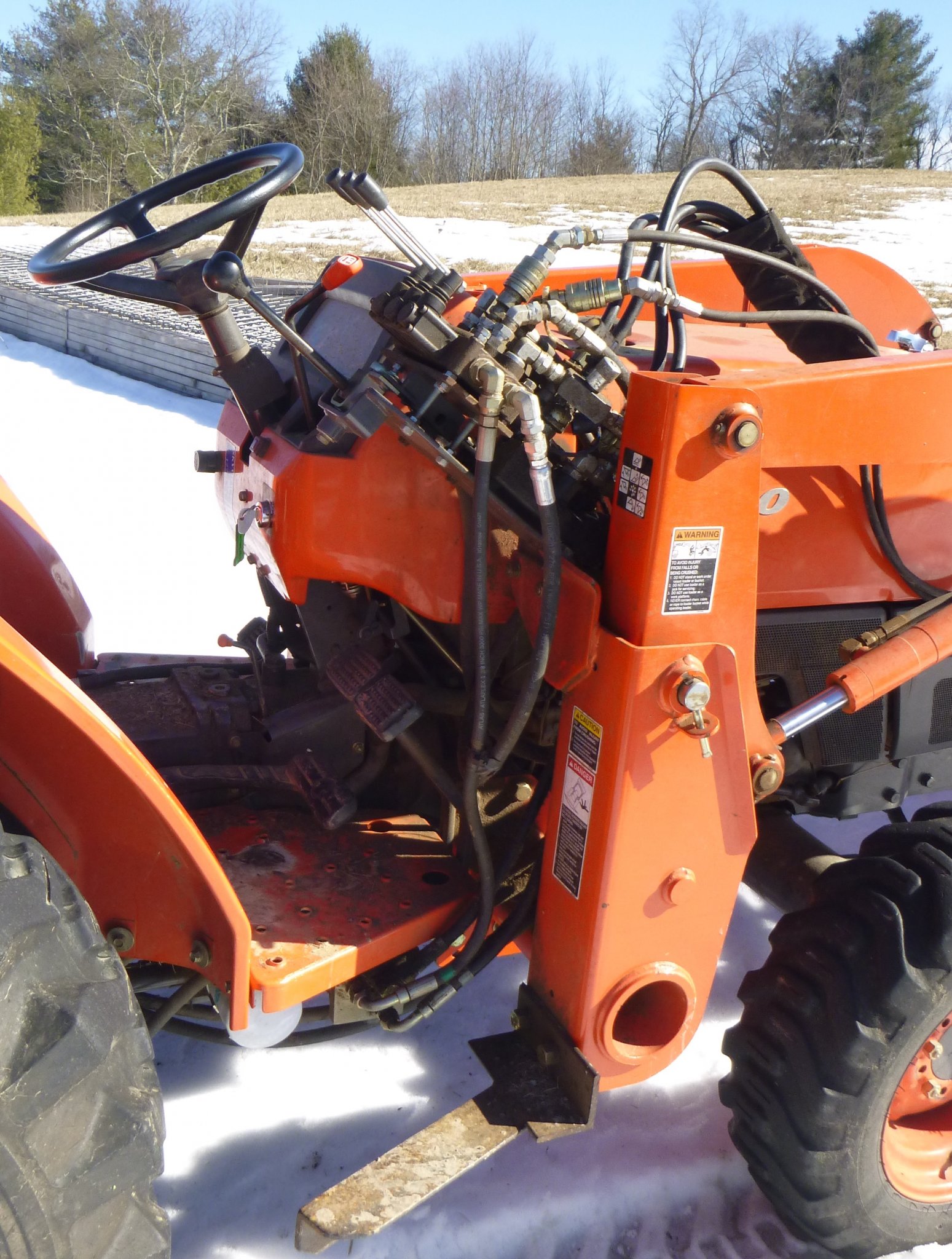

Depends on if you have the money to pay for the convenience of getting it done quickly and getting a VERY clean install. I wish my install was more professional looking but it's not. Not by a long shot but mine was about a grand including my used bucket grapple ($350), Top and (used) side link.
It was also a long drawn out process for me... I had good luck on my side with finding the grapple and side link. I did not want it mounted to the ROPS. If I had to do it all again (after knowing what I know) $3k might not be too bad of a price for this cheapskate!!
