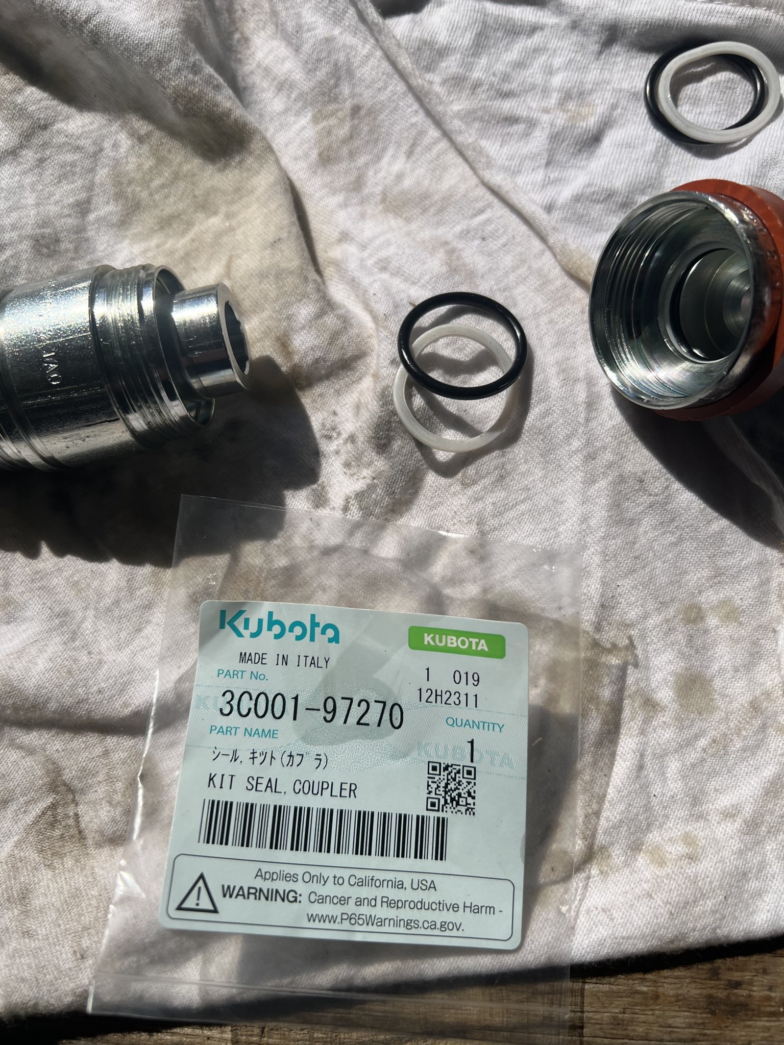

@JasonW , would you mind taking some photos and posting here to show the process? I can't find a schematic showing the internals of these Faster couplers. Also, what seal kit did you get from the dealer?

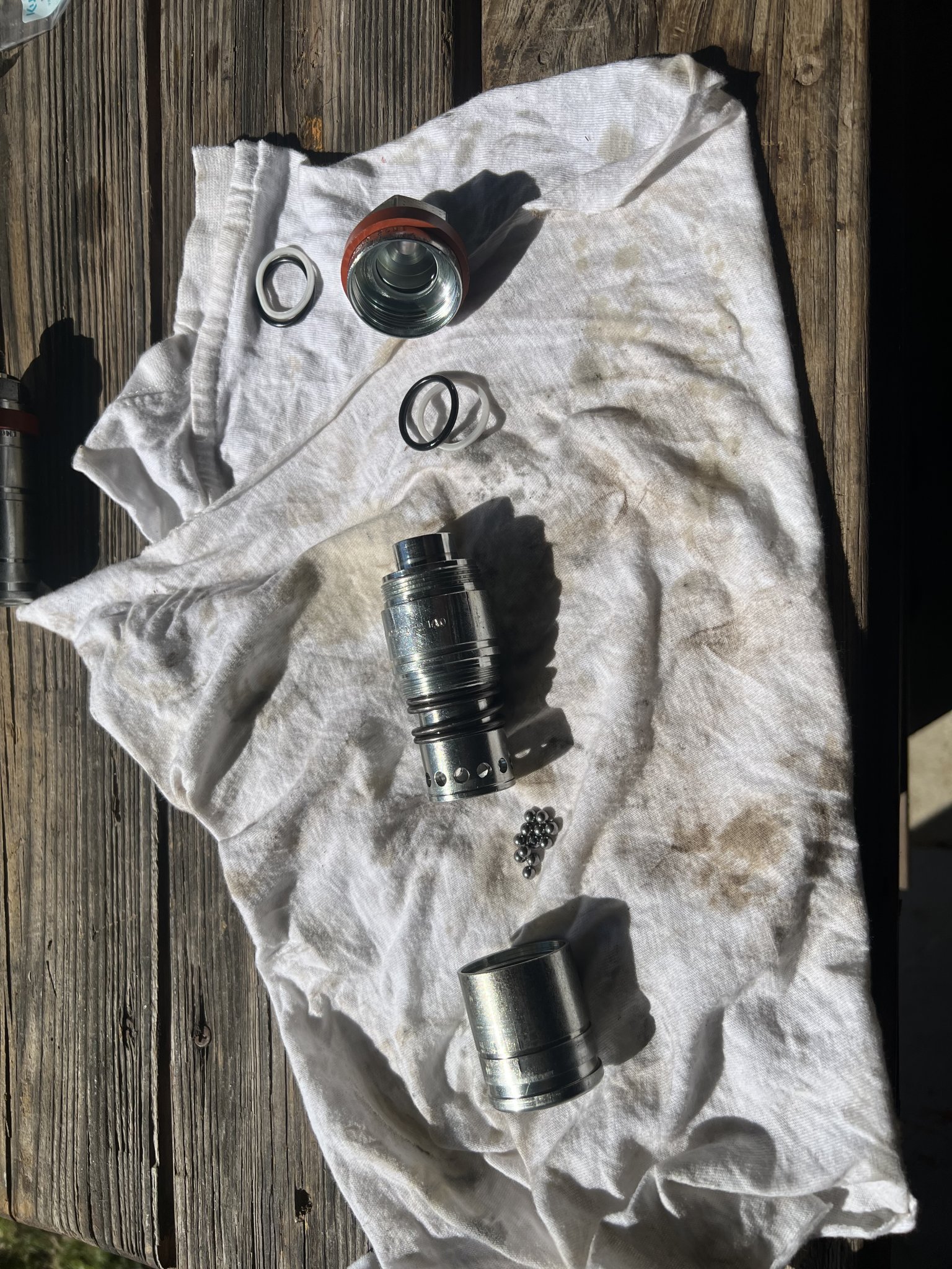

Got this done today. Pretty simple just need a vise. The Kubota seal kit only had one rubber o-ring and one nylon o-ring that goes on the side that threads into the tractor. There are two more o-rings on the quick connect side that are different sizes than the other end.
The picture is with the coupler fully disassembled.

How do you get the BB's back in? Some grease so they stick to the outside?

Al
I thought I was going to have to use the grease trick but I just stood it up on end and they fall on place.

What's the diameter of the black and nylon seals? Curious if mine are the same. Also, I assume that you didn't need to remove the spring loaded collar in order to replace the two o-ring/seals on the other end of the coupler.

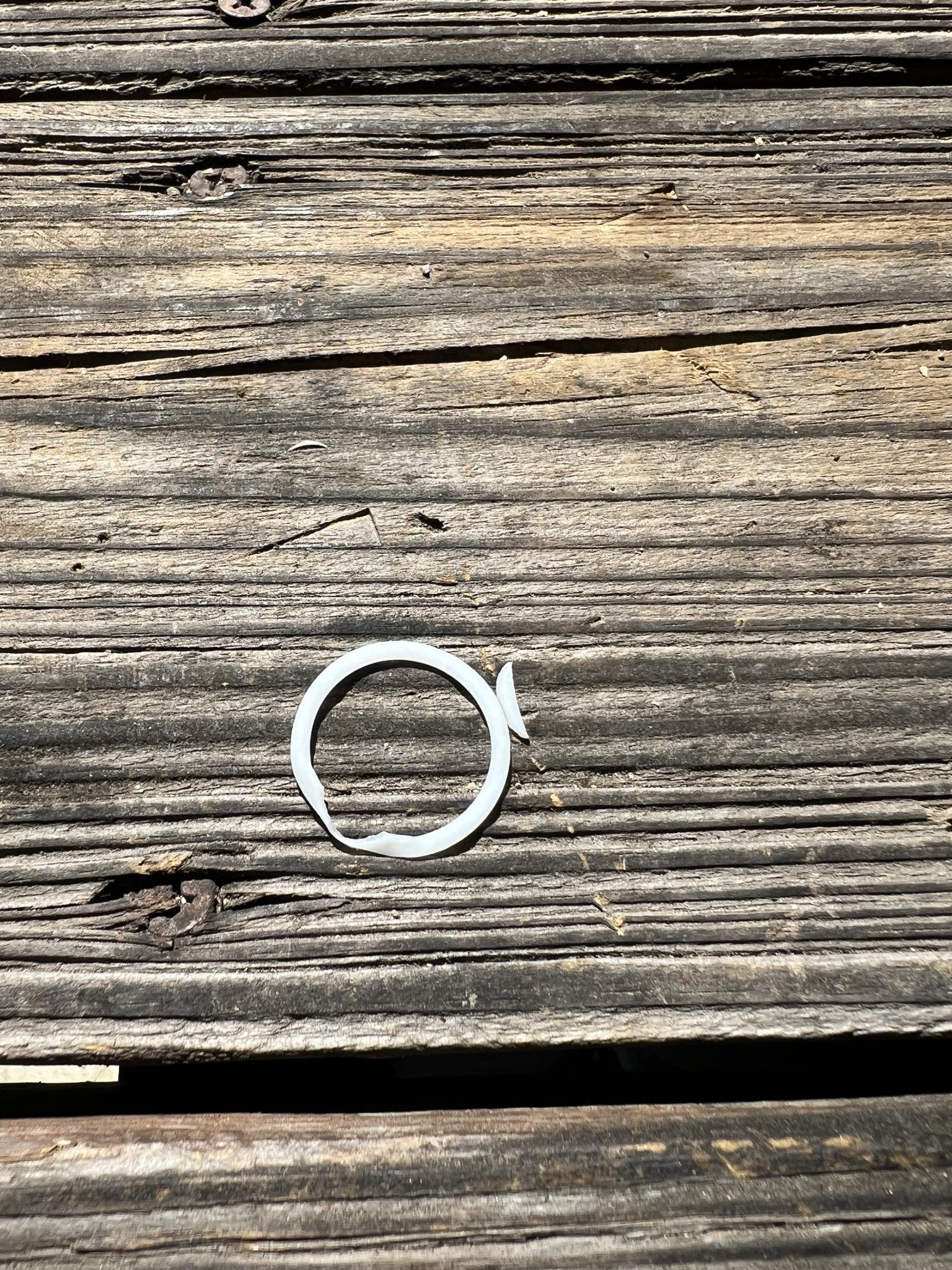

I would say yes and no. Ran it some tilling up the garden and one was almost pouring fluid. Disconnected the hoses and found a piece of the nylon o-ring.
IMG_3298.jpeg Disassembled that coupler to find it had pinched and rolled over the rubber o-ring.
Reused an old one(both were pretty mangled from pulling them out with a pic) and it appears to have fixed the leak on that coupler. But now the other one has started to seep. I haven’t taken it apart yet but I suspect it may have been damaged during install.
They were lubed with hydraulic fluid but they might be that fragile. So for now it’s to be continued.

Update. Well after three sets of seals the leak was actually worse than before, It was about 1/2 gallon every hour. Upon disassembly the nylon o-ring was damaged every time, they were put together lubricated and centered. All surfaces were smooth so I’m not sure what was happening.
Time and money ahead to buy new couplers. Guy I spoke to when ordering said it could have been the outer quick connect side seals(which Kubota doesn’t sa leaking and the fluid was coming out of the back of the coupler.
Bought new couplers and can confirm they are 3/8 British pipe thread. Best I found was about $50 per coupler plus shipping.

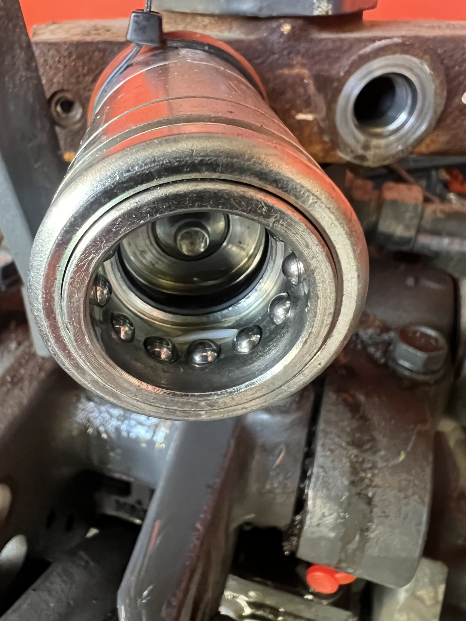

My M5-091 uses the break away couplers and they have leaked from new, I replaced one, still leaked. I cut a plastic oil jug to fit under the couplers to act as a catch can, problem solved. The plastic jug just happens to be gray in color a very close match to the Kubota gray.
