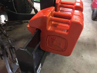

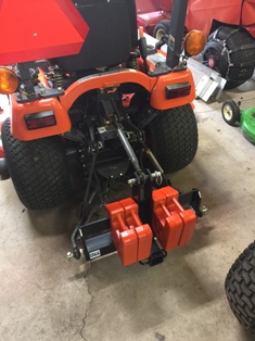

I had gift cards to Amazon so I bought a Heavy Hitch w/weight bar hitch adapter and visited a local "green" store and hung some mysteriously orange weights on the back. I have two more but found with the weight of the hitch, (Just shy of 50 lbs), plus the four x 41 lb suitcase weights, it counters what I have moved with the FEL so far just fine. They are taken off when I'm mowing. It adds up to about 212 lbs using 4 of them plus the hitch. (Little BX1500).
It is strange looking at an orange jumping deer though! I'll need to add some epoxy puddy and sand the middles smooth. Soon! :D
