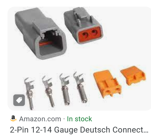

I used Deutz connectors rebuilding my tractor.
They come in many different configurations and can be purchased on Amazon for example.
Excellent and waterproof. Just use care in the assembly.
Maybe you can just replace the connectors.
