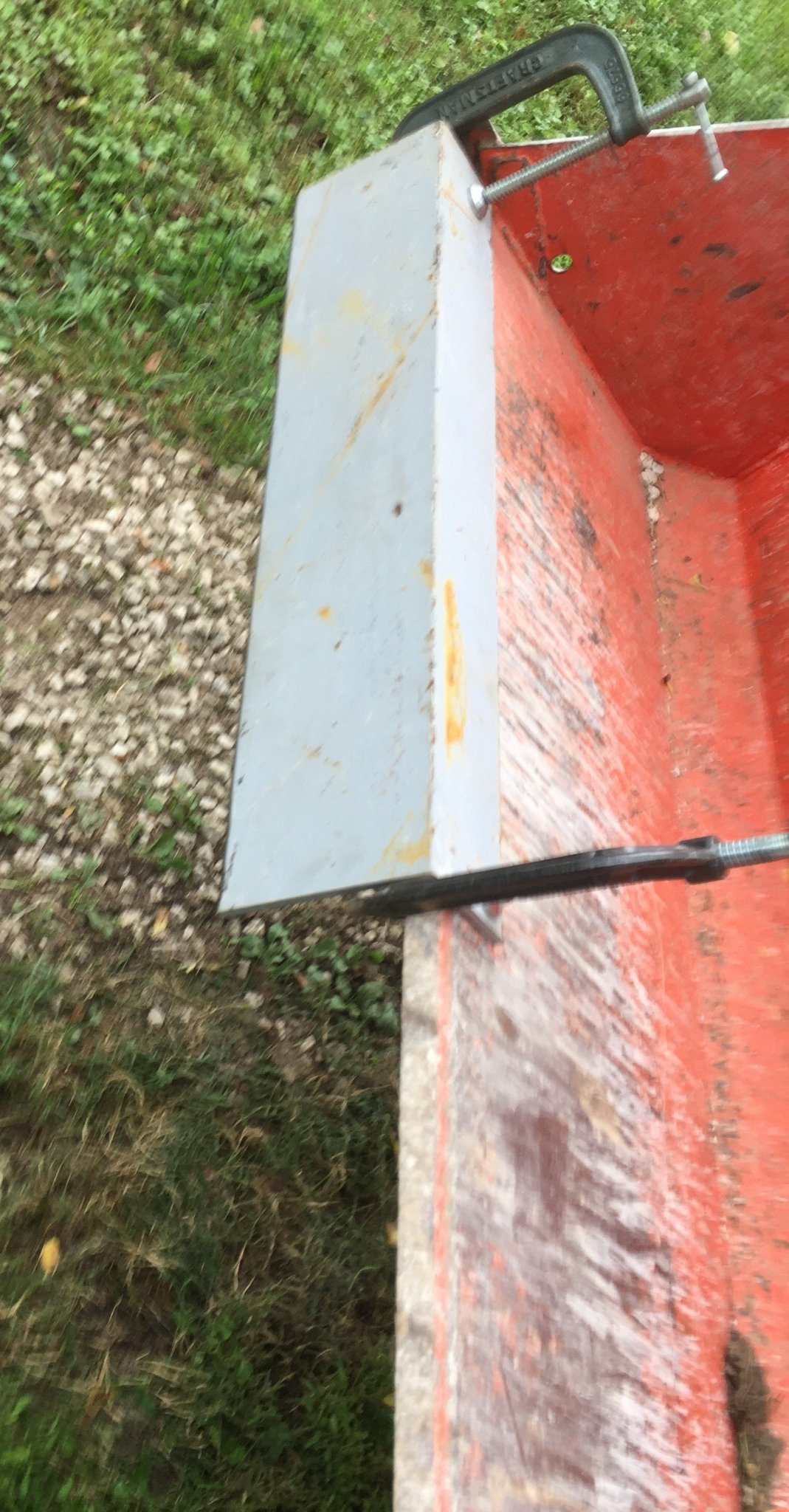

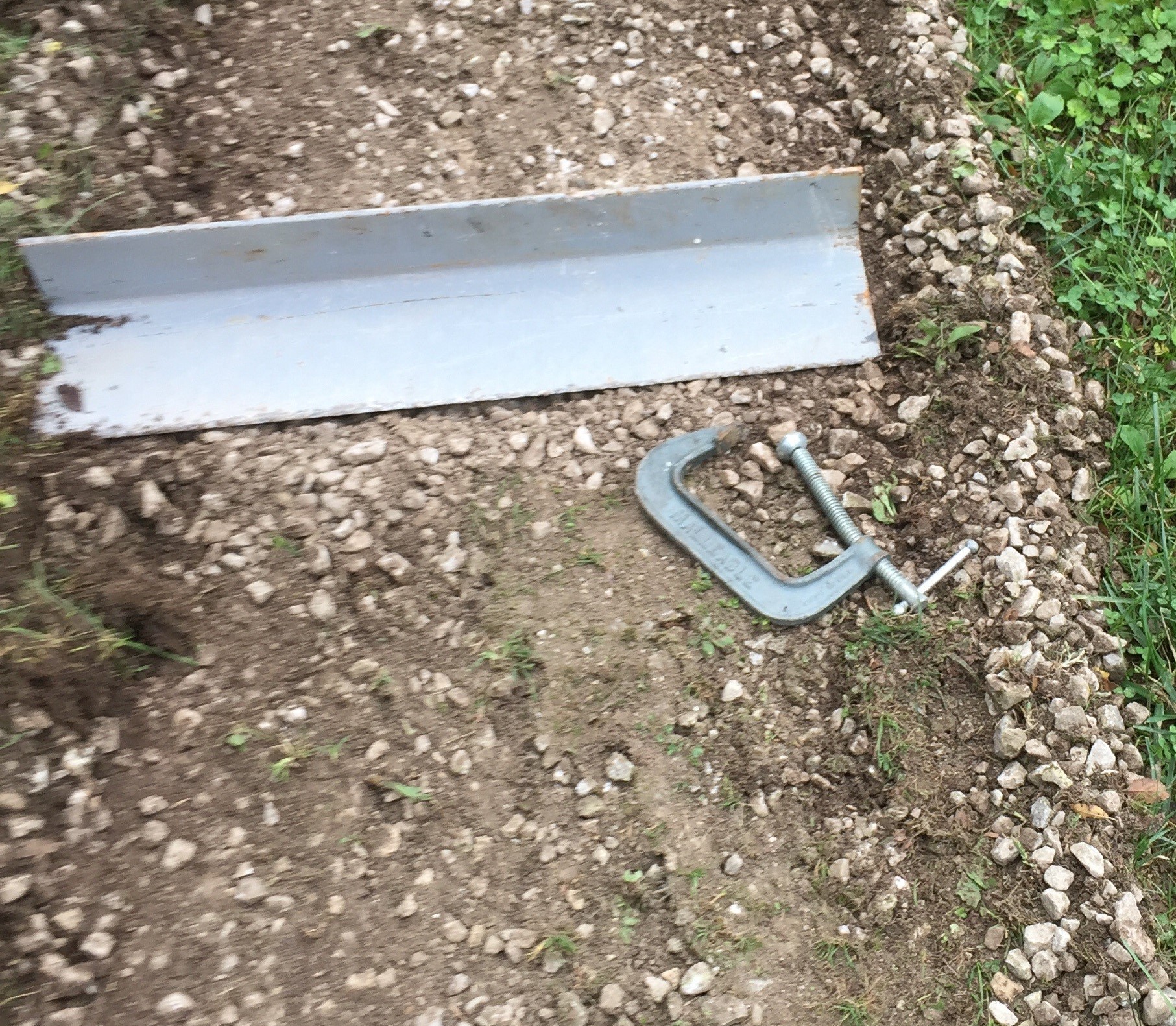

Of course, I wanted to check out the piece of 4" x 6" x 5/16" angle as soon as I got home - the short-lived V 2.0 - took a couple of 6" c-clamps and clamped it to the bucket. Scratched about 6' of one ribbon, but when I put downward pressure on it, I bent both c-clamps.

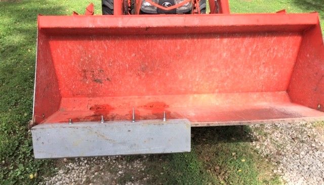

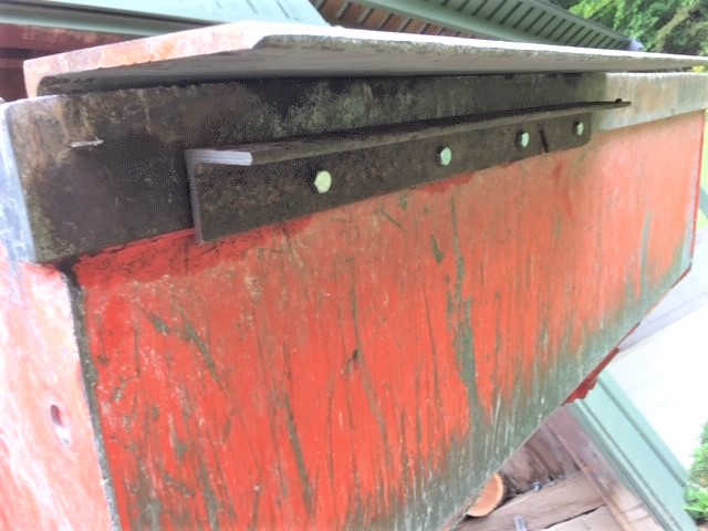

But for my impatience, I should have just gone with Version 3.0 - 4 x 6 angle bolted through the bucket (four 3/8" bolts) and through 2" angle below the bucket for some extra strength. I took the angle grinder to the bottom edge of the 6 x 4 angle to give it a tapered leading edge.
Finished it up today and did a test scratch - worked just fine - was able to handle downward pressure for aggressive scratching! By adjusting bucket curl and using float or downward pressure and since I'm doing one ribbon at a time, it's pretty easy to control. I don't need that much downward pressure - front wheels nowhere near leaving the ground. I'll pick up some Grade 8 bolts of the right length when I'm in town - for now I just used what I had on hand. Photos of V 2.0 & V 3.0 below. Now to put this to work and get the drive cleaned up!
