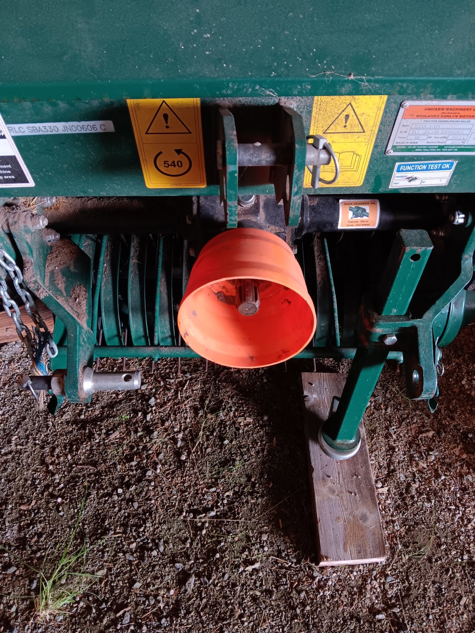

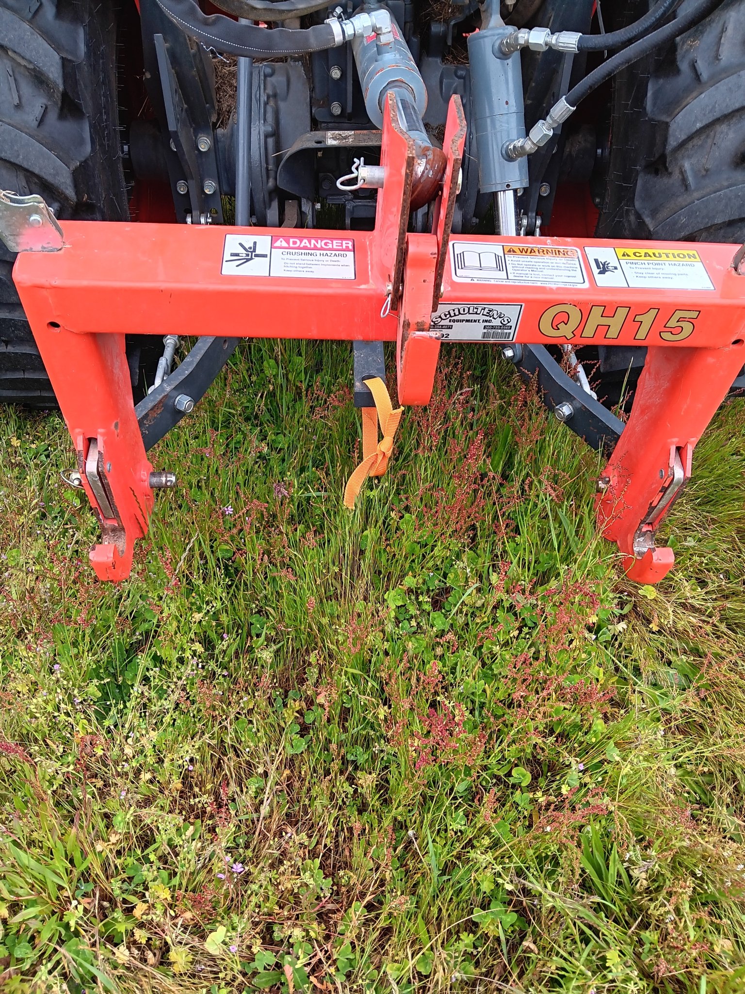

Well it's your basic L3901 :) And the quick hitch is your basic QH-15. The thing that's a little weird to me is that the lower links are slightly canted in when the QH-15 is on. I would have expected the lower links to be square.

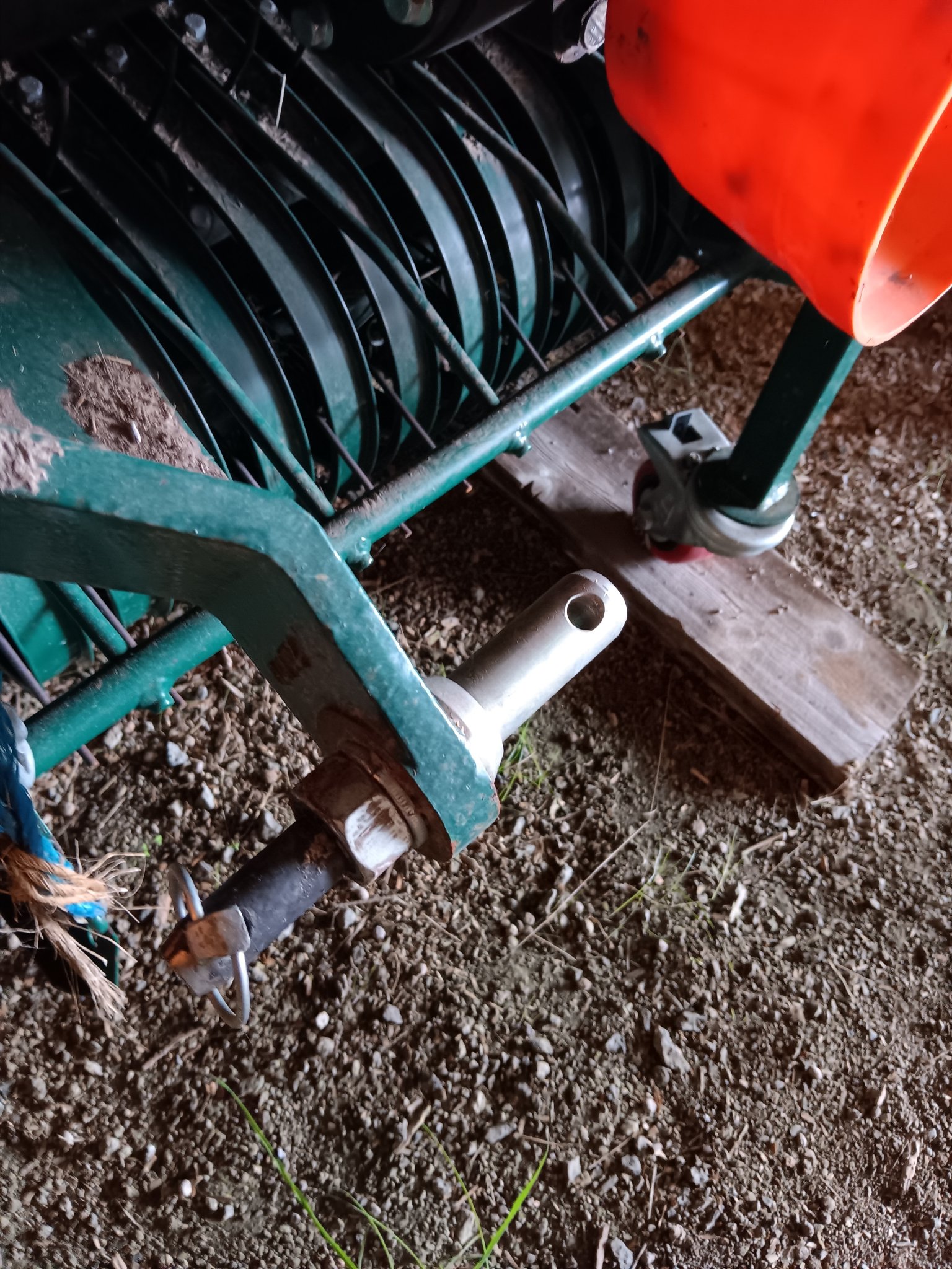

The lower pins on the baler (the green pics), are very, very close together. From the left pin to the right pin is only 23 1/2 inches. So the diagram from a few posts back is proposing a way to make the baler's lower pins wider.

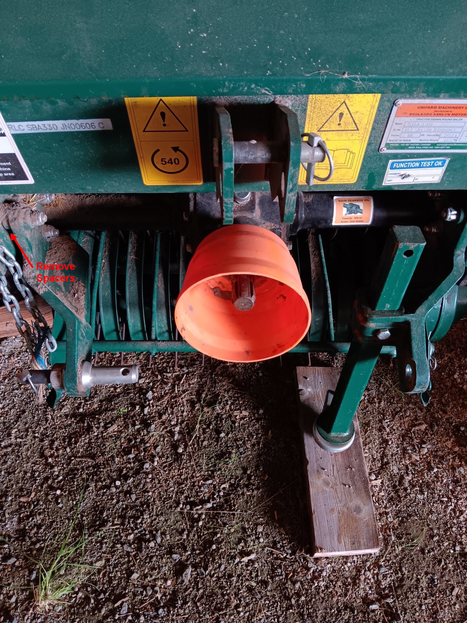

Could you remove these spacers?

I studied that idea. It looks really hard to do. They are buried under a lot of stuff. It looks like a massive deconstruction project.

The arms on the tractor being cocked to the side, does not affect them one bit.
That baler has an extremely narrow set of arms, it's rather odd.
You need to have someone weld some brackets on it to make it work with the QA.

Here is a Wikipedia article containing the dimensions (I do not think there is a standard, as in DIN or ISO for those). As far as I understand there can be "narrow" Cat. 1 implements which basically have Cat. 1 pin diameter but the bar distance of the next lower category, in this case Cat. 0.

late in looking but from the pictures.. if you remount the pins as 'outties' you should be CAT1 ? 23 1/2+1+1=2 1/2+ a bit ??
The problem may be the fixed spaced QH15 isn't wide enough. Normal 3PH the arms can move to install the implement.
The OM 'remove spacers' seems a good idea.

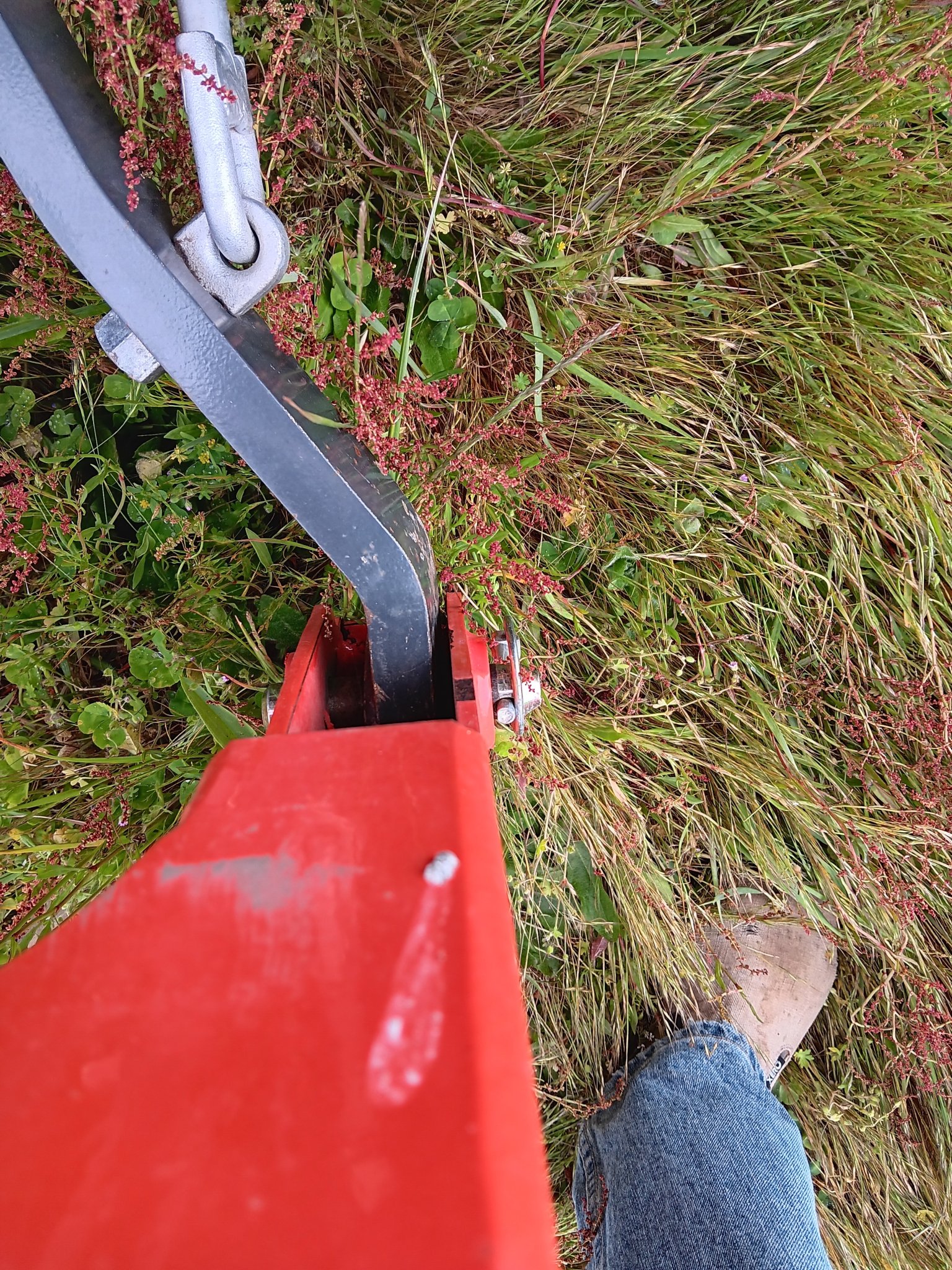

OK. EASY solution..... remove the quick hitch, bailer should connect to 3PH fine.
Yeah, that's what I've done for the last several years. The problem is that the ball joints at the ends of the lower links get twisted to the limits of their movement range, the baler is quite heavy, and it feels like they will become a point of failure. If those ball joints freeze up, then I have a big problem.
So protecting those ball joints is a big part of why I want to widen the baler's lower pins. Being able to use the quick hitch would be a nice bonus, but it's more about the ball joints.
The other thing is that when I'm on side hills, it seems like the narrower the lower links the more torque they have to deal with. The leverage is much better when the lower links are wider. Again, for an L3901, a 1200 pound baler is a lot to deal with.

hmm, back to plan 'b'. As OM said, remove spacer on the one side. Would that be enough of a gap ? Looks like 3 or 4 bolts, kinda easy to get to ??
I appreciate the ideas! That said, outside of both "spacers" are a bunch of complex moving parts. Linkages, drive chains and so on.

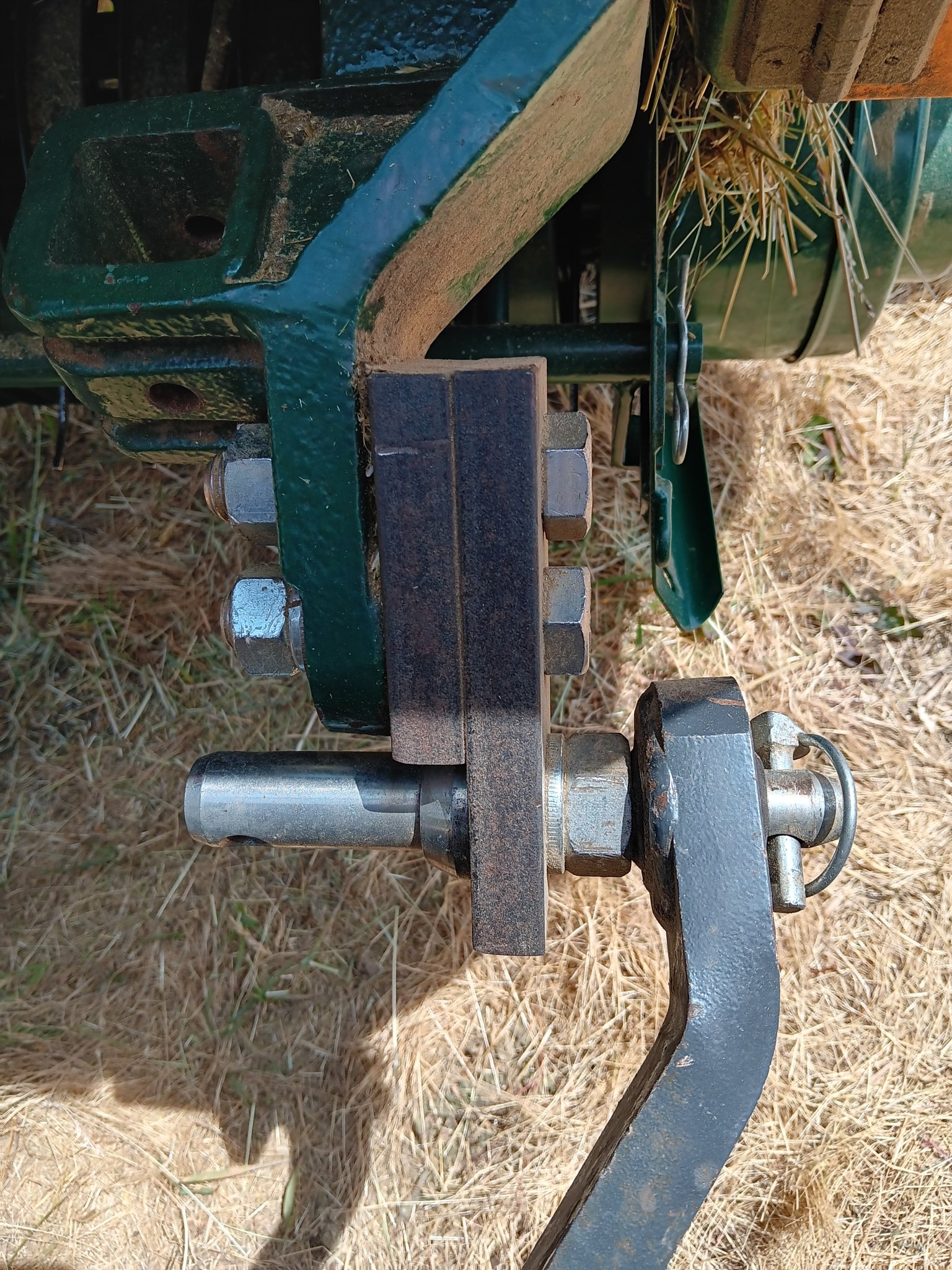

Just get this pair of extra long pins and stack plates, lock washers, flat washers, or what ever.

Update!
I got the new spacers added to the too-narrow baler. (picture of one side below).
It was a real pain to use a hand held drill to drill 3/4" holes into 3/4" steel, but other than that, things are looking really good. I just finished about 16 hours of baling and the spacers were rock solid.
The spacers are the two gray bars attached to the baler on one side and the lower pin on the other side. So you can see that the lower link is still canted in a little bit, but before adding the spacers, the lower links were severely canted in - a few times it was hard to get the ball joints to come unstuck.
