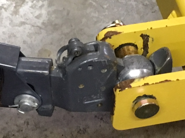

Well it's your basic L3901 :) And the quick hitch is your basic QH-15. The thing that's a little weird to me is that the lower links are slightly canted in when the QH-15 is on. I would have expected the lower links to be square.

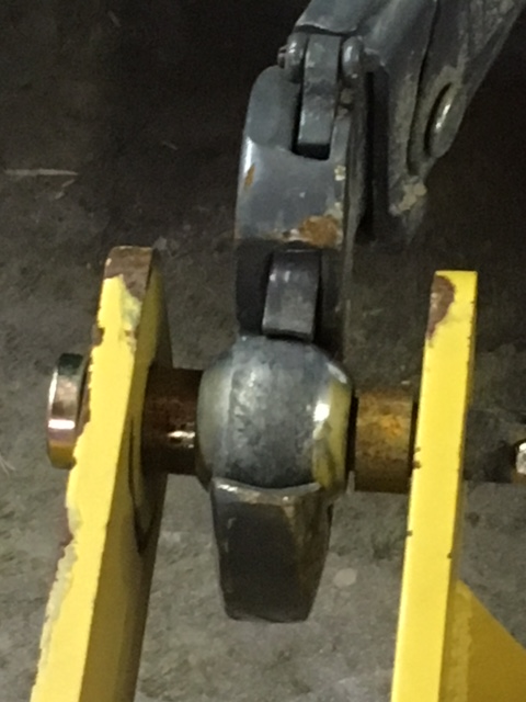

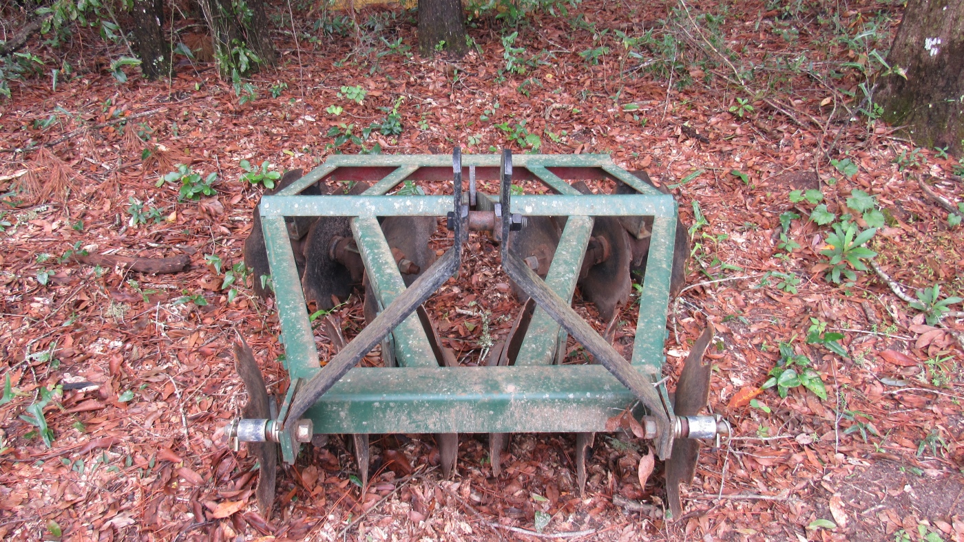

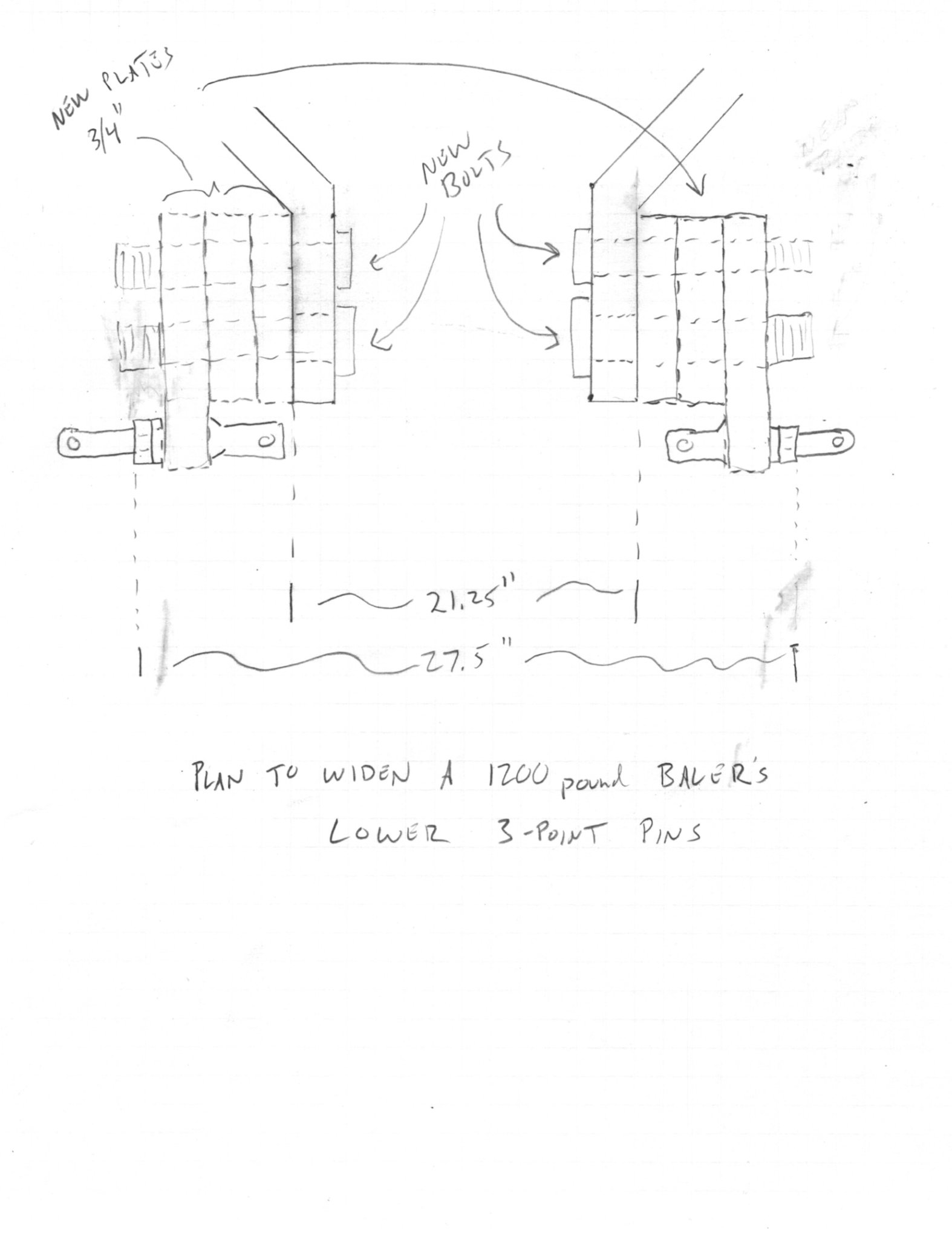

The lower pins on the baler (the green pics), are very, very close together. From the left pin to the right pin is only 23 1/2 inches. So the diagram from a few posts back is proposing a way to make the baler's lower pins wider.

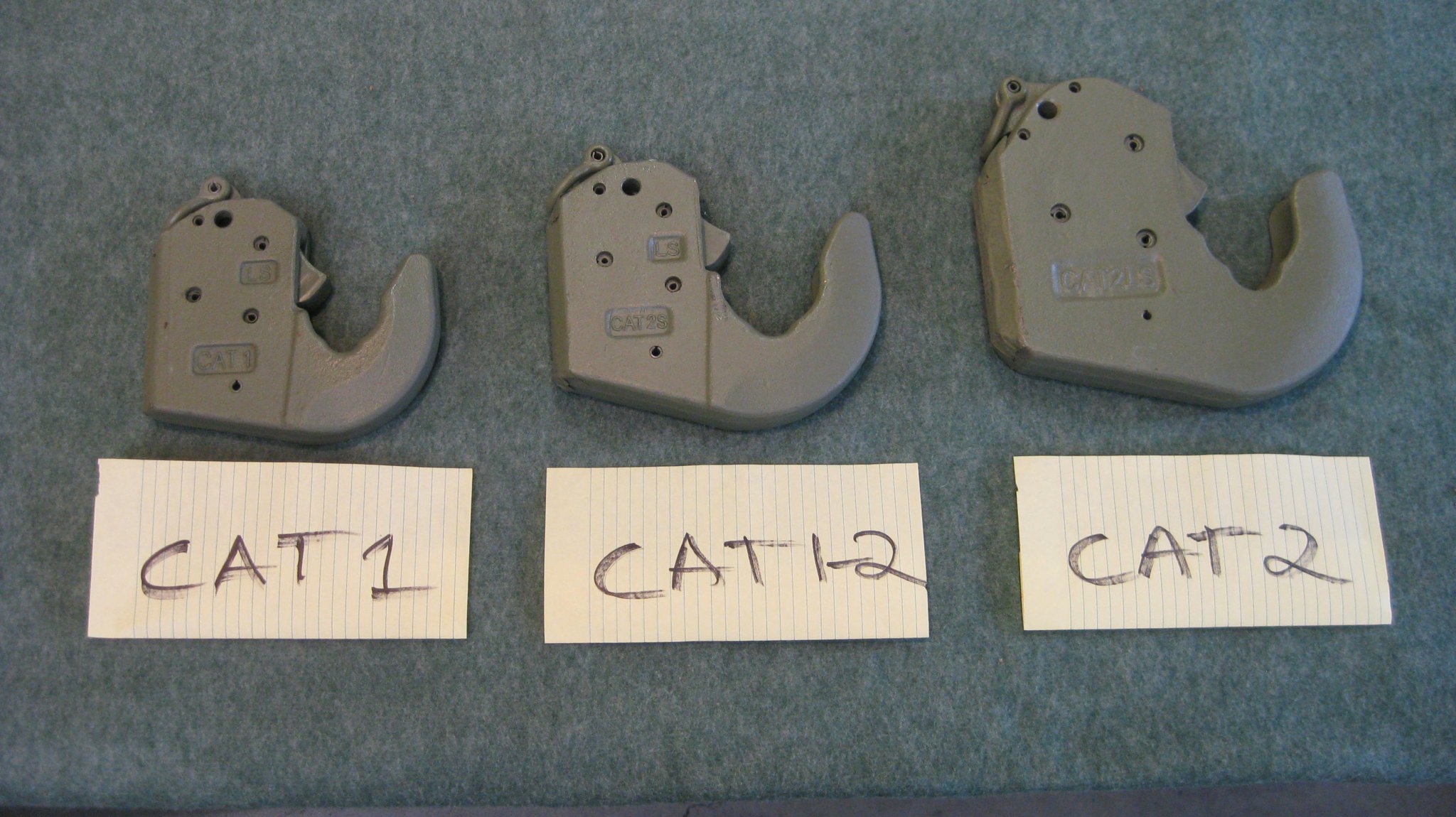

Here is a Wikipedia article containing the dimensions (I do not think there is a standard, as in DIN or ISO for those). As far as I understand there can be "narrow" Cat. 1 implements which basically have Cat. 1 pin diameter but the bar distance of the next lower category, in this case Cat. 0.

And yes, I'd love to get a welder to help out, but that's not going to happen before this haying season. So my question is whether my idea of stacking plates from a few posts back would work? And specifically what kinds of bolts would be strong enough?

I appreciate the ideas! That said, outside of both "spacers" are a bunch of complex moving parts. Linkages, drive chains and so on.
I'm inferring from all of these suggestions that my idea of stacking steel plates to widen the pins isn't popular? Any reasons why?

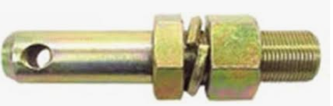

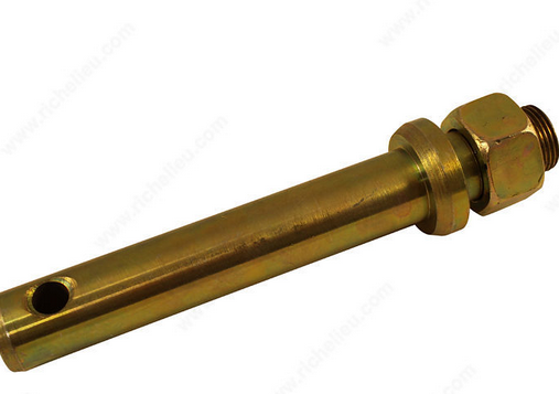

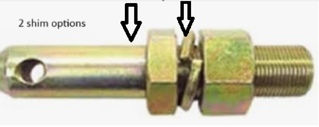

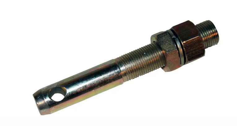

Just get this pair of extra long pins and stack plates, lock washers, flat washers, or what ever.

Update!
I got the new spacers added to the too-narrow baler. (picture of one side below).
It was a real pain to use a hand held drill to drill 3/4" holes into 3/4" steel, but other than that, things are looking really good. I just finished about 16 hours of baling and the spacers were rock solid.
The spacers are the two gray bars attached to the baler on one side and the lower pin on the other side. So you can see that the lower link is still canted in a little bit, but before adding the spacers, the lower links were severely canted in - a few times it was hard to get the ball joints to come unstuck.
