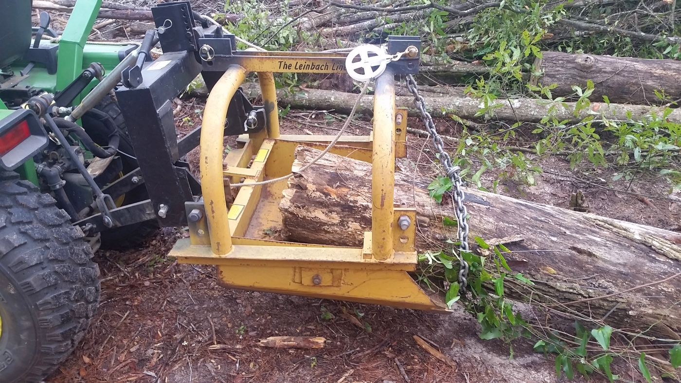

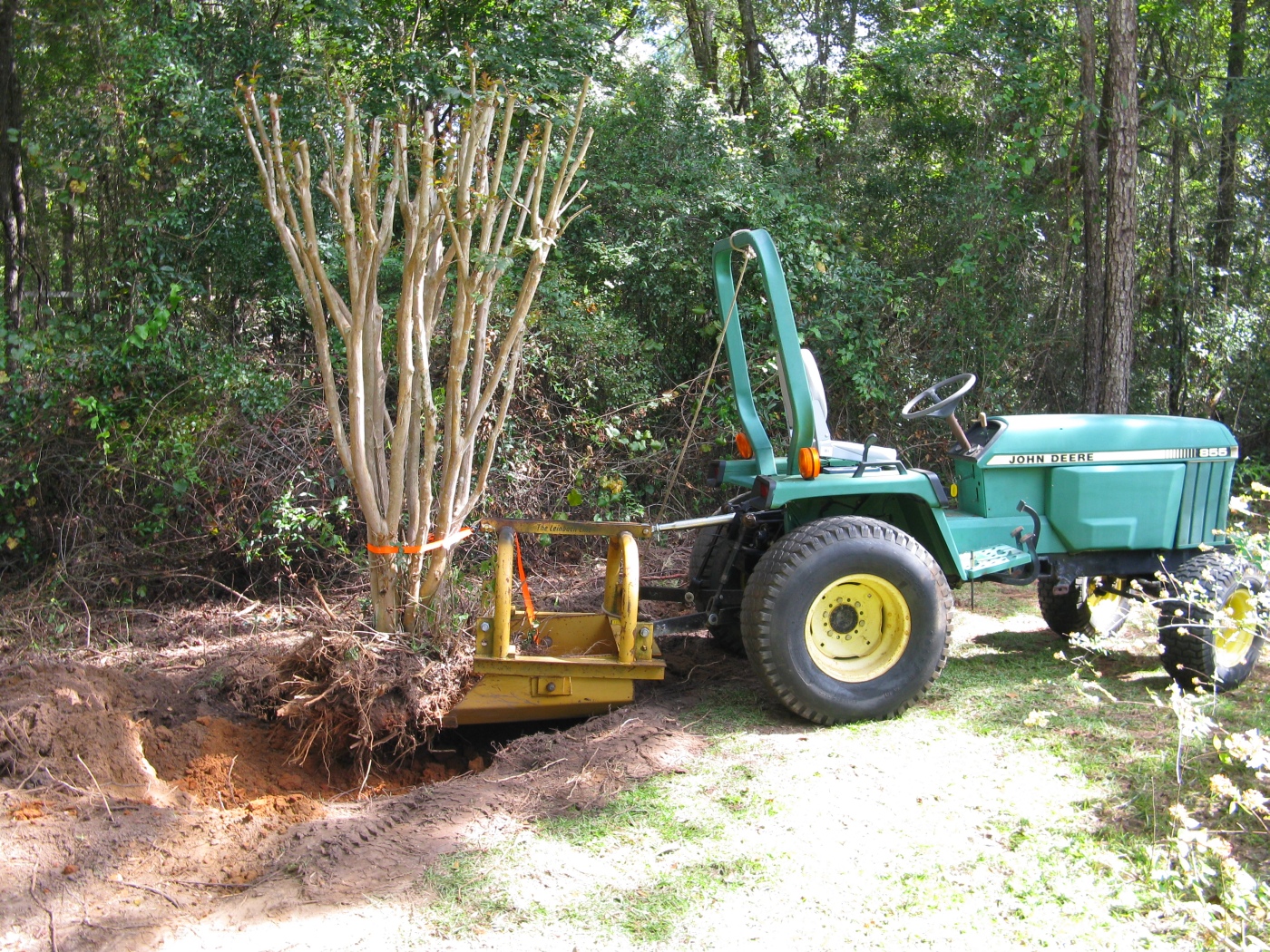

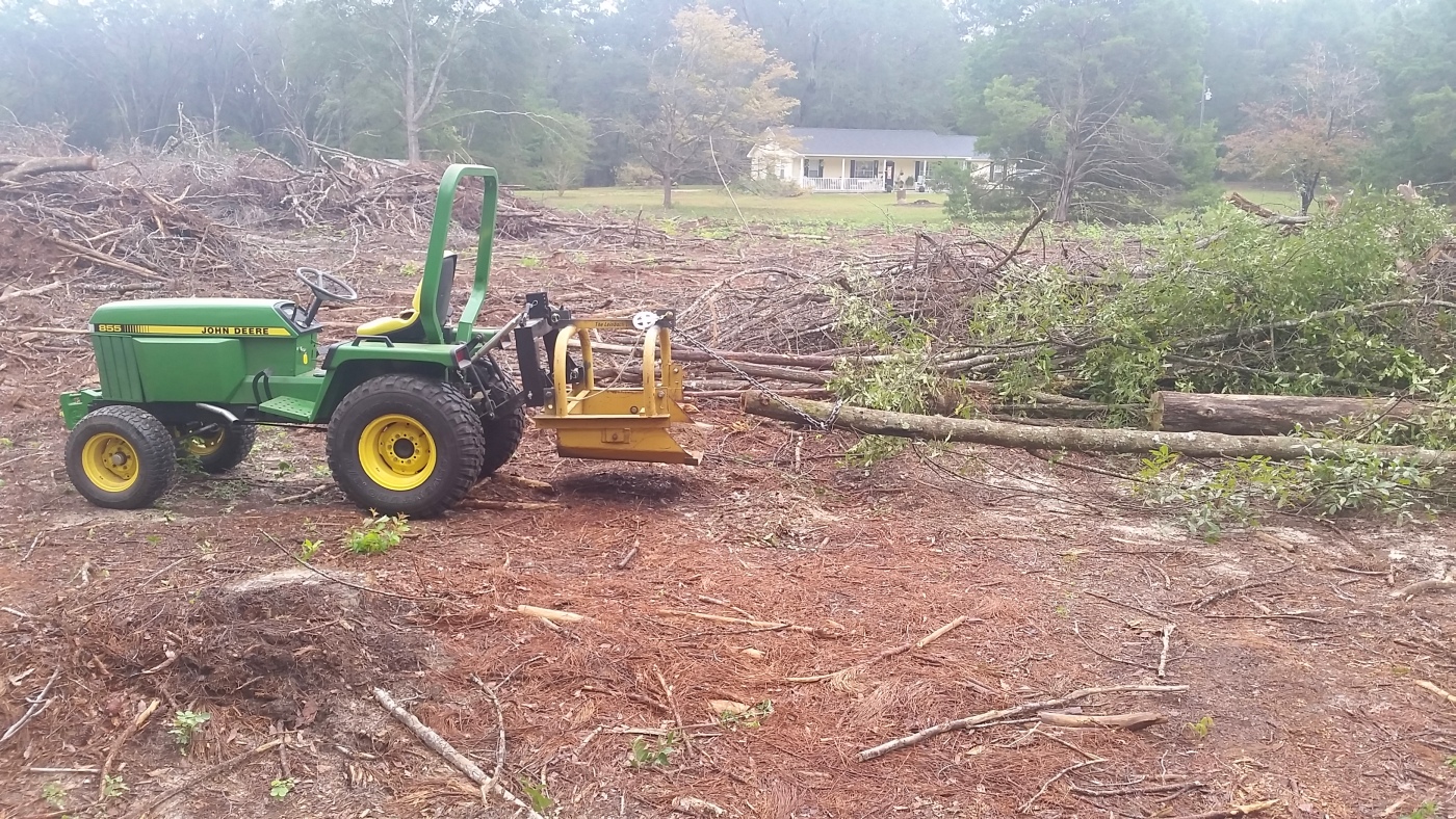

I will show my pre-grapple method one more time.
