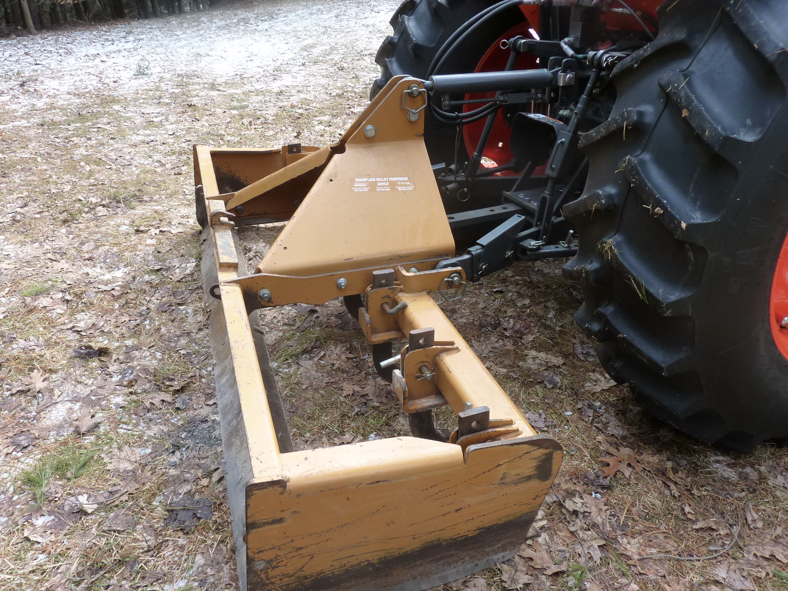

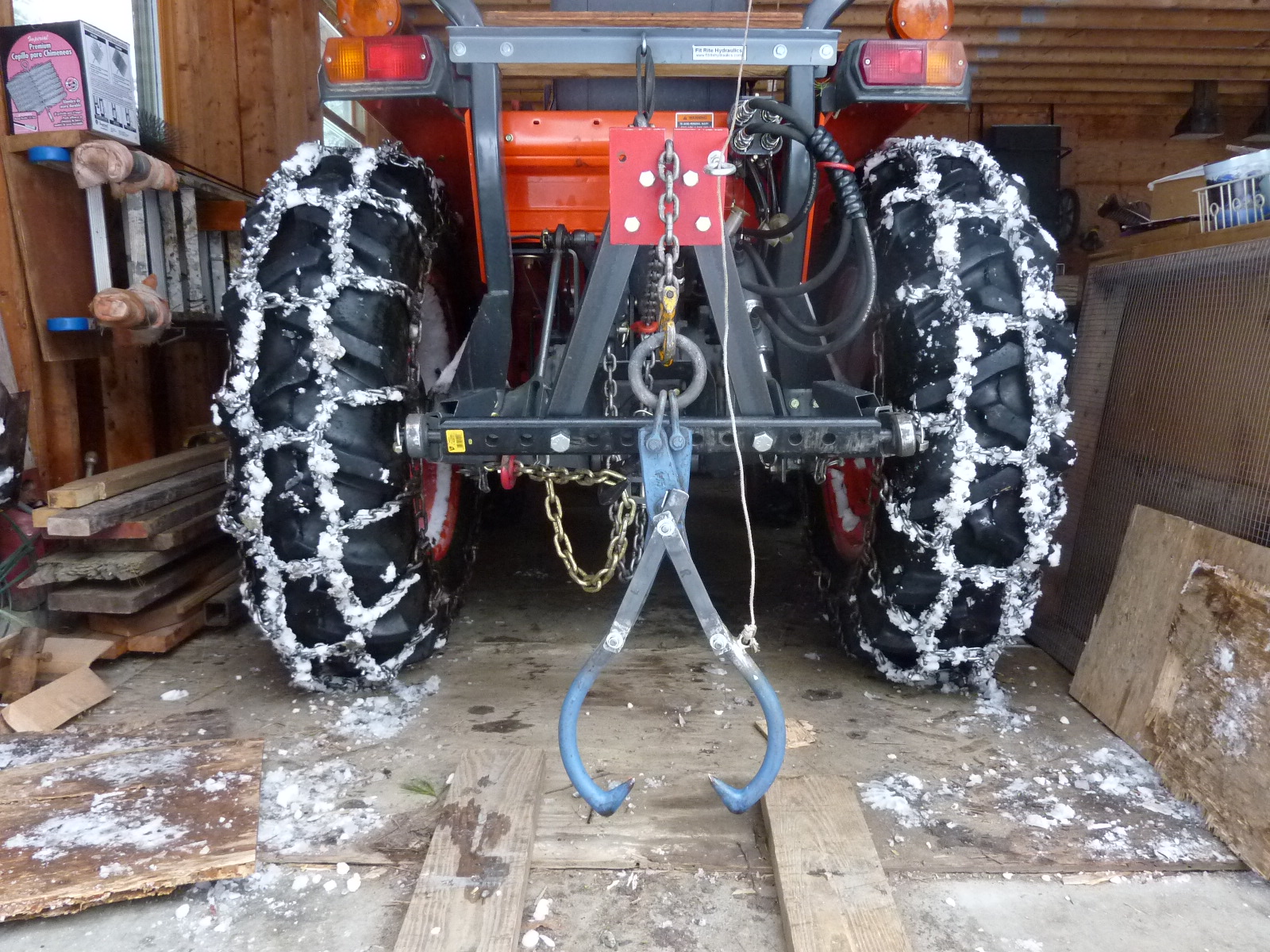

Like others have said - it is easier and safer if you can get the end of the log off the ground. Do you have an implement with a grab hook on it. Or you could bolt one on (Ken's Bolt on Hooks) maybe or weld one on. Like a box blade or rear blade.
You could also get a cross-draw-bar at TSC and make a rig to lift the logs. This is one I made but you could use it w/o the A-frame to keep it simple.
If you end up just dragging the logs on the ground from your draw bar wrap the chain on the log as close to the end as possible. If you have a lot of log in front of the chain and the log snags on something it is possible that the log will stand upright and come over on you especially if it is a small log. That is why they all said go slow and easy.

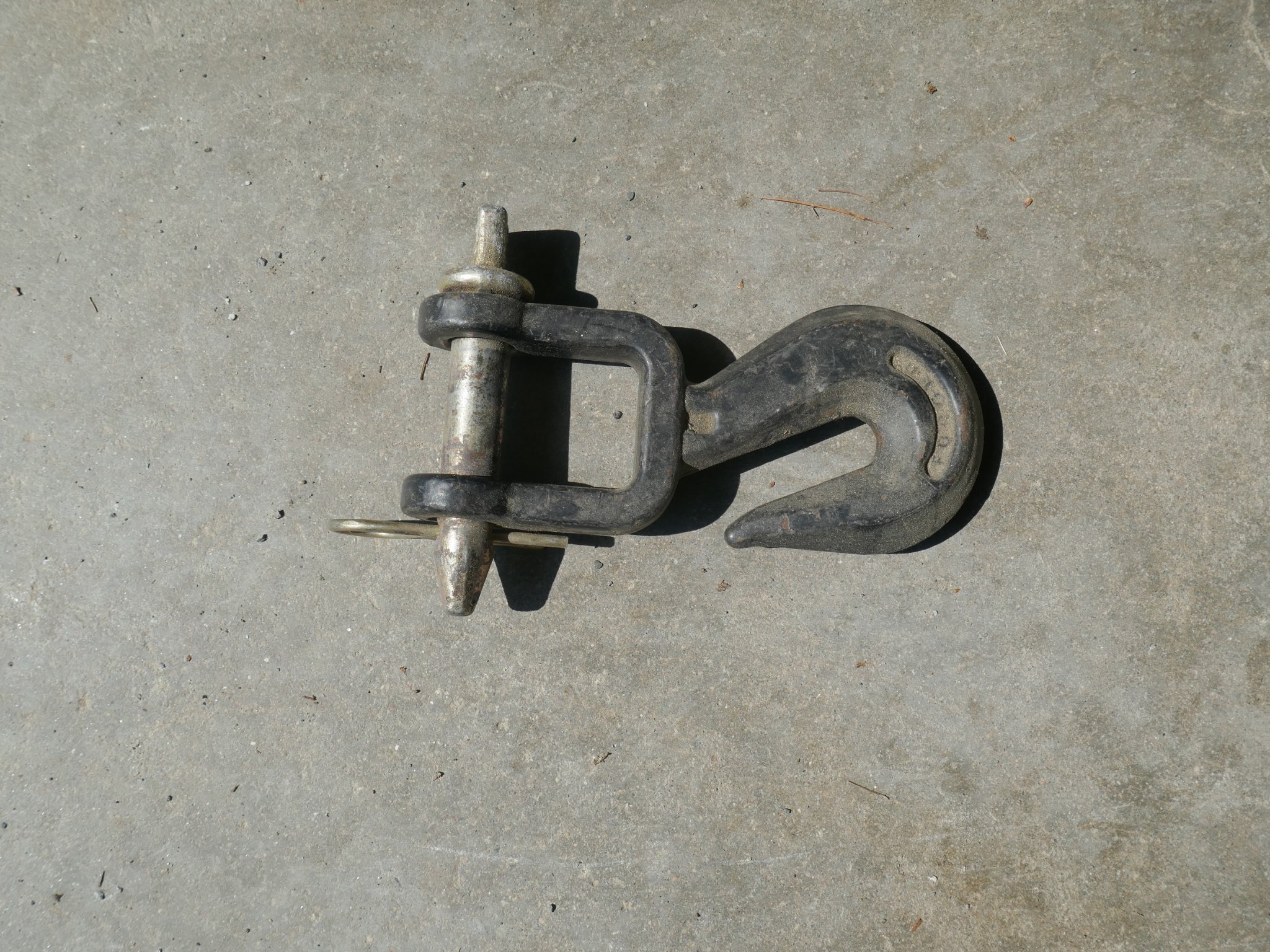

To add to the above ^^^^ If you go with the cross-draw-bar you use a tractor hook with it also available at TSC. Or you can put it on your lower draw bar.
