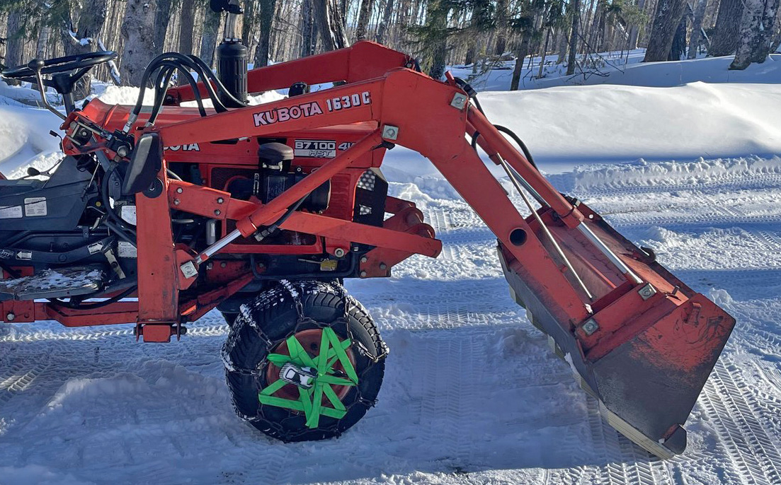

Hi Everyone, About Snowplowing in Vermont with my B7100HST:
I ended up filling the rear tires with WindshieldWasher fluid, and modifying old pickup truck chains for the front wheels. I just have the bucket and was concerned about digging in. I decided to add "snowshoe" skids to the bottom of the bucket for the Winter. They are pressure treated 2x4 material. So the bucket edge is 1-3/4 off the surface. That worked well especially for deeper snow as I could keep on without digging in. That much snow left was not problem for a Subaru/Tahoe.
But I realized I could angle the bucket on the forward edge of the skids and still not dig in. So sometimes I really cleaned the driveway up. A few photos here, but an online album with more is HERE.
Also see the Easy Way to tighten the chains and have them stay tight all winter.
THANKS for all the many Helps and Helpers here! Regards Terry

When the pieces of wood bolted/lag screwed onto the bottom of your bucket split in half or rot away,
get yourself a pair of Edge Tamers!
My blacktop driveway and lawn really appreciate the set of Edge Tamers on my BX machine!
Zero blacktop damage and almost no turf damage unless the operator does something stupid.

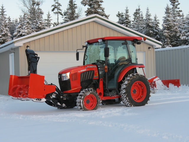

For the first couple hits of snow I used the back blade turned backwards so I wasn't throwing too much gravel (mile long driveway) then the front blower and a mason jar with water and whiskey with a screw on top so as a fella wouldn't waste any because you knew you were gonna be out there for a while. ;)

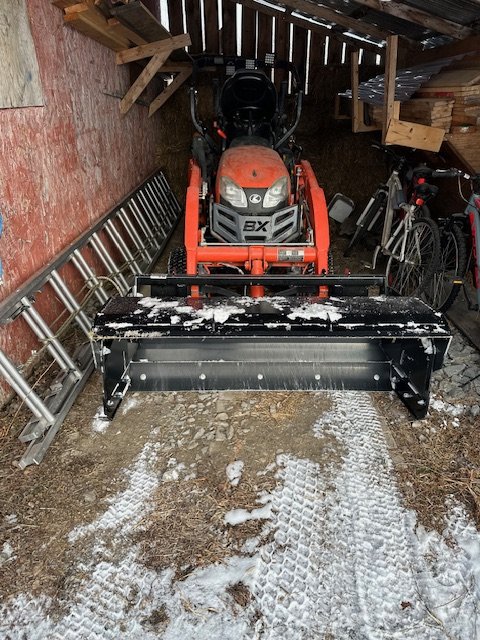

Hey everyone, first time poster here. BX23S currently with a 54" snow pusher and a box blade on the back. The snow pusher is a definite gamechanger from using the bucket. I'm currently getting quotes on a rear snowblower. I'm looking at something in the 54" range as well just to move banks etc back. Located in eastern Ontario so big storms are hit and miss. I have a walk behind 30" blower but recently diagnosed with some heart issues that don't allow me to use the walk behind now.

Hey everyone, first time poster here. BX23S currently with a 54" snow pusher and a box blade on the back. The snow pusher is a definite gamechanger from using the bucket. I'm currently getting quotes on a rear snowblower. I'm looking at something in the 54" range as well just to move banks etc back. Located in eastern Ontario so big storms are hit and miss. I have a walk behind 30" blower but recently diagnosed with some heart issues that don't allow me to use the walk behind now. View attachment 148972
Hope you have a strong neck. Have looked at 3 point blowers. Price is good but my neck couldn’t handle the constant neck twisting.
I find it helpful to turn in the seat as much as possible when running implements out back. I run a lot of implements behind both tractors so looking behind me is part of the deal, summer, winter and everything in between.

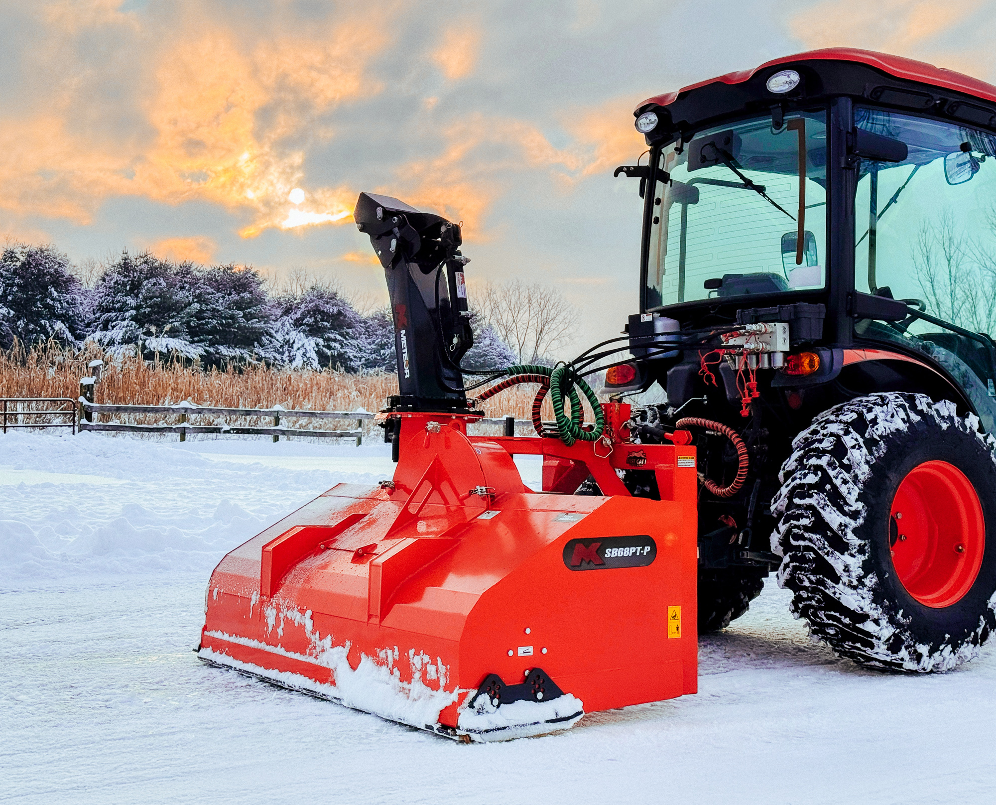

Those pull forward inverted blowers are nice but pricey. Lots of Canadian companies make nice ones, MK Martin for example.
