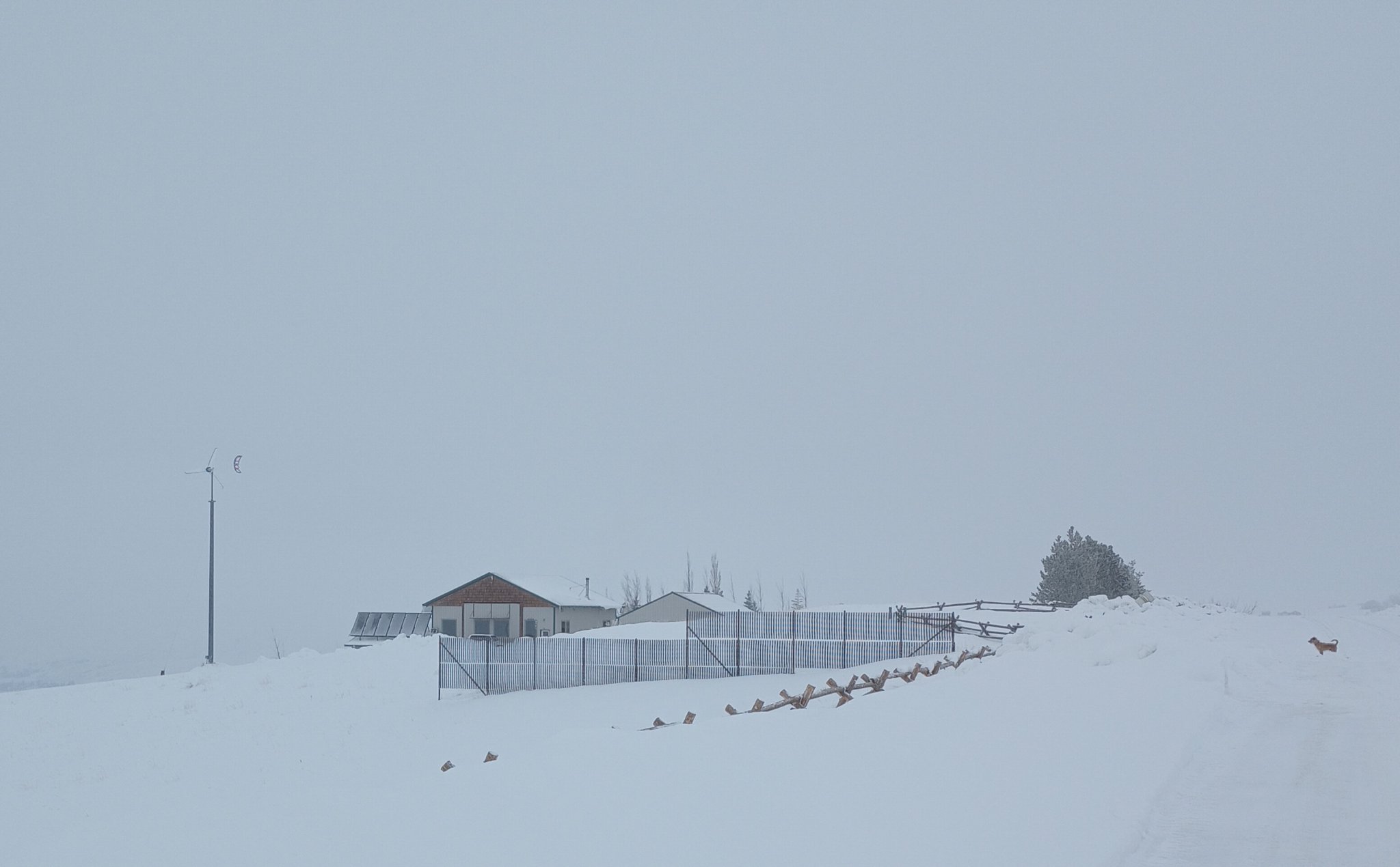

I put this snow fence up 15 years ago, best thing I ever did due to the winter winds and the agnle of the driveway. Totally acceptable in my rural area, though some may consider it unsightly, it saves me a ton of work and is beautiful!
