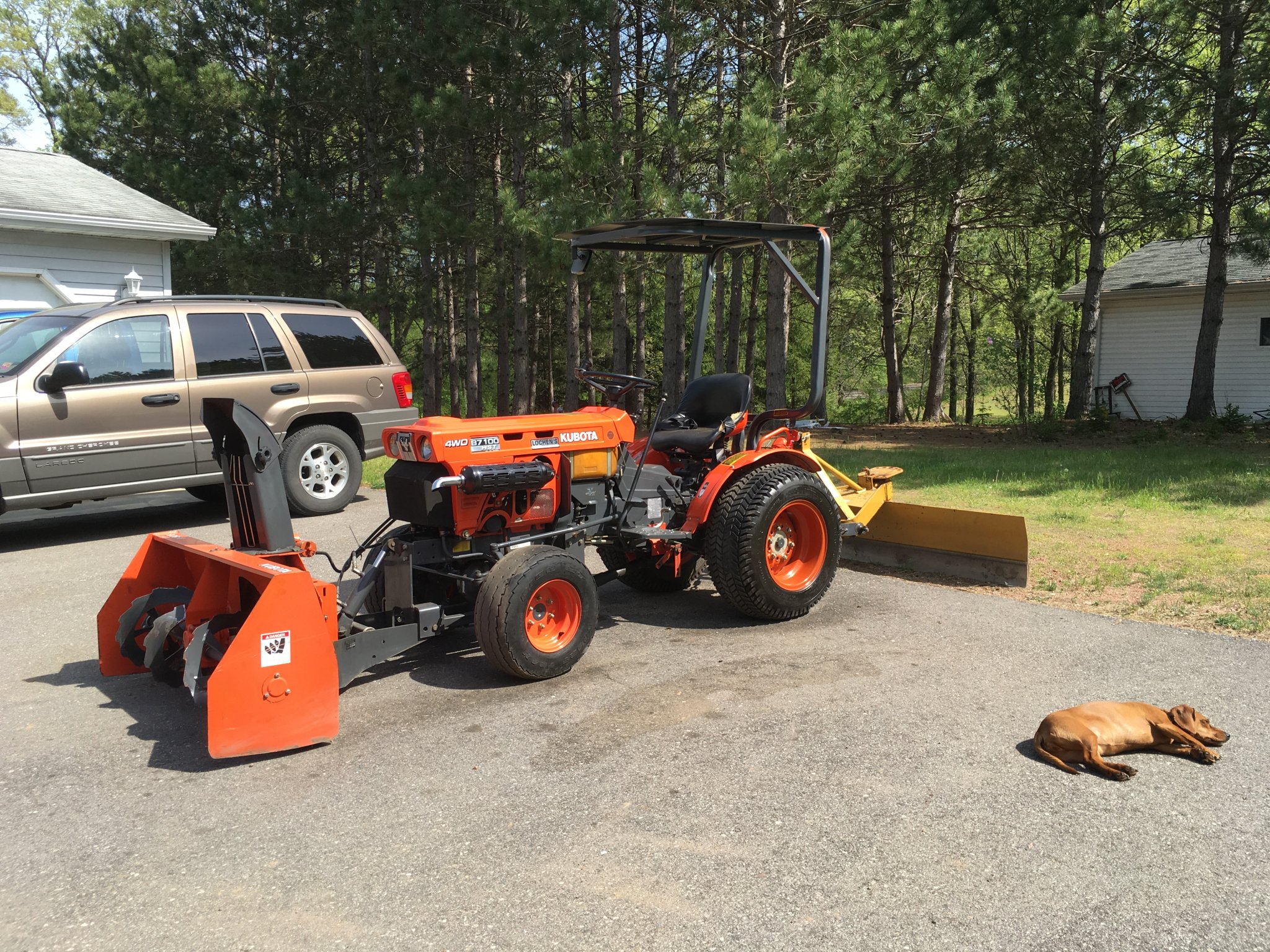

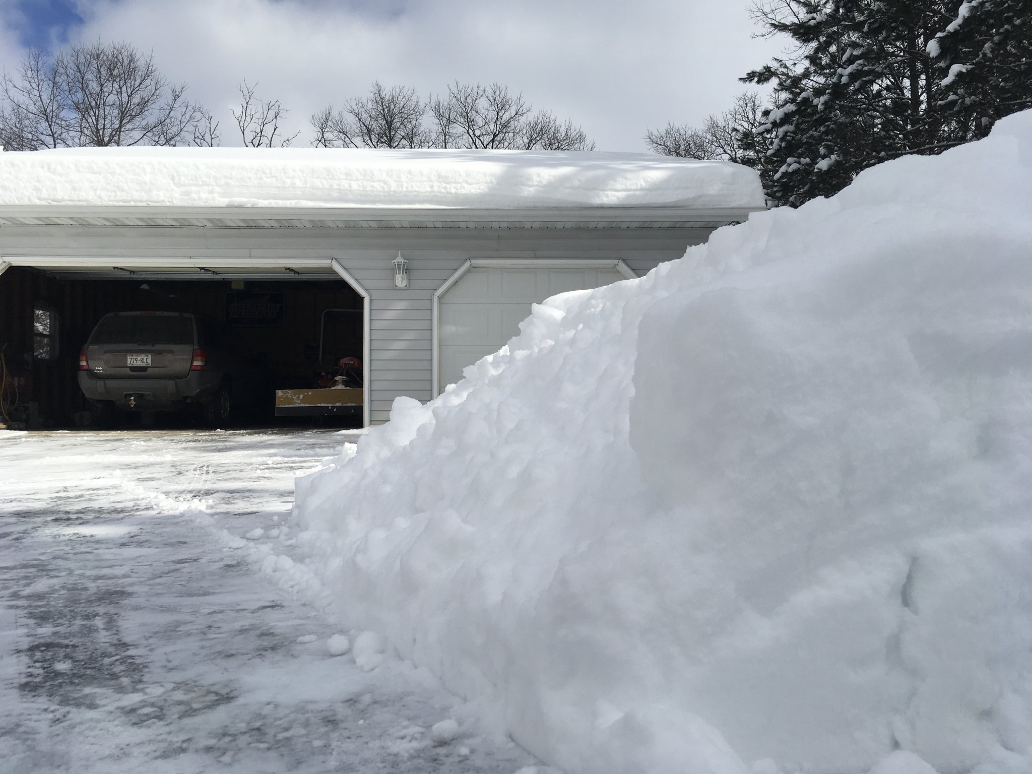

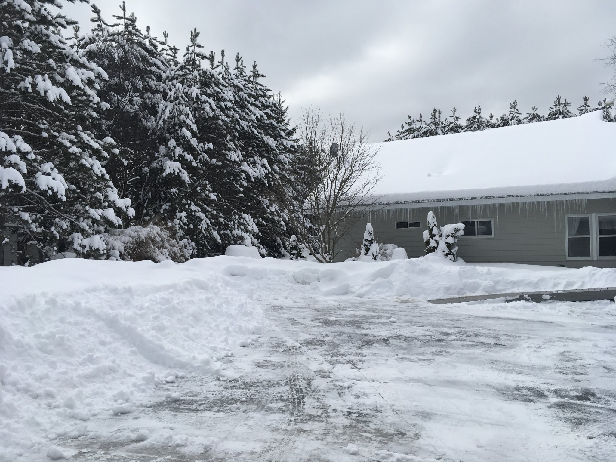

I have maintained my blacktop driveway and my neighbors gravel driveway with my B7100 with B2650 front mount blower and 6 foot scraper blade for 13 years now. Here in central Wisconsin we rarely see 12 inch plus storms, most are in the 4 to 8 inch range.
I use the scraper blade 90% of the time. I never reverse it and I can still push the snow banks pretty high. I do angle the blade and do most of the clearing by pulling with the snow rolling to one side. I use the blower for the rare 12 inch or so storms and to move banks back, clear around the mailboxes and areas that are tough to get with the blade. Heavy drifting is seldom an issue.
I enjoy the open station and fresh air it provides but I have the luxury of waiting till the storm is passed and winds subside before I start cleaning things up.
For me , with our snows , this has been about the perfect machine and implement set-up.
March of 2019 saw the snow start to pile up. The pushed up snow in these pictures was accomplished with the back blade, not reversed , pushing.

Cool set up and that's one very cool tractor. I really like the aesthetics of that B7100. The pup is awesome too! Guarding the tractor for you. :D
Thank you! I agree with you on the aesthetics! I prefer tractors and trucks to have a more "squared off" appearance but a lot of that is my age catching up to me! :)
I agree 100%. I'd much rather my MX and M had that "squared off" look rather than the rounded look. I grew up in a time when tractors had edges, not curves, so the seeds were sewn long ago. Maybe that's why I've had my Jeep TJ for 22 years. I like the boxy look.

Looks like the guard dog is asleep at his job. It's tough being a dog guarding a tractor all day without someone coming by to play with him.

@ken erickson that IS an awesome looking tractor (& attachments) looking to be in very well maintained condition! (y)
