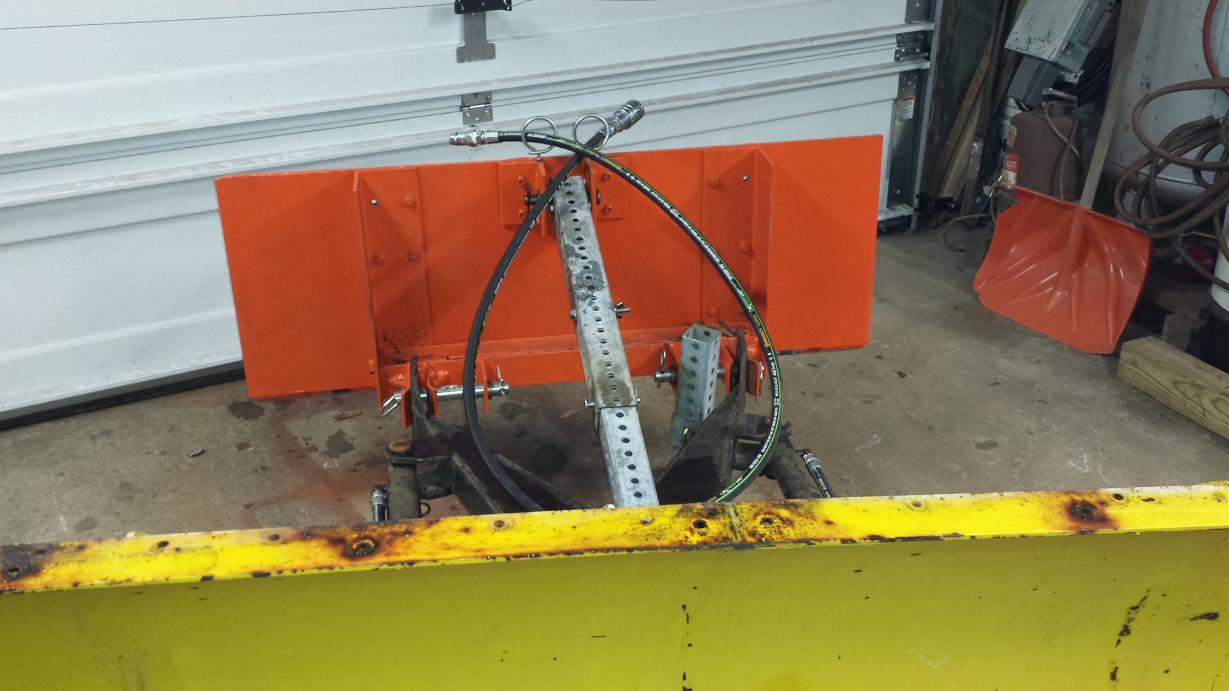

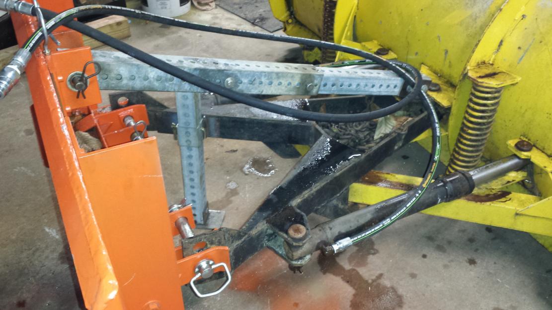

I made my own snow plow for my L3901HST w/3rd function. I’m too cheap to spend the dollars to purchase one already made and I need projects to take up my spare time.
I acquired a well-used 7-1/2” Fisher snow plow from my son’s friend for zero dollars and removed the pusher brackets from an old 1970 Scout I have. I attached it to a Titian SSQA plate, added some scrap steel, fasteners and some welding. I purchased two Hyd hoses, quick couplers and pins for a total expense of about $225 bucks. I made the plow assembly with a stiff hitch for back dragging, pull the pins and it fully floats.
There it a learning curve, some instances the tractors loader float functions works well, in others it does not. I find the more forward tilt I have to scrape the surface the more the float function does not work well. The float function seems to work well while angling the plow since the cutting edge is covering more forward travel distance, rather than parallel to the direction of travel. Soft earthen driveways are and issue with every mode of snow removal, before spring comes I am going to modify the disk shoes on the plow to triple there foot print in an attempt to float the plow on softer ground.
I always push the first passes straight to the end then I finish by angling the plow to clean up the spillage and edges. Front chains may help the front end from skidding but I also plow a paved drive and do not want to damage the coated surface with chains.

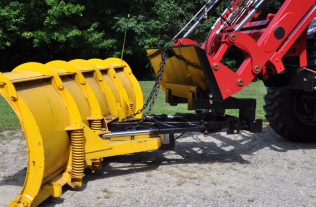

I'm gathering pieces for a front blade right now. Everything is falling into place for a tentative start later this week. The design will follow Wildfire / Paul Short's design but at this point the blade may be suspended with chain like the one that TractorNH on another board made. A picture of his is below.
The blade I'll be using is also a Fisher with the bottom edge trip. Since the A frame is higher with that design, the rear set of skid shoes that Paul has on his shouldn't be necessary.

You will like the Fisher Snowplow with the cutting edge trip, they are great plows. Mounting the attachment plate directly to the plow rigidly is the simplest way to do it, but unless you are plowing a flat, blacktop driveway, it takes a lot of work to keep it following the contours of the ground. I put together 2 of them, 1 for my B2920 and 1 for my fathers B7500. I took 7-1/2’ Fisher Plow and cut it down to 6’. I mounted ears on top of the A-Frame just behind where everything pivots and used pins to mount the quick attach adapter. Then used the original chain to hitch to the top of the plate. This way the plow has flexibility to follow the ground if you keep slack on the chain.
