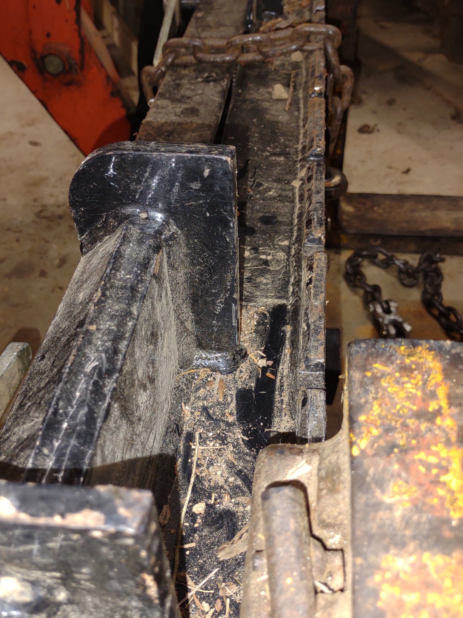

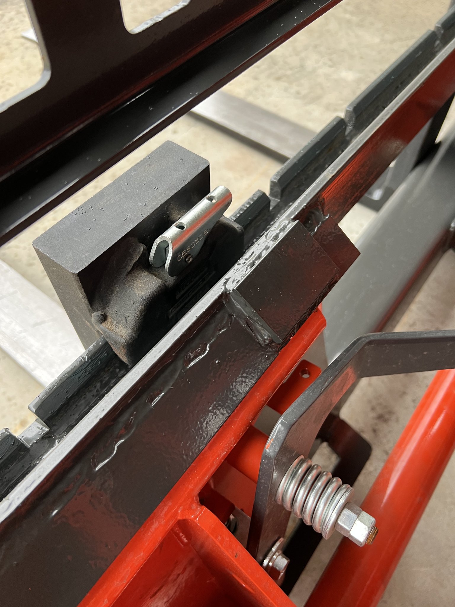

I'll measure it later. The top is tapered, it can only be so thick and fit in the fork bracket. It also has some additional meat further down. Looks very similar to the picture of the Pro Works.
The notched top bar is about 1/2" thick, beveled to 1/4" at the top. Behind and below that is a 3"x3" square tube. (It's from China, so dimensions are approximate.) The third piece is the SSQA adapter cross piece angle. Not shown is the back stop, it doesn't have one :) .

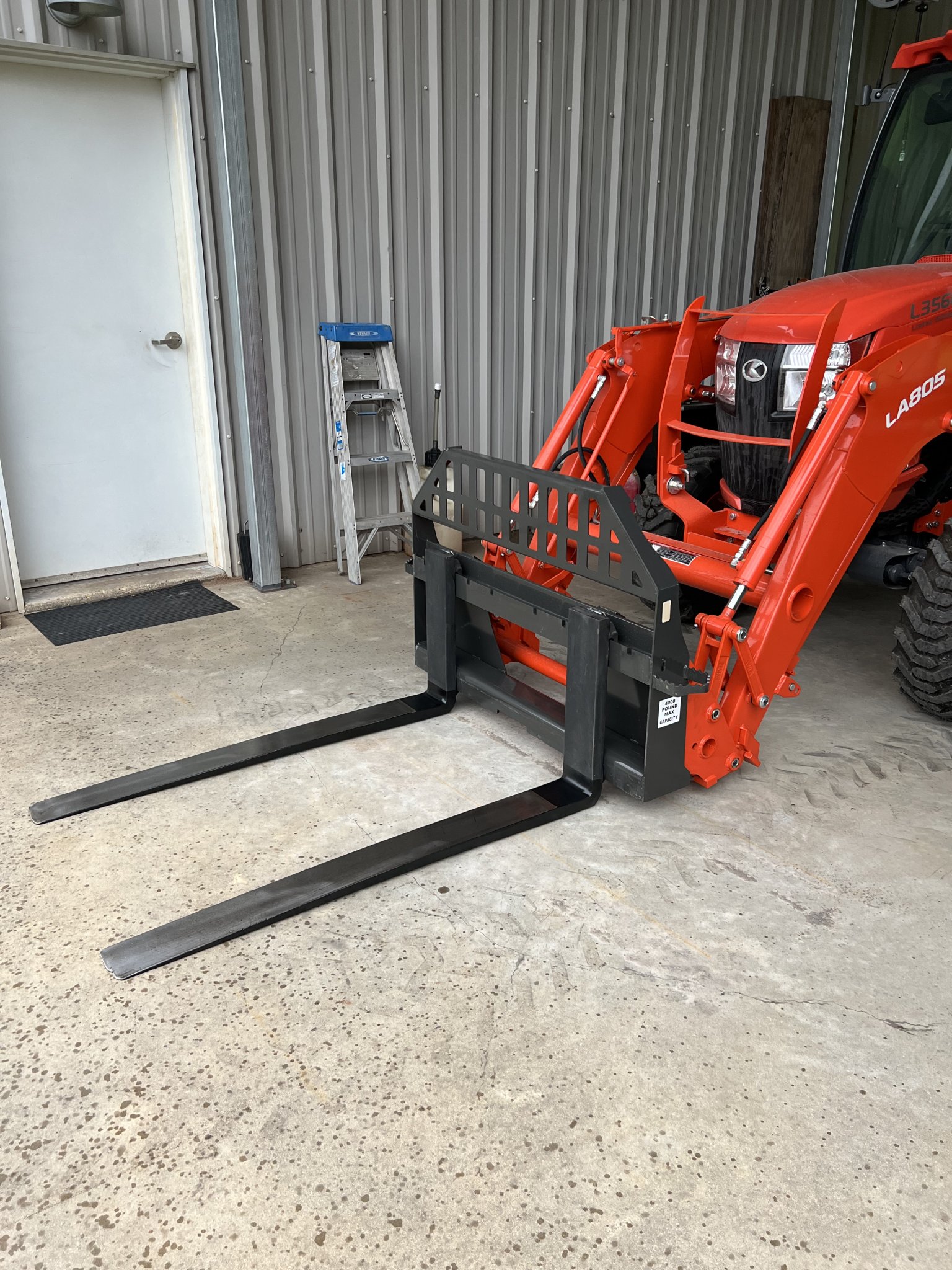

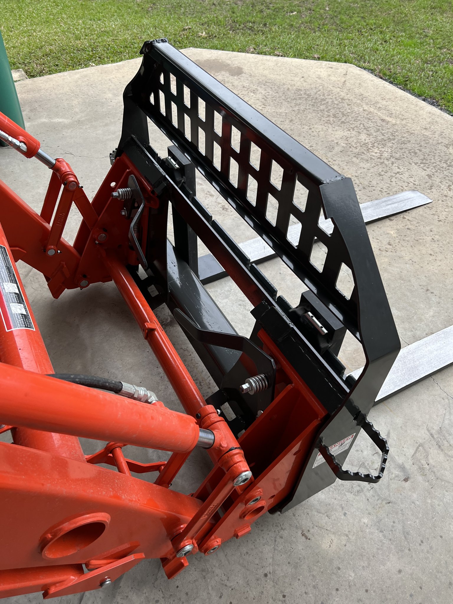

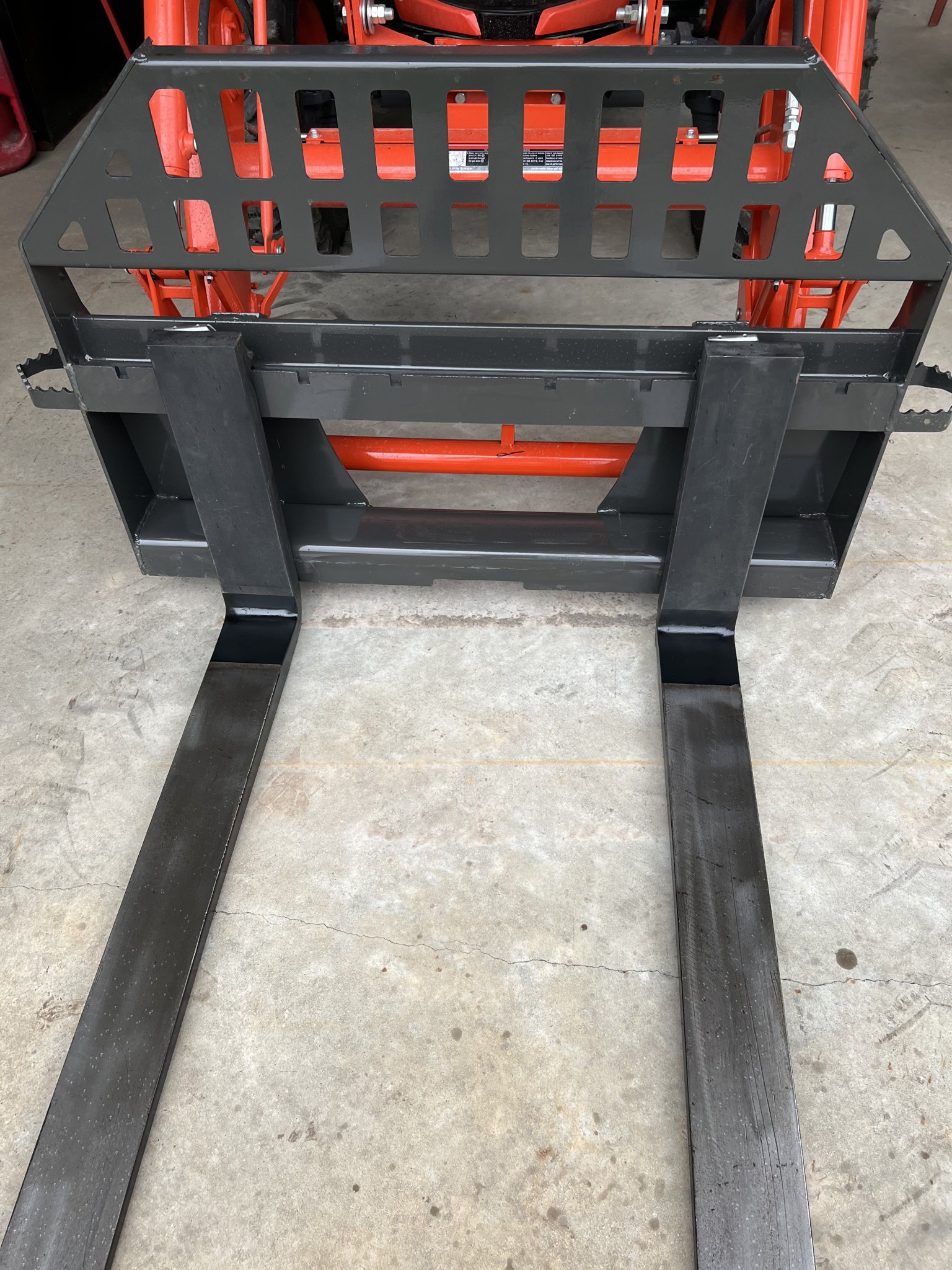

Made a trip up to TractorMax to lay my eyes on the ProWorks frame . Upper rail was indeed 1/2” but the overall fitment and welds really didnt impress me . Looked at a few other brands that were available and settled on CID X-treme Attachments fork frame . Fits great and the powder coat is close enough to Kubota gray. 0D09CFC5-4E95-4ABC-B8A2-184E977E5026.jpeg 50F38E59-2ADE-47A2-8C7F-636BA18172A6.jpeg BD772316-E317-46B0-8A55-B53BC7BBDAC1.jpeg 0DA3377D-2526-4D91-8CC5-352125526D20.jpeg

Steps are good.
Fork backs being very proud of backstop....not so good.
