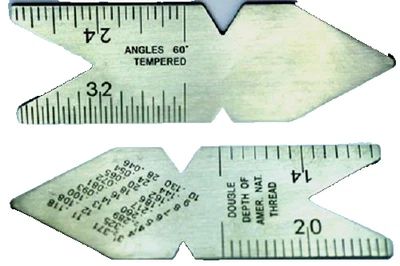

Now that we have that out of the way, my first thought is that your tool is not set up right. I believe standard threads are 60° and the tool (cutter) has to be at 90° to the work. They make a little gauge for checking that:

But after seeing @PHPaul post that pic of that tool, I did forget to use that. However I did square up the toolpost to the lathe chuck using parallels.
