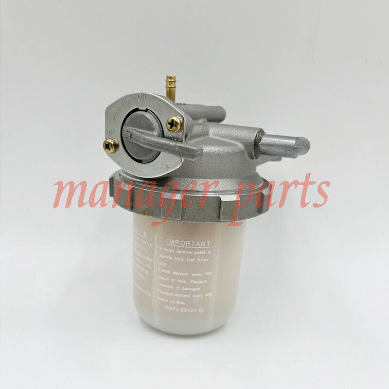

I had a similar issue. Condensed version. Loss of power under load with no smoke associated. Fuel filter bowl full. I replaced the fuel lines after the filter with clear tube and could see air bubbles. Replacing the fuel filter assembly fixed it. YMMV
Did you replace the water separator assembly or the spin on fuel filter assembly?
