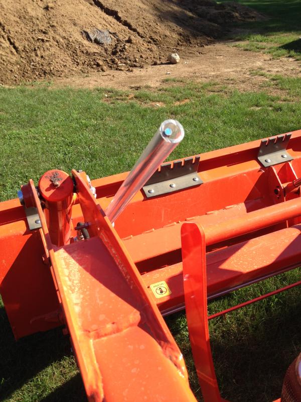

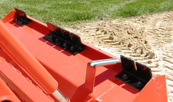

I took a different approach to hooking the chain. Instead of hooks, I took some pieces of angle that sit against the back edge of the bucket top and cut slots for the chain. They are a simple bolt-on install. For the slots I drilled holes in the angle at the top edge of the bucket and cut in from the top edge of the angle to form slots. The chain drops into the slots. Easy to adjust the amount of chain for the load. Extra chain can be draped in the unused slots. These worked great on my B7500 so they became the first mod for the L3200.

Cool idea Chim.
I'm curious to see if the bigger tractor will bend them if you really get in a hard pull.
Can't say that it isn't a valid concern. I did use the B7500 to lift anything the hydraulics would handle. That included the rear of the tractor when I brought a bush hog home on a trailer. The bucket on the L3200 seems pretty sturdy and the load is spread over an area at least as large as the bolt-on hooks. It has endured some fairly heavy loads so far without any bad effects.
