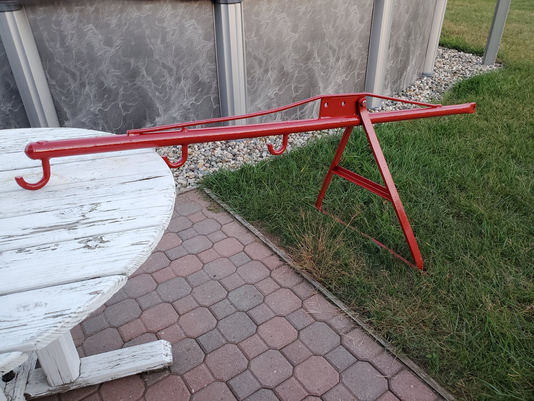

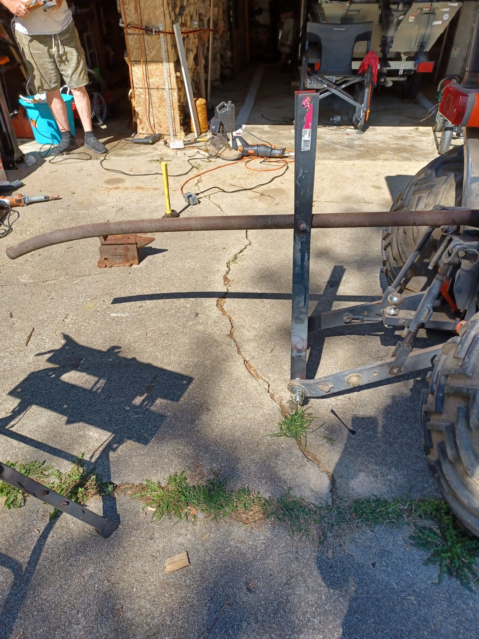

Remember as you move away from the pivot point the AMOUNT you can lift will decrease proportionally.
If that hole is through the pipe - that will be the first place it will bend or break once the load gets heavy.
Thank you. It's already been tested at 300 pounds and that is our target weight

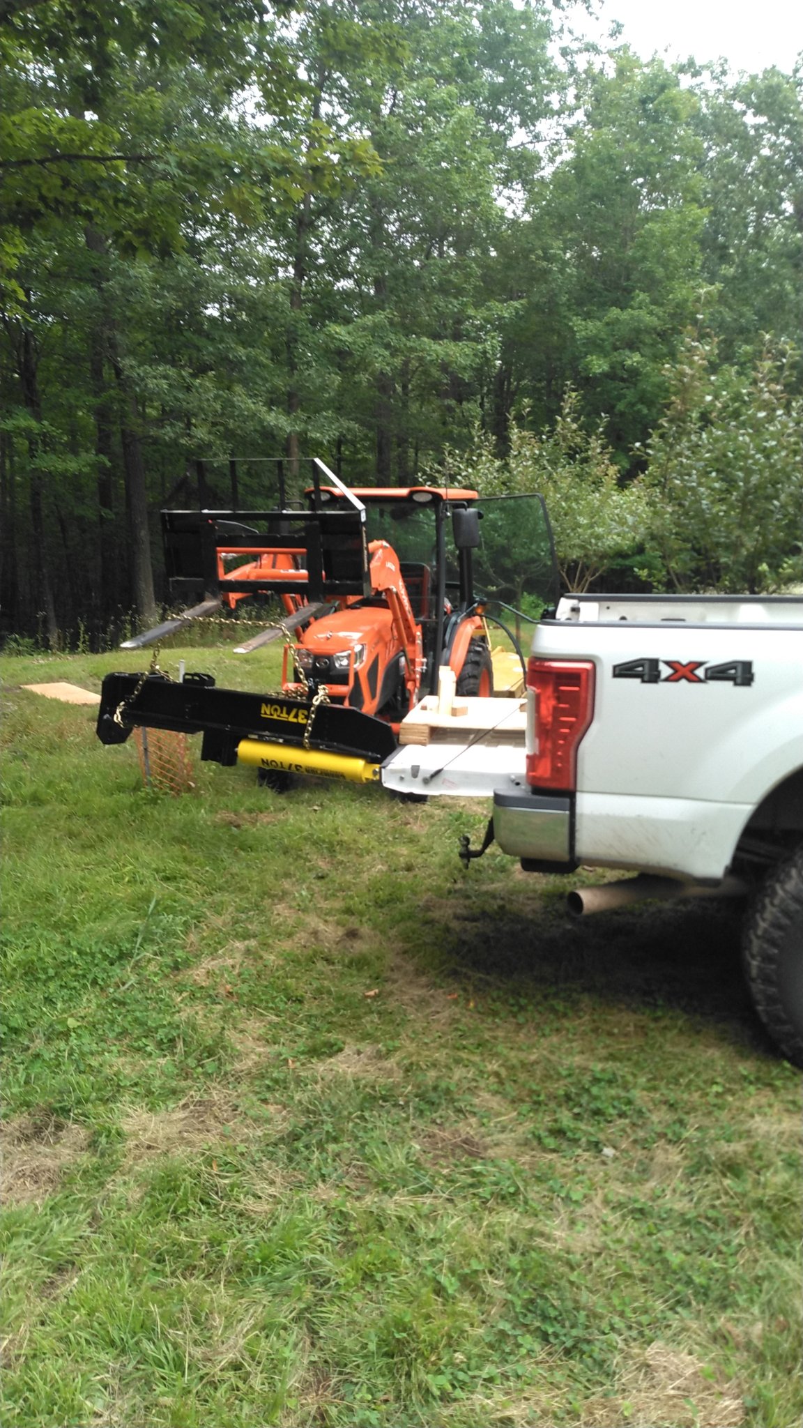

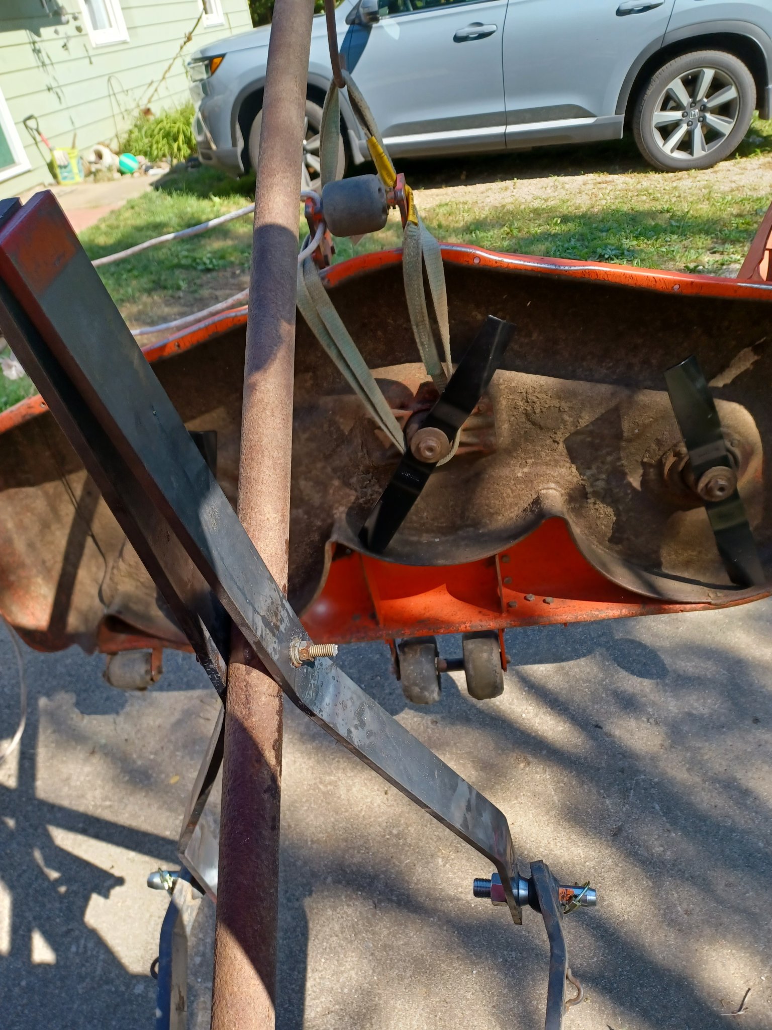

It picked up our belly mower so we could take it to our barn. Worked good but then it started to rotate. Dangerous, will have to find a solution.
Rope on each end of the deck, tied to the relative side of the tractor.
Be careful
I'd advise no one standing near. No offense, thats a risky contraption.

I use the loader, forks, and some chain. And a big long ballast.

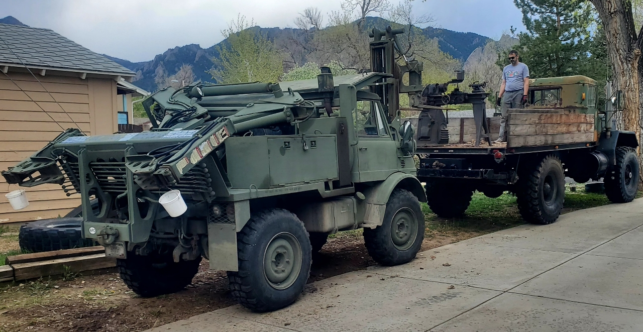

And a friend of a friend brought his forklift-and-boom-crane variant to help fetch my lathe out of first friend's truck:
Yup, needs triangulation. Rigid triangles are your friend. See @mcfarmall post of the old time 3 point boom. I’ve got one, but not that pretty (it matches my 8N). Now that I have a modern FEL and pallet forks, the old boom will probably quietly rust away.

Mower deck transport is sketchy. They swing every which way. For PFs, four short ropes looped each end. One on each deck wheel, four loops to the forks is how I'd do it. Keep the deck as close to the forks as possible to eliminate swing.
Or, spread the forks and pick up the mower like a pallet. Put a ratchet strap on it too if things are going to be less than smooth.
Griz
Why didn't I think of that?
Excellent idea.
(actually, for this particular "move" I was leaning the deck up against my shed and didn't have confidence in my PF SKILLS" that day, just after I got my forks.....so left very little to chance.

You need a triangle for the mount, not two independent arms.
Like others have said copy the above boom pole design.
