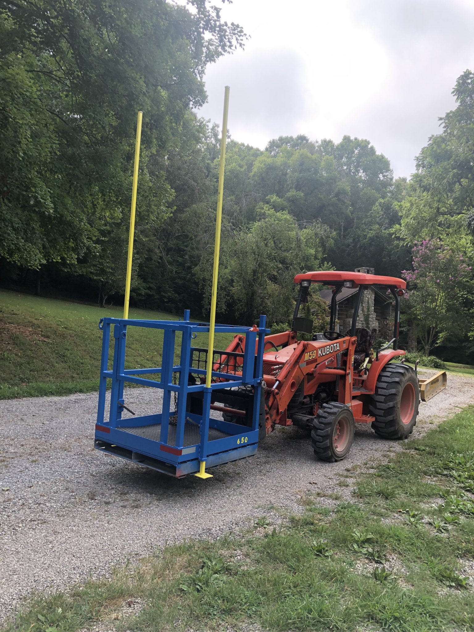

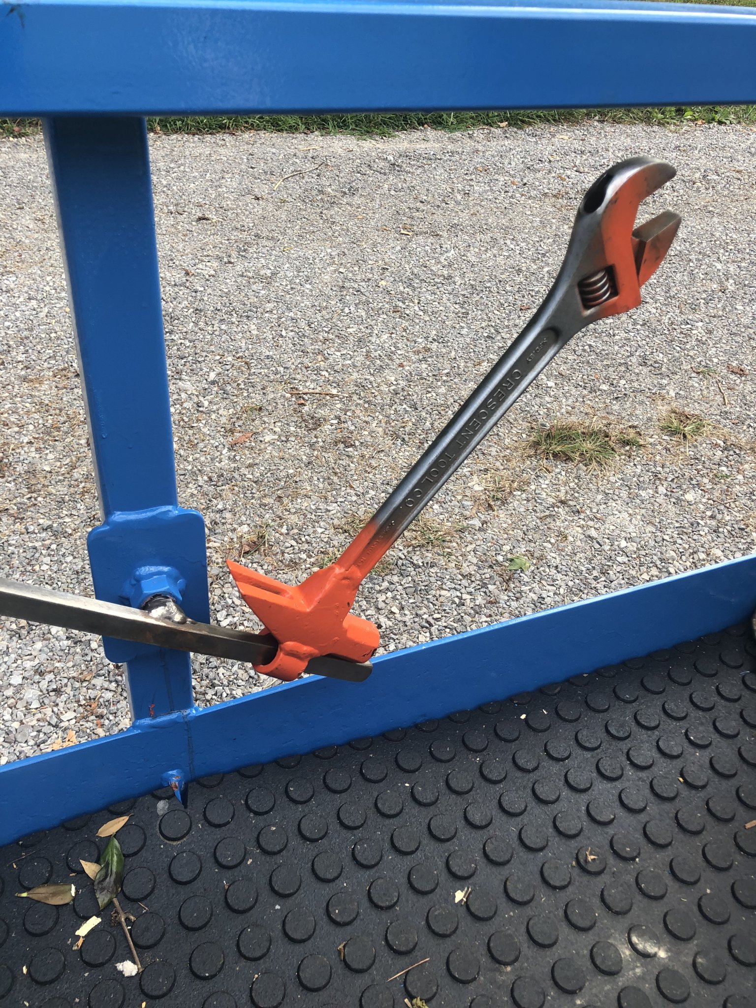

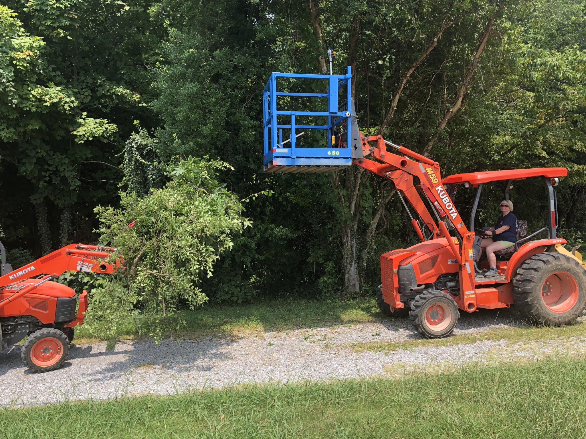

Made my man basket. Study enough to hold tools and chainsaw. Even use it for sawhorses. Wife is a good operator when trimming trees. Made adjustable safety poles to support the basket it case of hydraulic failure. IMG_1943.jpeg IMG_1951.jpeg IMG_1952.jpeg IMG_1953.jpeg IMG_0390.jpeg

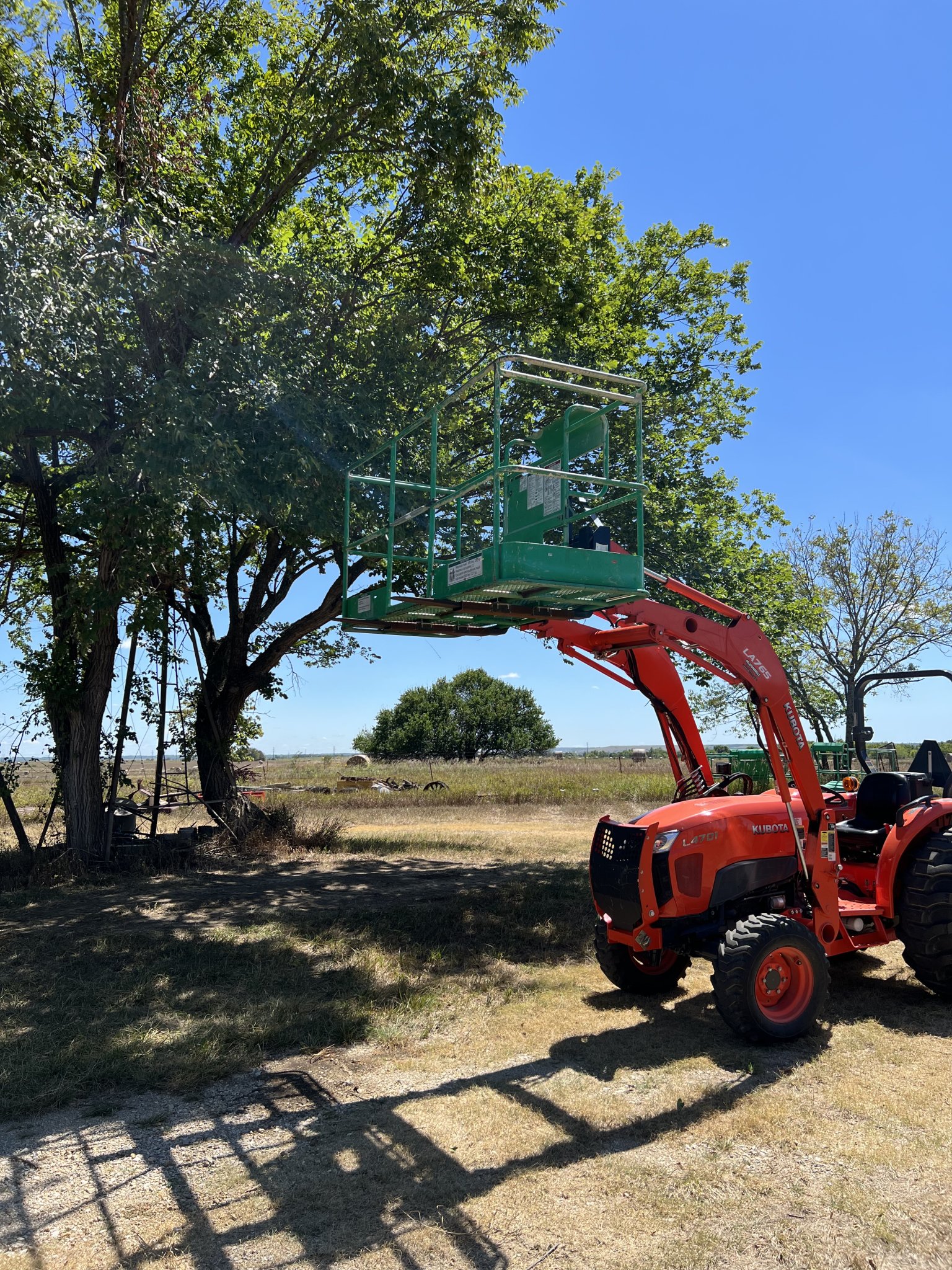

Gut one of thos 300 gal toats the top was cut out . the company that was selling them $50. for un cut talked the guy down $10 after he put it in my truck said O gust take it. Works great have trimed sum branckes but realy got it for picking fruit from my trees.

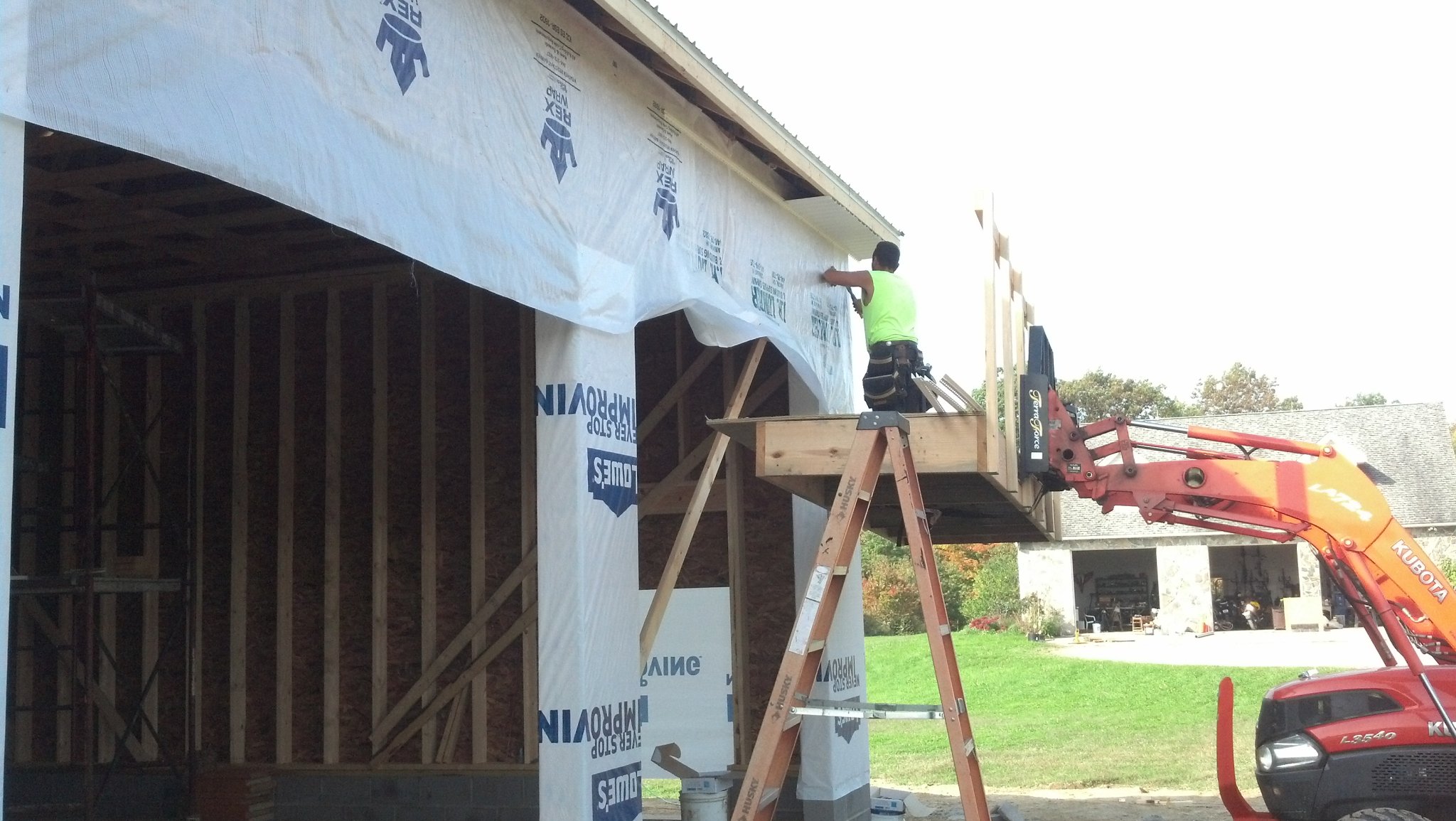

To the OP, if it makes you feel better I had a customer whose house we where framing several years ago when I worked for my brother lift me up on nothing more then a pallet with a peice of 3/"4 plywood on thetelehandler forks to do the house wrap. She was a fairly novice operator, I would put the machine in postion so she just had to lift me without moving the machine she would raise it up I would do as much as I could she would lower the boom I would maneuver over to the next section rinse and repeat. So... things are only as "dangerous" as you make them
