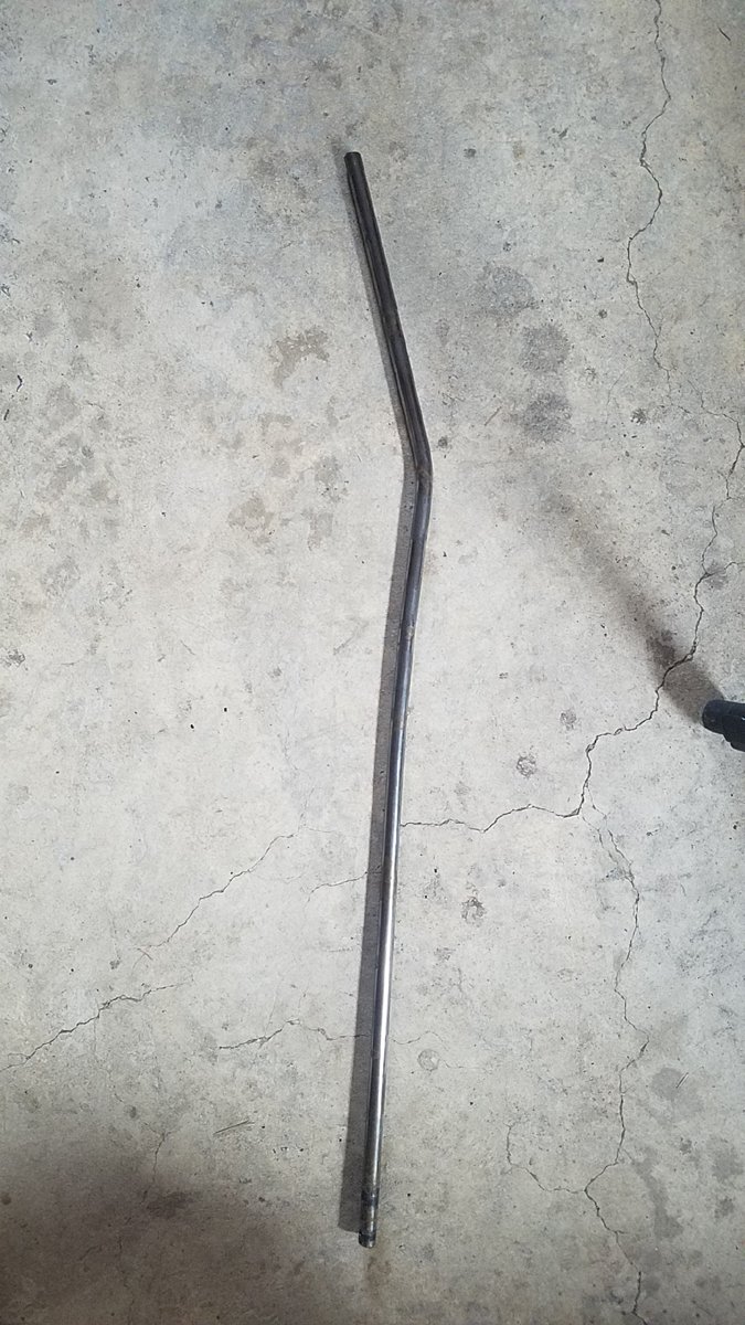

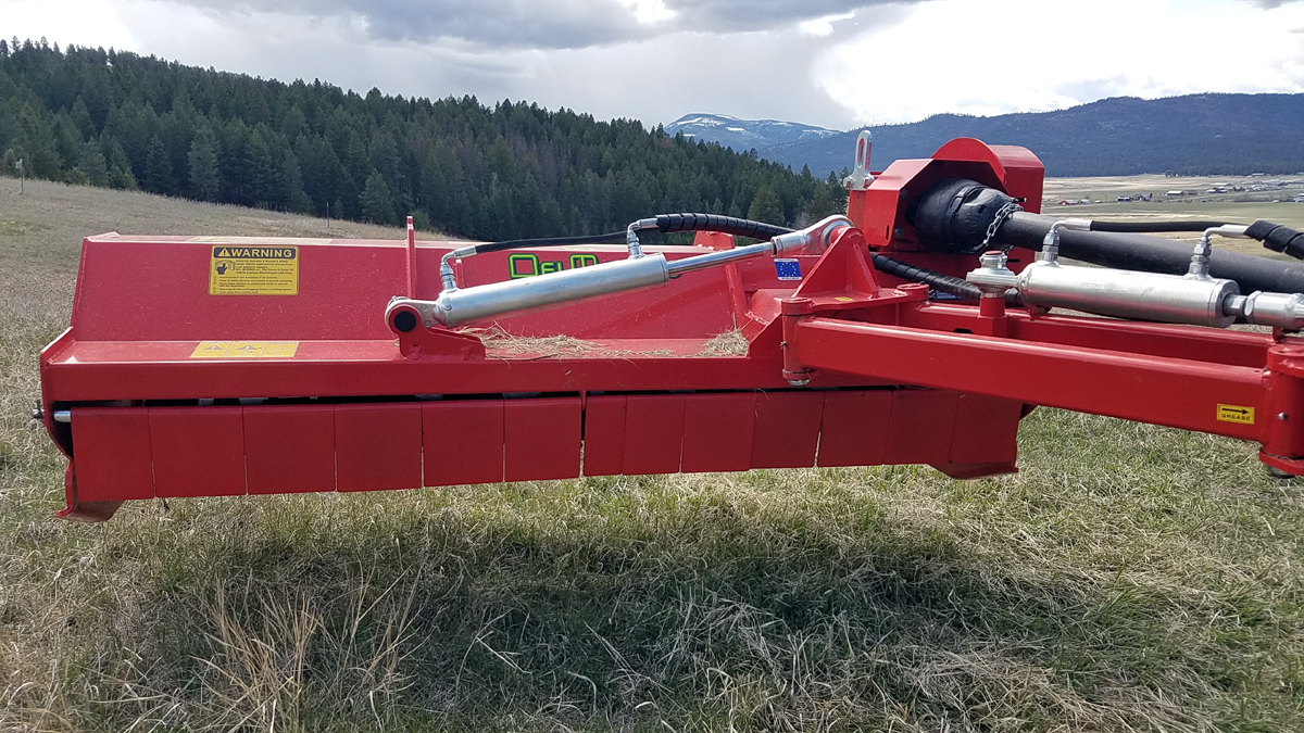

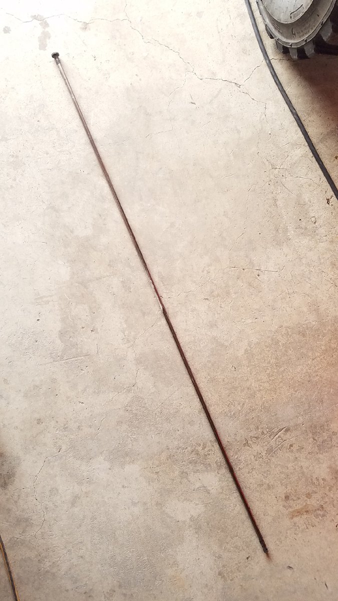

I managed to do a temporary fix on the bent rod. I had to cut it in half while still on the cutter in order to remove the guards from the rod. I bent the damaged section of rod enough to get two of the guards off that were jammed on there.
Then I straightened the bent half as best as I could, beveled the ends in preparation for welding, welded the two halves back together, cleaned up the weld and reassembled the guard system.

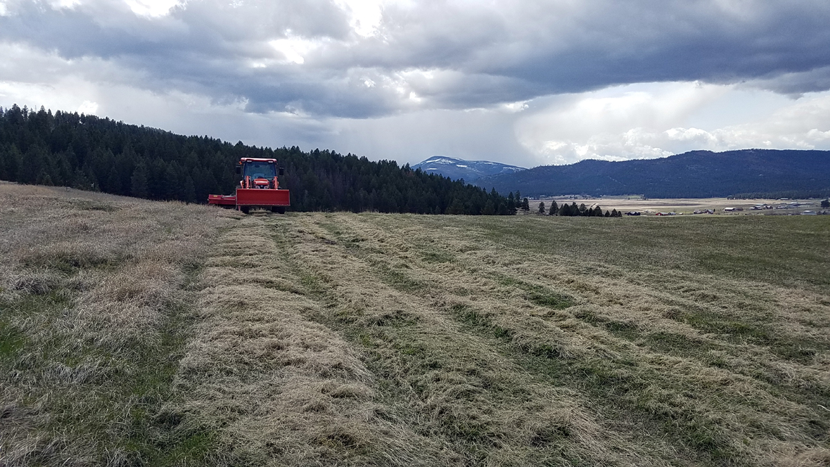

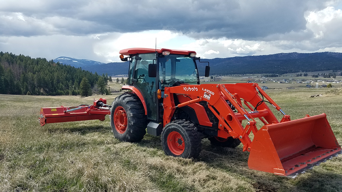

The I used the flail for the first time and there's a learning curve for sure. It did a good job with the cutting height set to maximum which is about 4". There's a lot to think about when running it such as adjusting the head for the terrain, and I kind of wish it had wheels rather than skids. So far so good though and I can only get better at running it based on today's first experience.

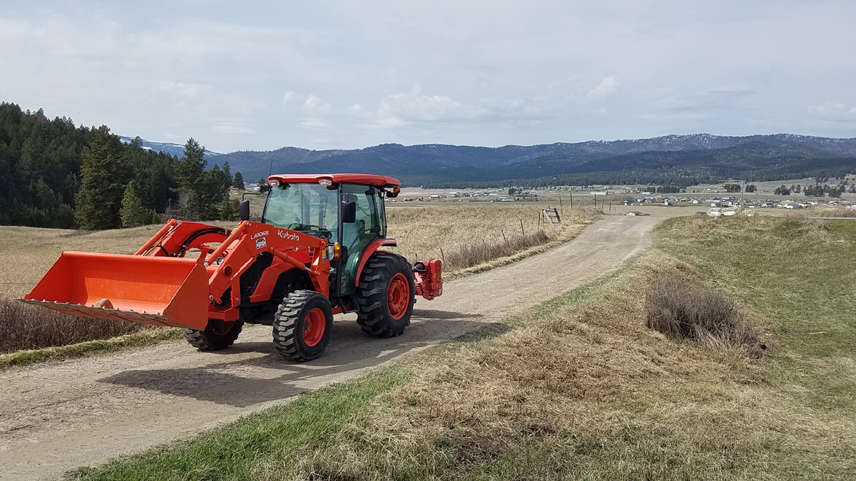

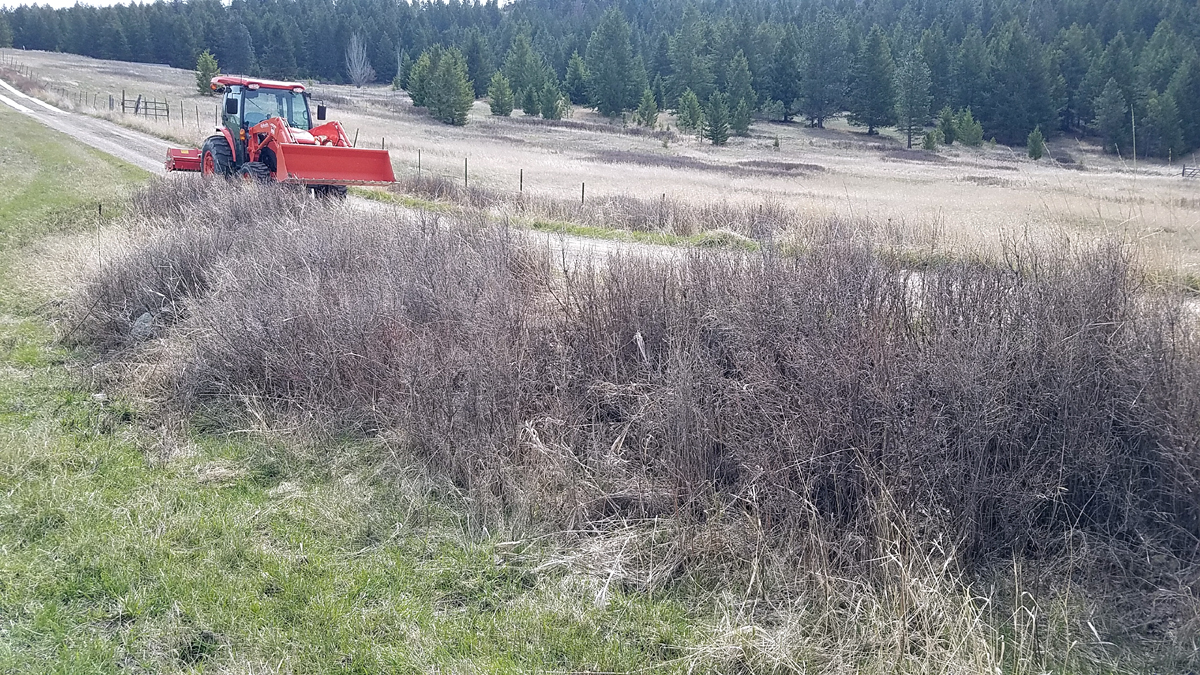

I am LOVING this flail mower. I'm still learning how to run it effectively but was able to cut an area that I've never even tried to cut in the 8 years I've lived at this property. There are 3 large rocks/boulders holding down or protecting one end of the culvert so I couldn't cut the entire bank, but it's so much better now. I also cut a strip on the other side of the driveway as a test and I'm pleased.
The photos don't show how steep the drop off is on both sides but I have to pay attention or else I could easily roll the tractor if I tried to cut too much.
