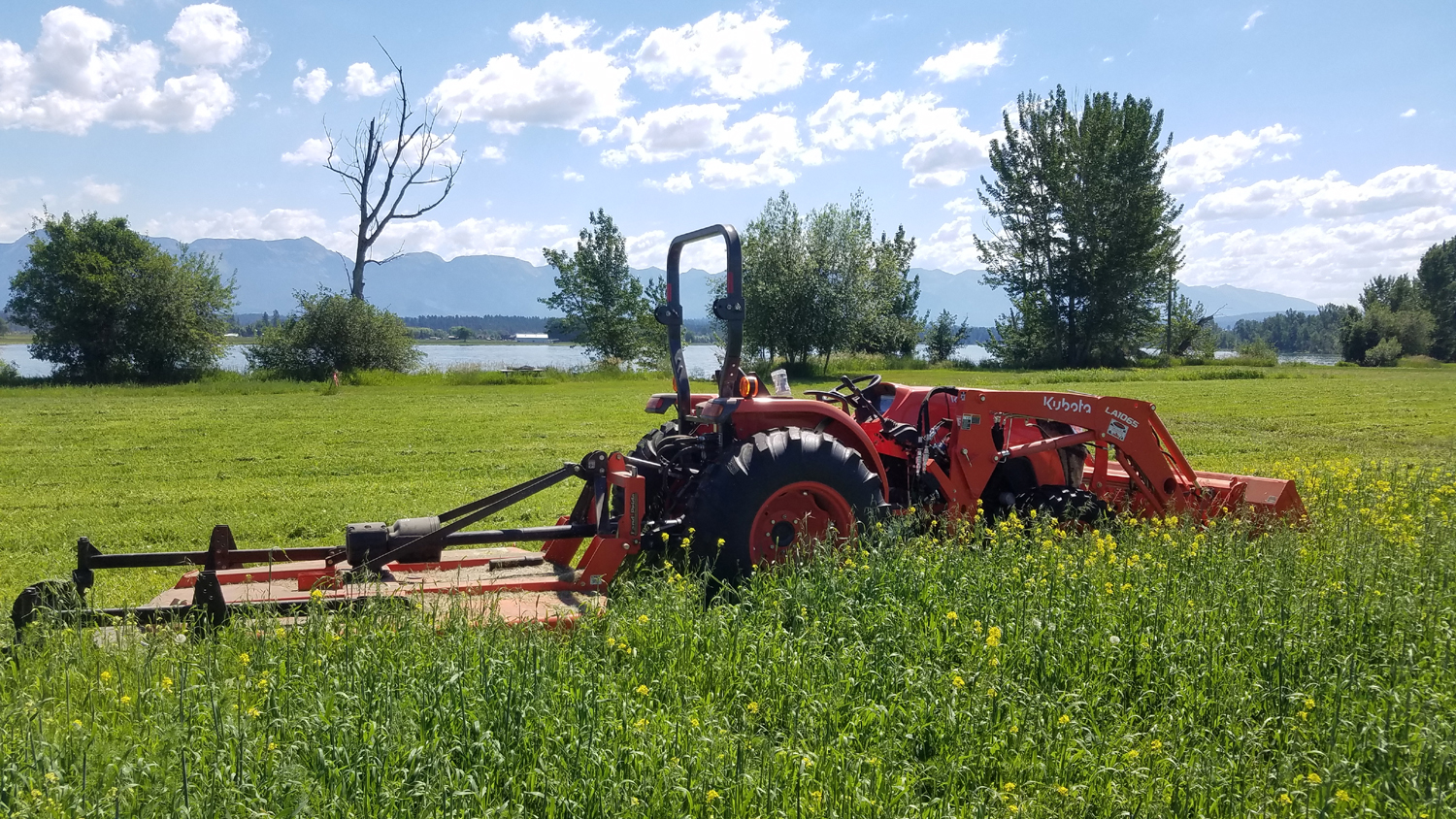

I ordered a flail mower today and hopefully it's as good as it's reported to be. I'll use it a few times before I decide whether or not to sell the RCR1884 rotary cutter. The mower is in stock and ready to ship which is a bit surprising. Shipping to MT is only $80 and it should be here the first week of April at the latest.
Anyone using a flail mower, and if so, do you have any tips/tricks?

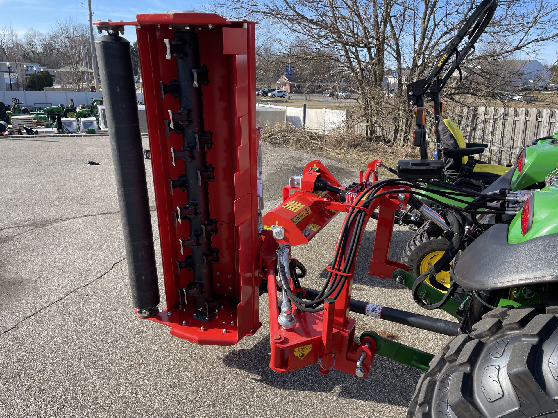

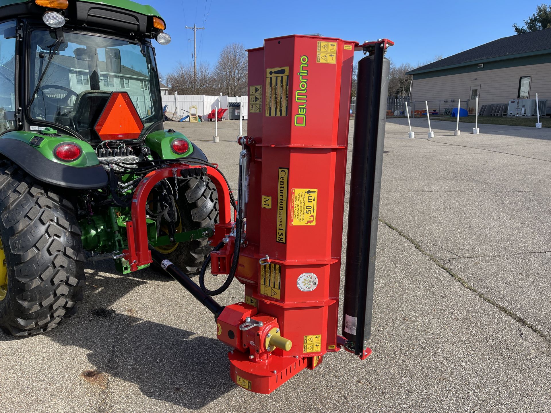

I ordered a Del Morino Centurion Super 158. I like the offset feature and the ability to cut embankments which is another feature I can really use. There are lots of area I can't cut with the rotary cutter. Total weight is supposedly 820lb and I opted for the hammers rather than the Y blades. I figure that the hammers will hold up better to the conditions I typically encounter.

@mcmxi that is a super nice unit. I am eager to hear and see some pictures when you unleash it behind your new MX.

Fine looking attachment. Good luck with it and checking that pto shaft length is very important :)

That, is a very nice unit.
I don't think you'll have any issue in tall grass with your HP. Just don't cut in reverse (if you can help it). Rather, if you need to get up against obstacles, raise the flail and back up. Then drop the flail and move forward.

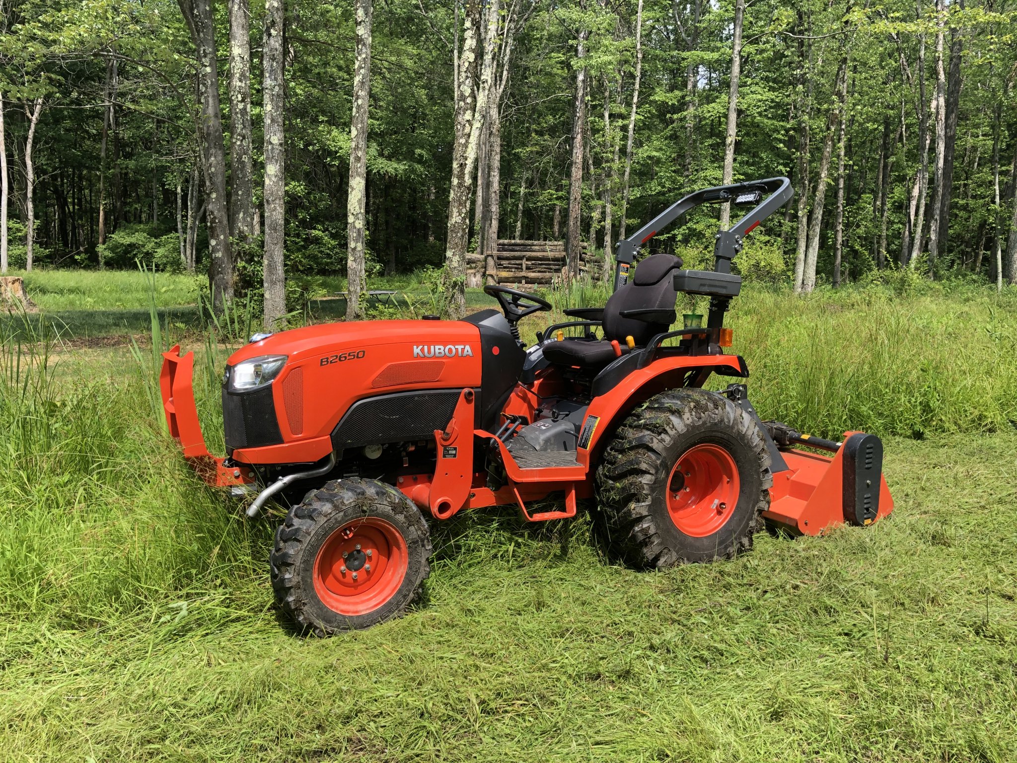

I have a light duty smaller unit with hammers...and it does quite the job.

That looks like a fantastic flail mower setup!!
