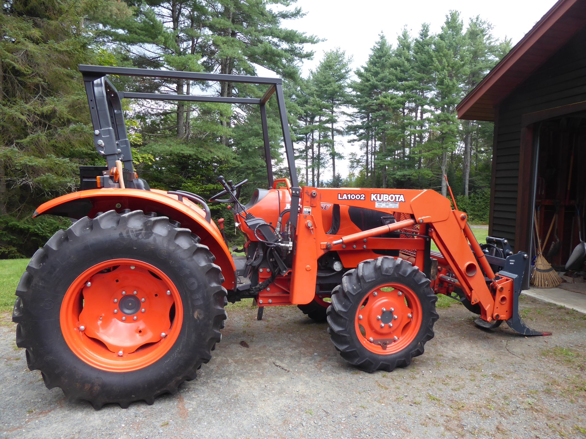

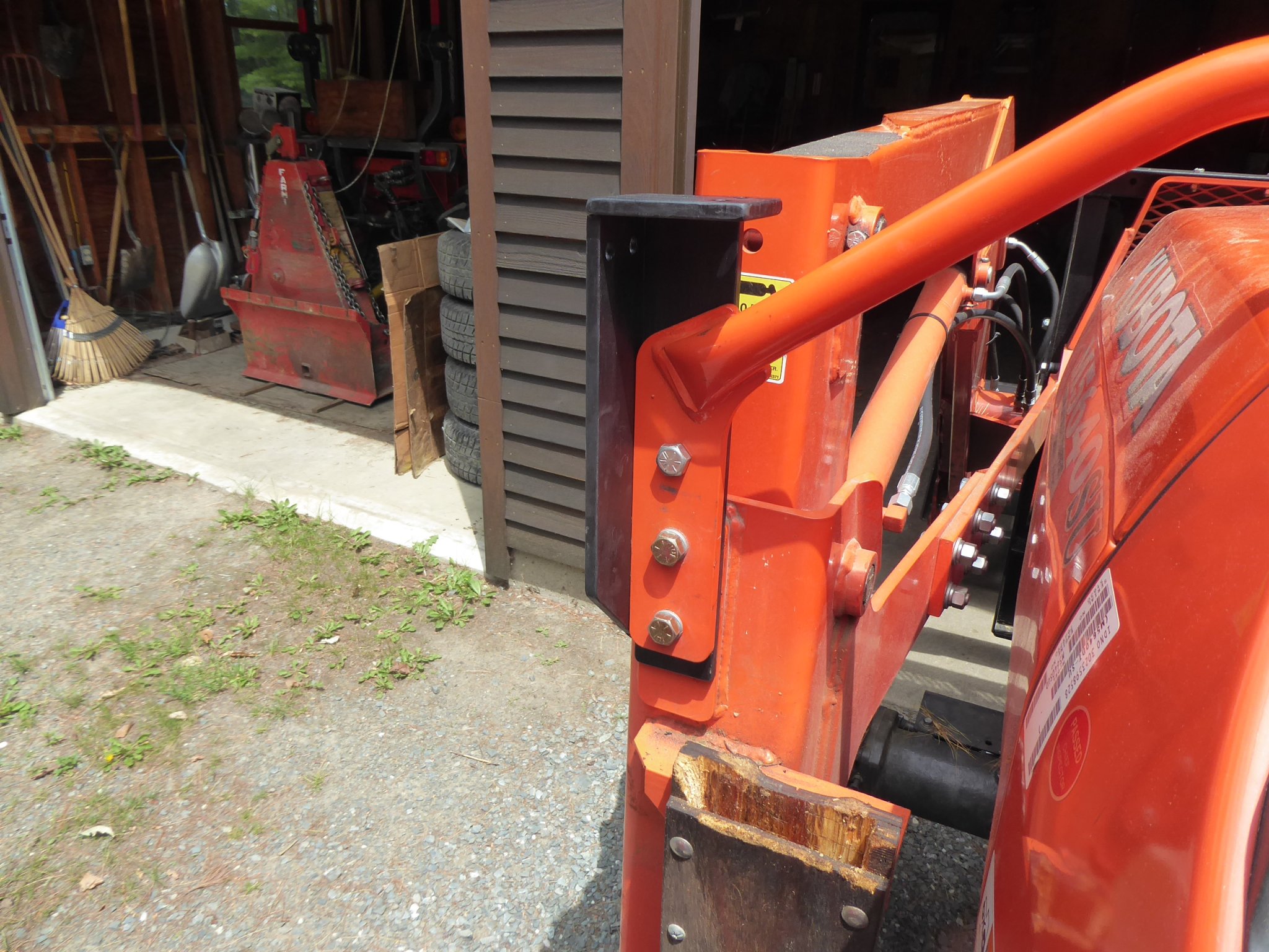

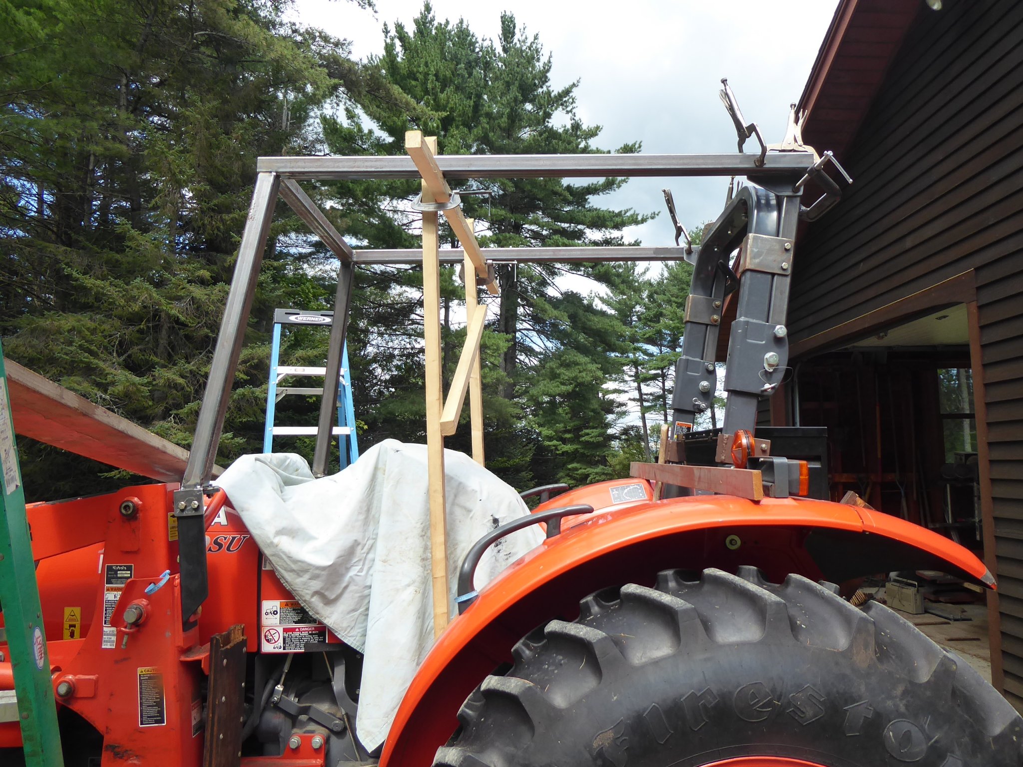

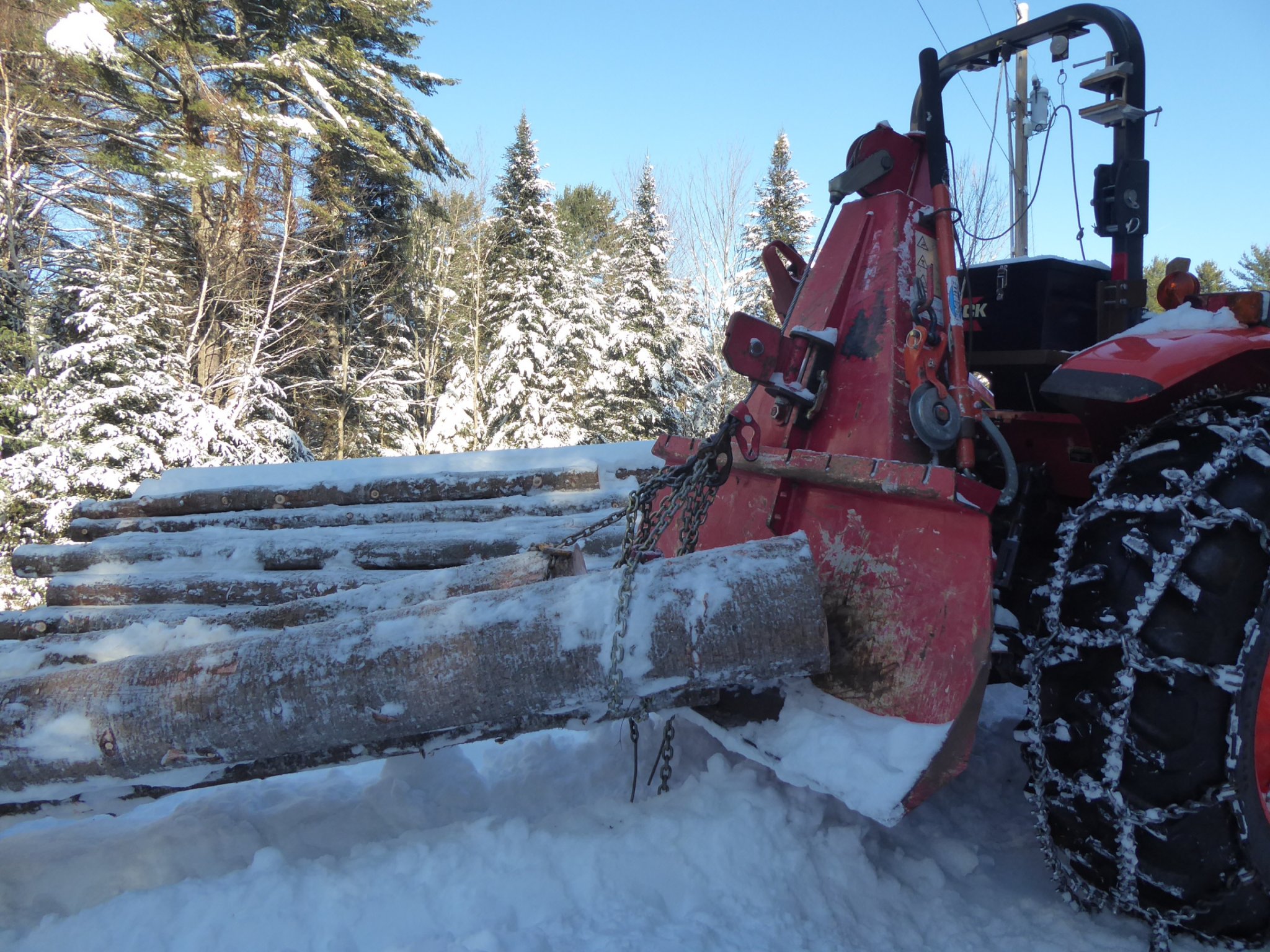

Somehow I missed your post - just got back from a trip out west to visit our daughter and family. I use my M5640 in the woods and built a cage with limb risers/sweeps. I wanted it to be bolt-on and removable. I used 1-1/2 X 3/16 square tube.

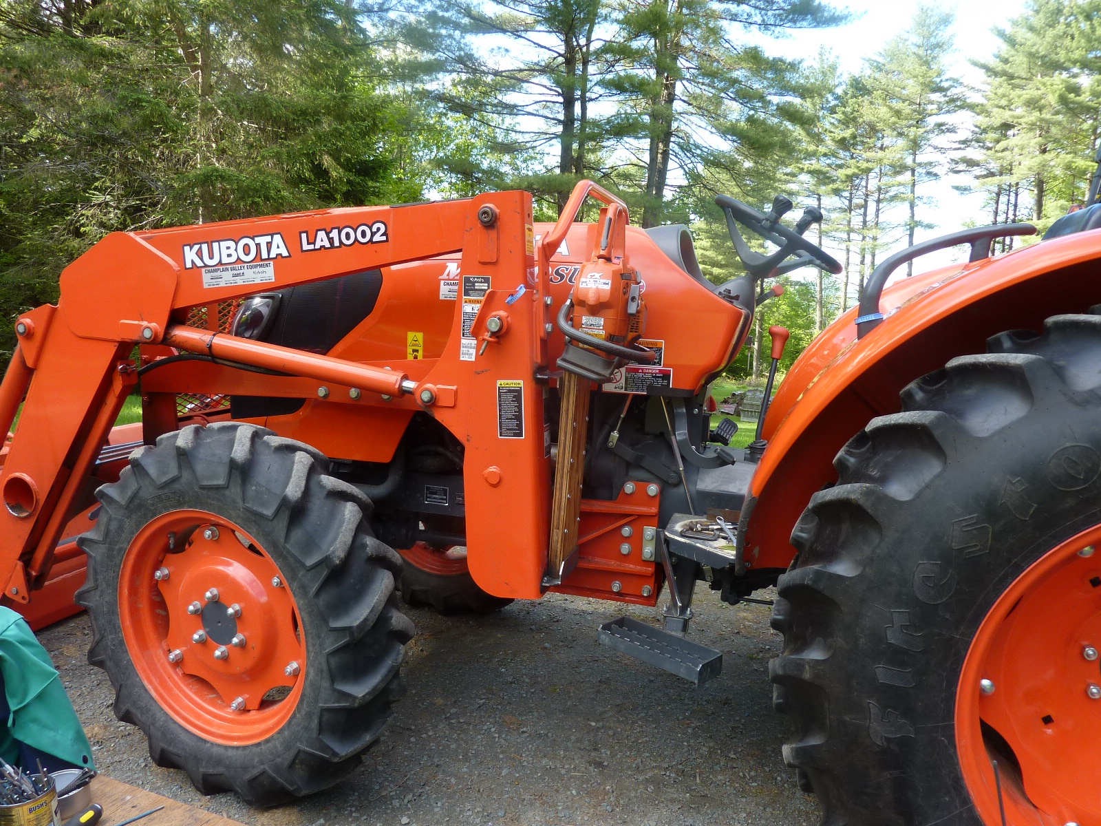

Some pictures of the build - Two short uprights in the rear clamp onto the ROPS and there is a bolt through a hole in the ROPS hinge. The front uprights bolt onto a standoff on the loader frame.
The standoffs bolted through existing holes and behind the loader frame cross brace.

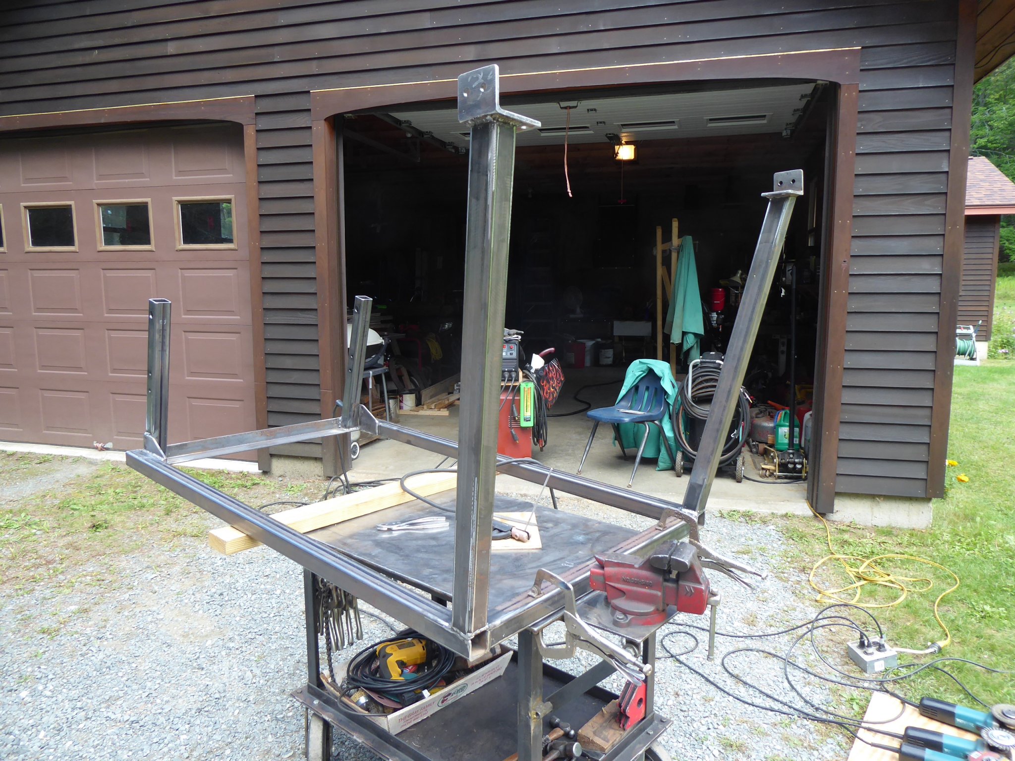

The cage weldment before the sweeps were added.
Might give you some ideas to think about.

Great job.
i would have bought that with the machine if it were an option…I am sure others would too. Very nice job!👍

Great work for sure, and one cool-looking and functional tractor.(y)

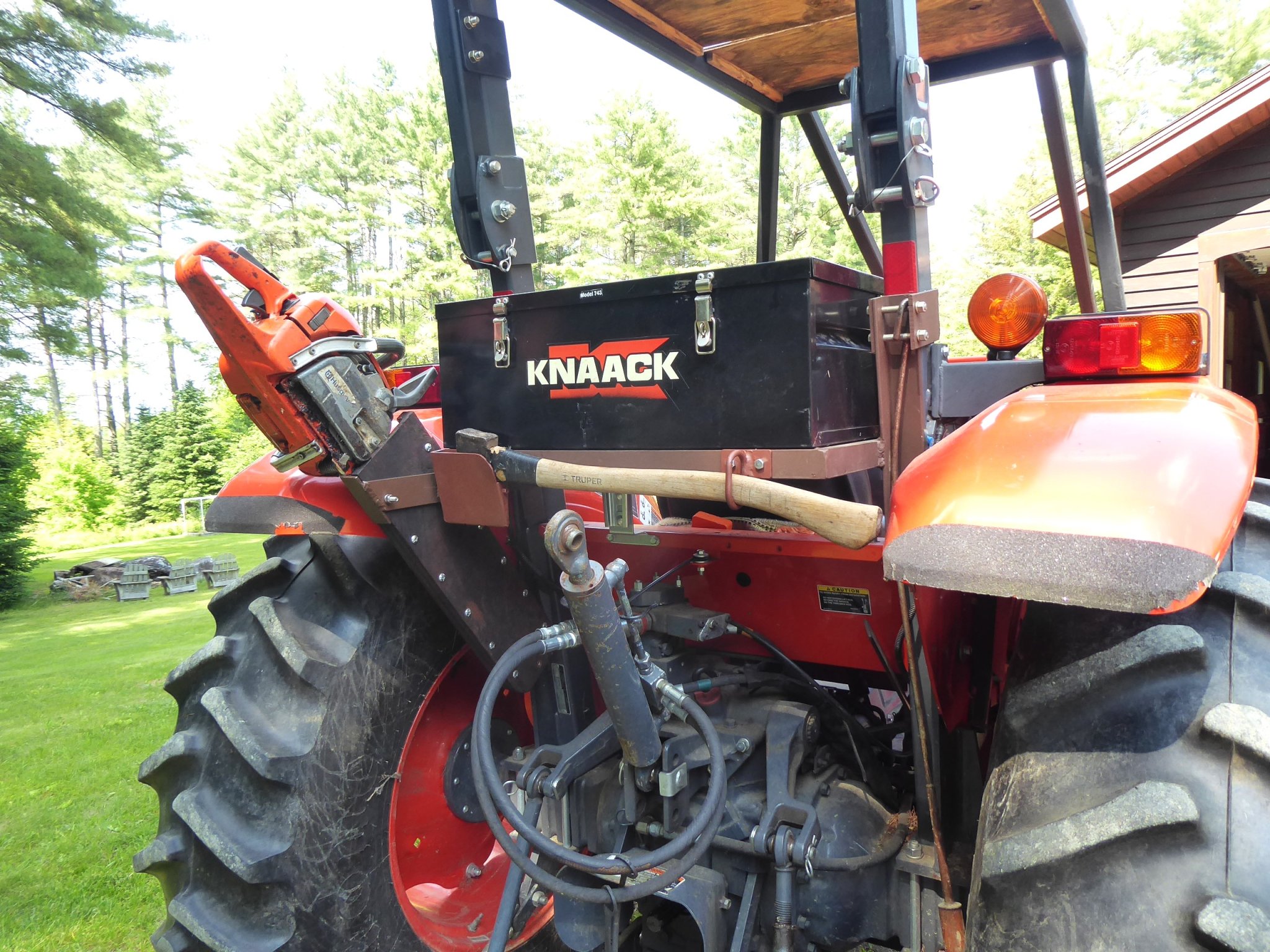

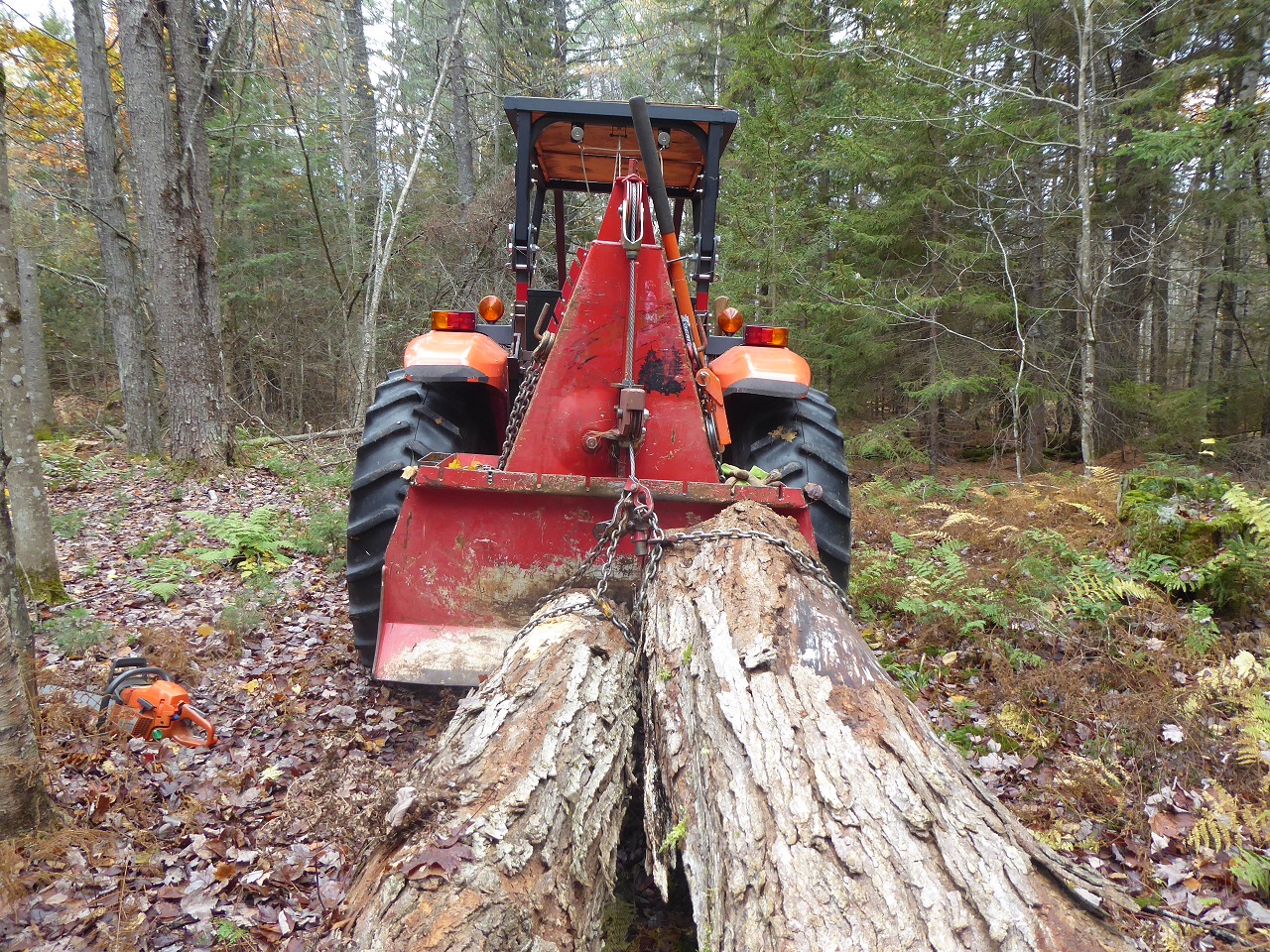

I see you also put a Chainsaw Holder on also. Going to make a "Cage" similar to yours. Might put an 1/8" sheet steel on top for a canopy.
That was my original thought also. But then a couple years ago the price of steel shot way up and I put it off. I like the idea of something solid over head.
Over time, years, I have improved the tractor set-up for the woods. The cage was the last thing I did.

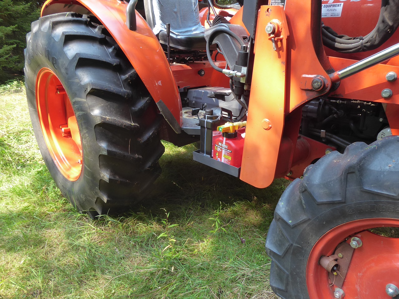

I carry two saws. My small light weight limbing and general go-to saw on the back of the left FEL tower so it doesn't stick out.
and my big saw in back.
gas and bar oil on the right side.
I carry a cant hook/peavy and snatch block on the winch.
gg

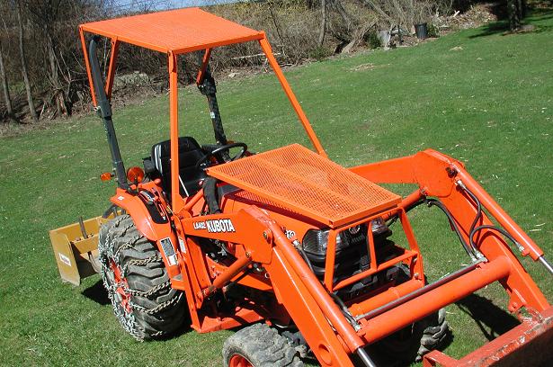

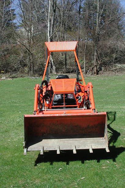

I built something about 15 years ago maybe, or probably 18 years ago.
My goal was just to protect myself if a branch fell down or something like that, and also to kind of hold the tractor upright if it wanted to tip over next to a tree that was on my side of the ROPS.
I used expanded metal and also build a guard for my hood. It possible to walk from the loader onto the hood and then up onto the canopy or whatever you call the top level. I put a piece of plywood over the top as a test and couldn’t stand the way it reflected the sound back down, so I ended up just putting a piece of cloth and it works quite well as a canopy to keep the sun off.
My design angles down to deflect branches upwards, and tapers in at the front a little bit too give me a little more clearance. If I’m going past a tree the ground is angled a little bit.
Also the vertical uprights in the front work very well as grab handles getting on and off the tractor when needed.
