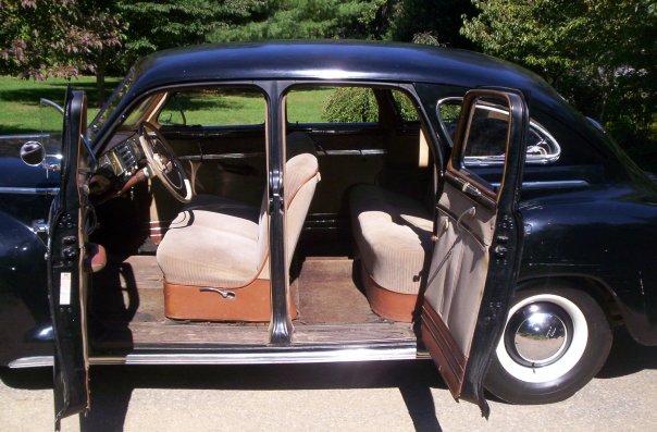

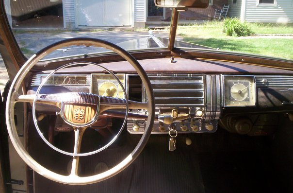

Here are a few pics of the 42 dodge prior to being dismantled for restoration. Im also getting the garage insulated finally and also purchased a Resnor heating system so I dont freeze out there any more!:D

Jeese you did all that in an unheated garage? Your Platinum Man Card will come in the mail in 4 to 6 weeks. I wouldn't have even considered attempting my rebuild over the winter without a heated work space. Burrrrr
Beautiful work on the Dodge! My neighbor's got a Buick of similar vintage (it's a tad older I think) and design. I don't remember much about it other than it's a three on the tree. It hasn't left his garage much since he finished his resto back when I was a kid.
