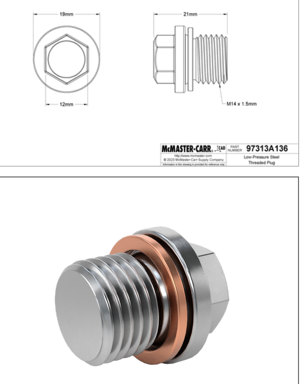

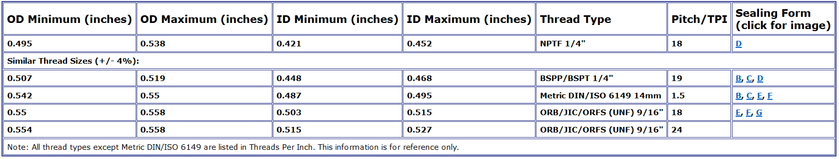

ANYWAY - took the plug off and stuck the new .500 Fumoto plug in - goes in and does not even touch the threads! Big wtf moment!
I measured the major diameter and the minor - here are those numbers .536" Major -carefully measuring the OD of the thread and then measuring the minor diameter of the threads I got .492"

Why wouldn't a 1/2" threaded valve not fit into a ~9/16 hole?

so the major diameter of the 1/2 -20 is damn close to .500 - the bolt that came out of the pan had an OD of .536 - so that .500 Fumoto went it without a twist!

It sounds like the drain plug was an oversized or double oversized repair plug that was installed by a previous mechanic. Yes, they make drain plugs to fix oil drains that were damaged by excessive tightening.
