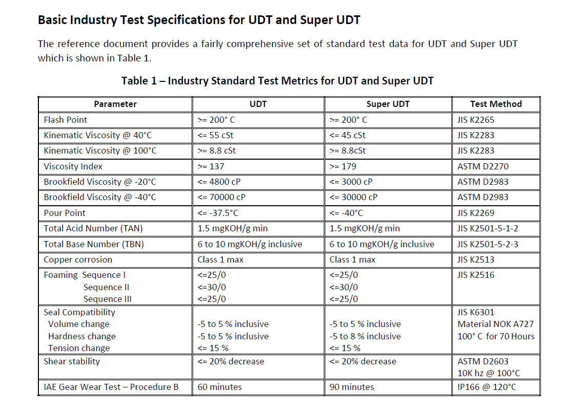

That my friend is exactly Kubota's marketing strategy.
UDT (Universal Dynamic Tractor) oil is as generic as it gets.
SUDT is a low viscosity formulation with enhanced water tolerance. At the time of its introduction (1999) Kubota had lots of information on the new formulation. That wuickly went POOF.
If I gave you that data would it change your mind?
That all depends on the data, I suppose.

Thats a super good answer. OEM's do not formulate their own oils. The develop perfromance requirements using industry test methods. They give those requirements to formulators who are free to use whatever chemical concoction they want as long as the finished oil meets or exceeds the performance requirements. Here are the basic performance requirements for UDT and SUDT.

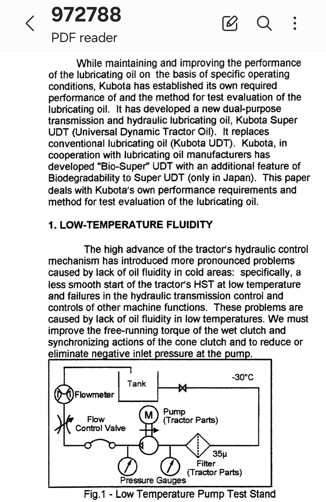

In 1999 Kubota published a SAE Technical Paper describing in some detail their development of a new high performance SUDT oil. They motivation they gave in the intro was the more demanding requirements of HST and powershift transmissions and they were focused on three things:
  1. Pumpability and filterability at very low (-40C) temperatures
  2. The ability to suck up water contamination in wet environments - specifically rice paddies.
  3. Wet brake and PTO chatter in the presence of water
Gear drive transmissions can obviously benefit from those improvements but not nearly as much as an HST or powershift. Bottom line is SUDT2 vz cknventional UTTO is like 5W40 full synthetic versus 15W40 conventional engine oil. Both are acceotable but one out performs the other at the margins.

At the risk of offending the Copyright Gods here is a snippet from the engineers at Kubota. Two things I would like to point out
  1. UDT is described as "conventional lubricating oil" which is exactly what it is. Literally hundreds of functional equivalents.
  2. The perfornance problem being addressed is negative inlet pressure at the HST pump and loss of HST response at cold temperatures. The solution is straightforward - an oil with lower pumping viscosity. Kubota devised their own test stand for this property but for all practical purposes a standard Brookfield viscosity works as a comparaative measure. The test temp for the original SUDT qualification test was -30C and Kubota is now publishing Brookfield results at -40C for SUDT2.
