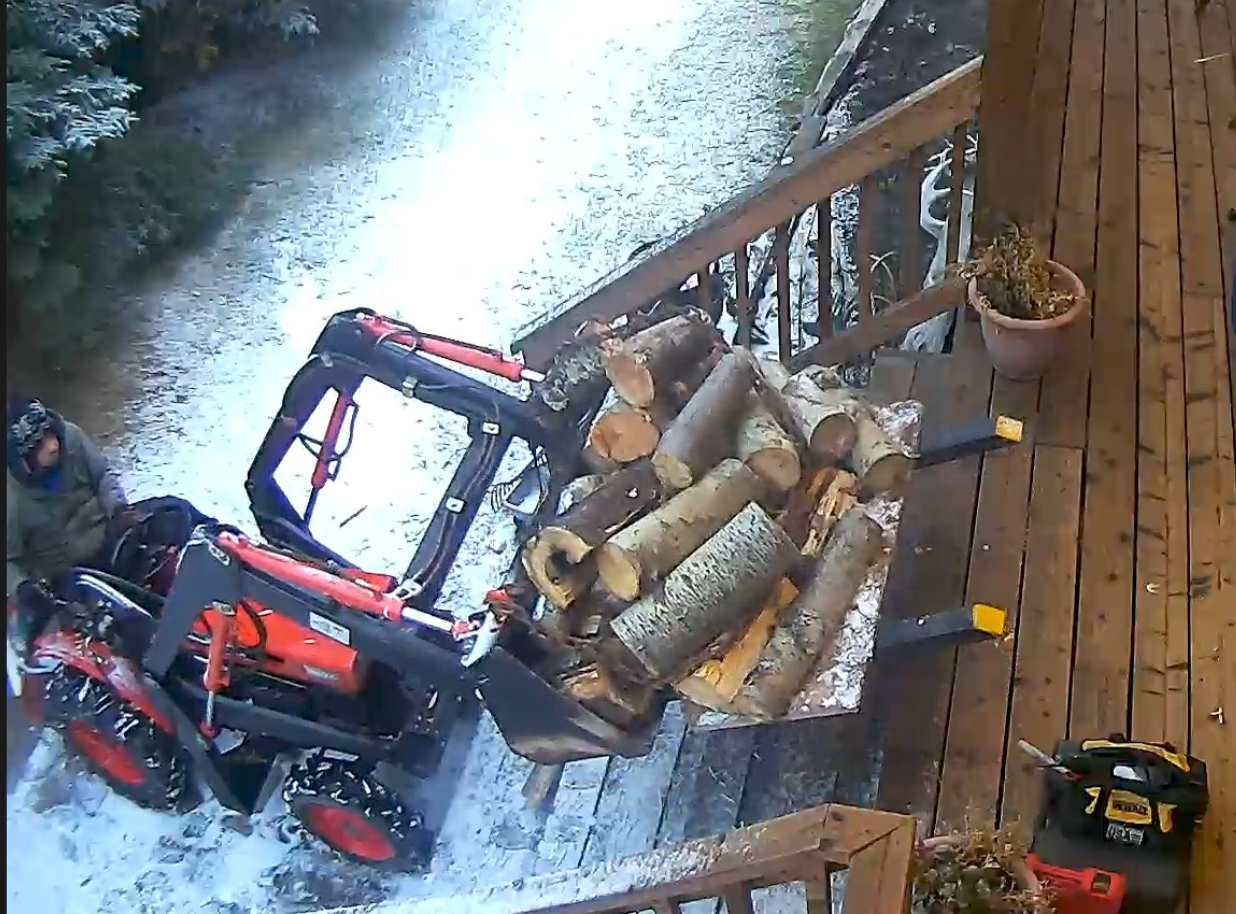

The bucket and pallet forks work great for loading wood onto the deck for the week.
Saves a bunch of going up and down the stairs.

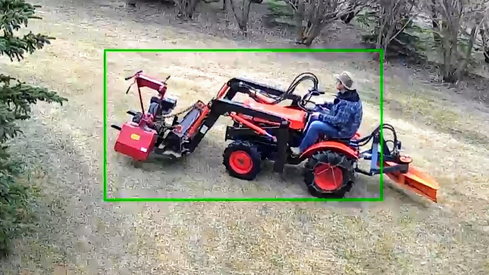

Fired it up for the first time this spring today.
It started up easy and worked well to bring the walk behind rototiller up to a small garden bed by the house.
The tiller didn't fair so well though. It needed a carb clean before it could be put to work.
Pretty sad when the few year old piece of equipment doesn't work as well as the 50 year old stuff.

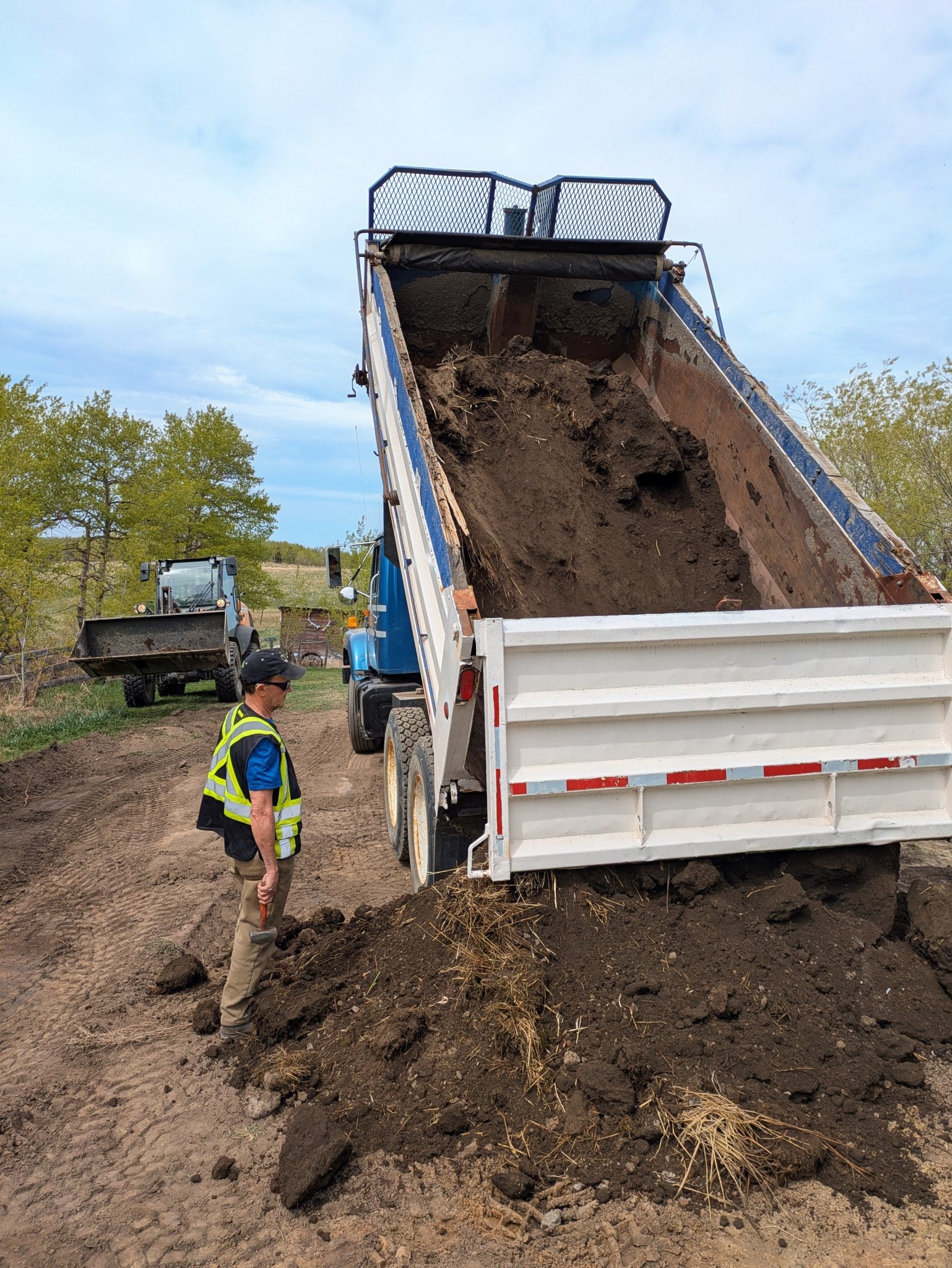

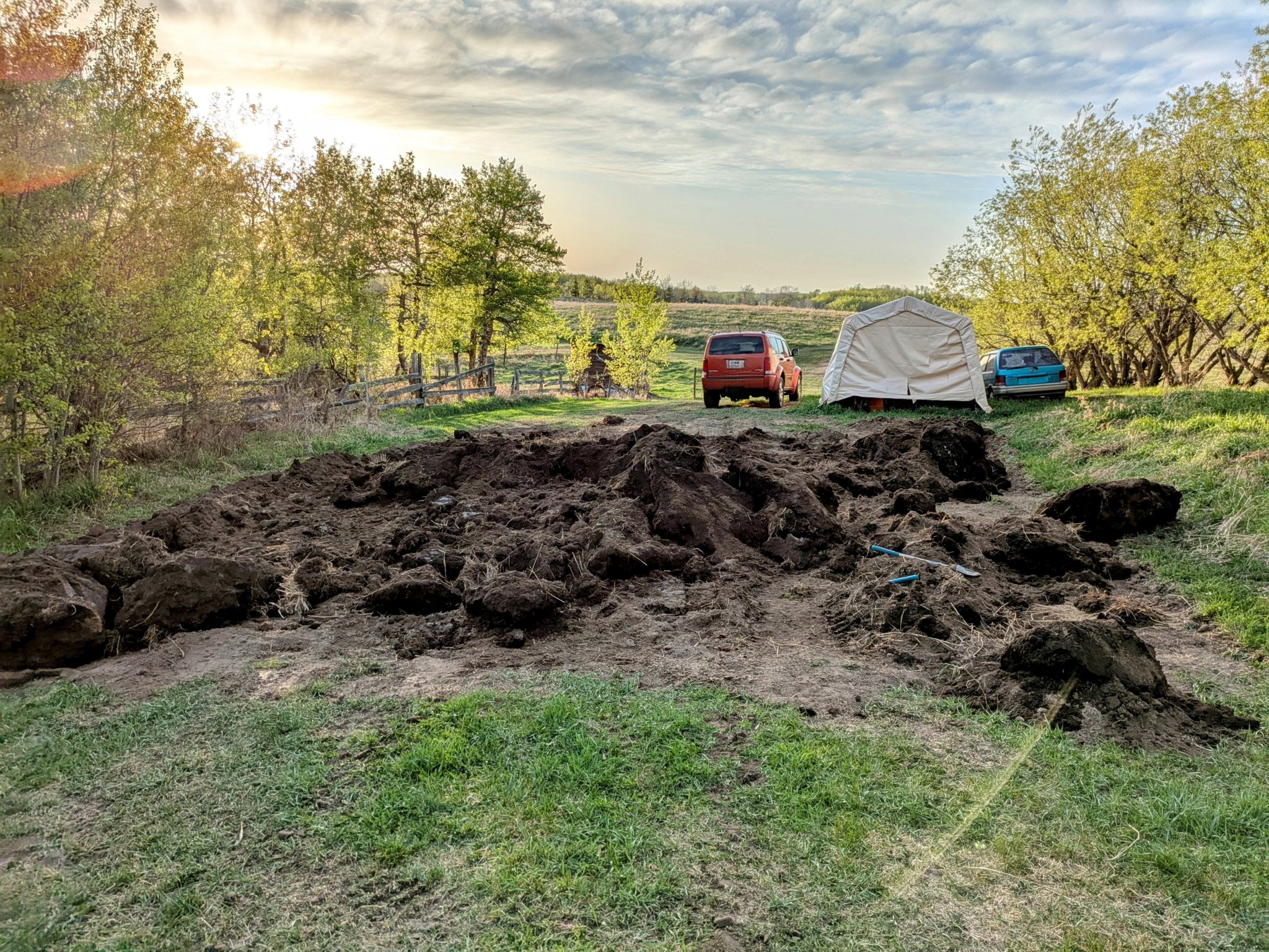

The B6000 is going to get it's first real workout.
We took out 2 dump truck loads of old mostly clay out and dumped 5 dump truck loads of fresh black dirt from a dug out that was made last fall onto the wife's garden.
It looks like there's lump of hard stuff but it's actually frozen black dirt. The middle of the pile still had ice in it.
The wheel loader did most of the work breaking it up and spreading it but hopefully the B6000 will manage once it's thawed out.
If not I'll call for reinforcement from the wheel loader.
A few beverages of choice, a generous amount of dollars to refill the diesel tanks and some good neighbours go a long way.

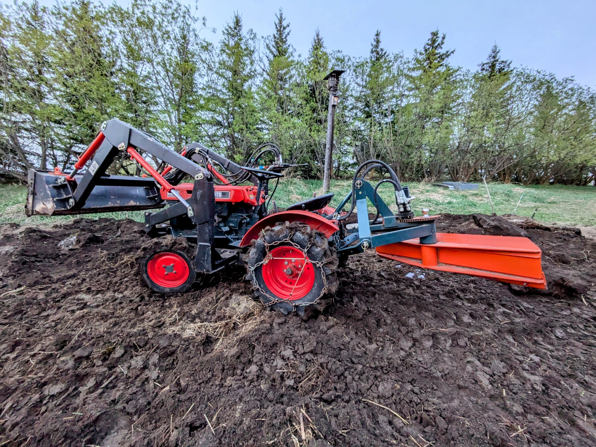

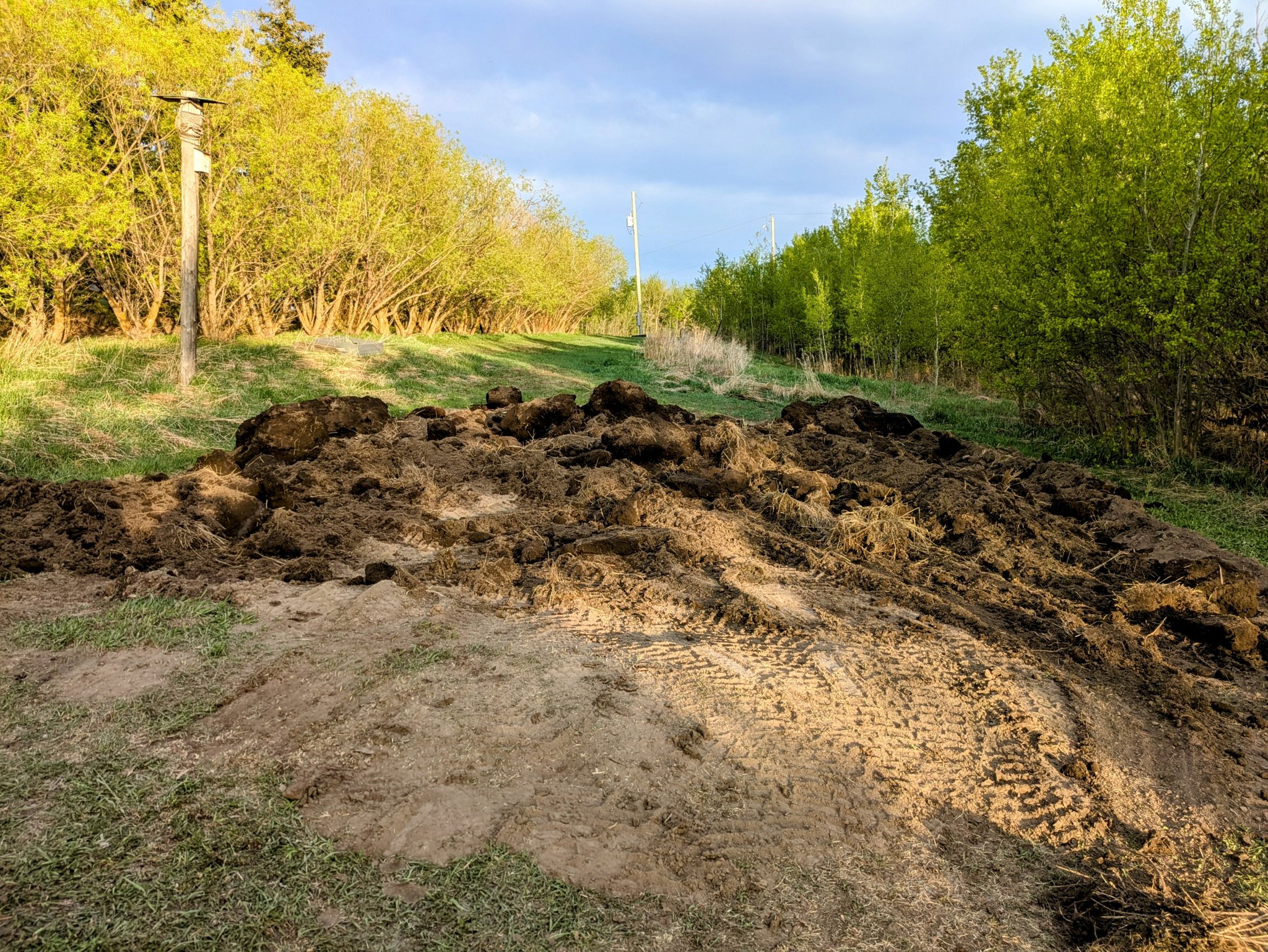

No problem digging through the dirt and spreading the piles.
Only took 30 minutes tonight after the kids went to bed.
A few clumps still frozen but another couple of days they should be good.
And then put the rototiller back on and time to plant.
