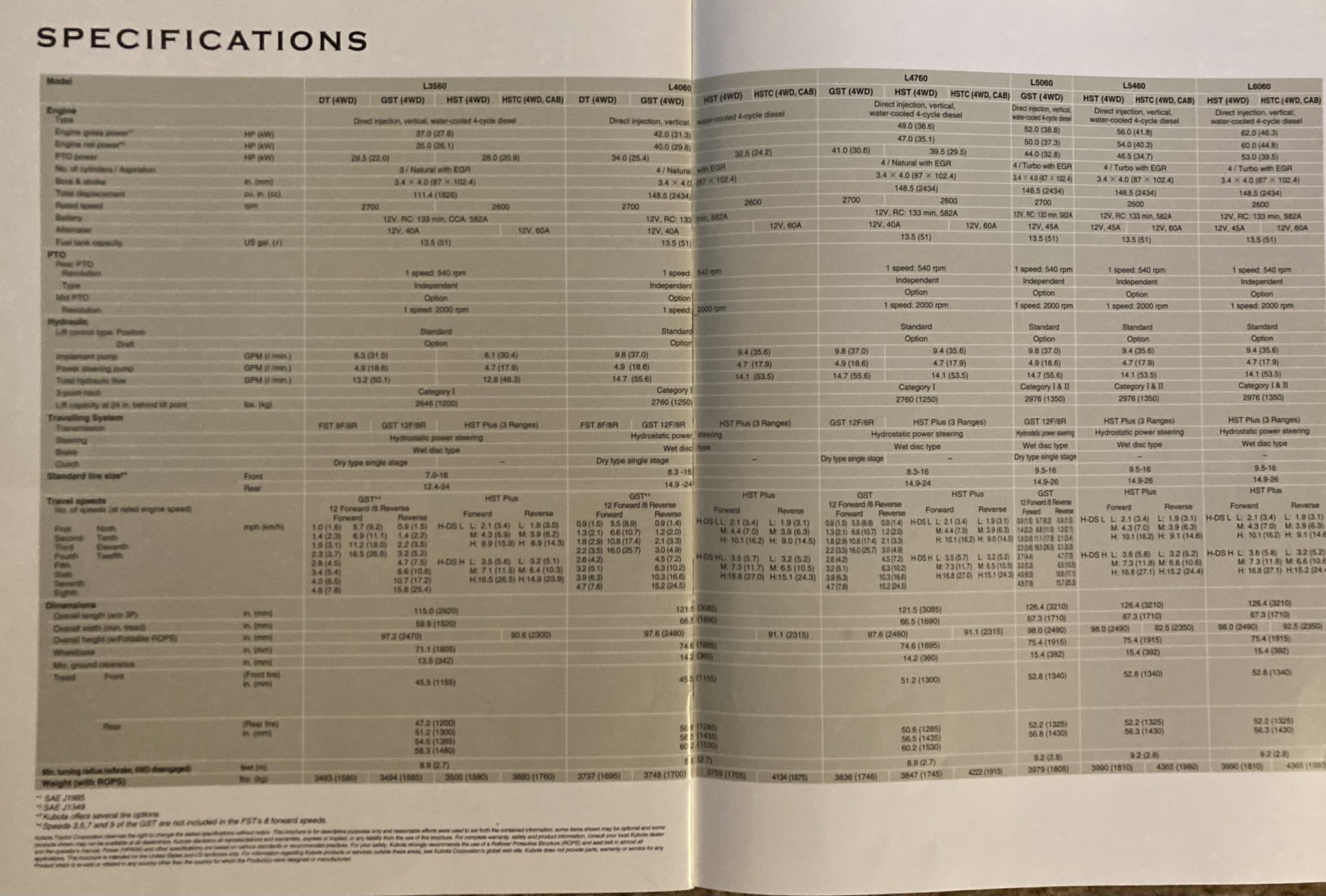

Download some of the Kubota brochures, LX, Standard L, Grand L, L60 Limited Edition (e.g. Grand L lite, L3560 and L4060) and MX. That last page or two has all the specs, ROPS height, weight, horsepower at PTO, turbo or not, tire size, width, all of it.

Now I could be reading this wrong but doesn't the direct injection basically mean the same thing as a turbo? This is in regards to the L3301, L3901, L4701
Nope.
Check out the spec sheet for the Grand L series (L60). See the “Turbo with ERG” in the “No. of cylinders/aspiration” row, staring with the L5060. You’ll note all six of the Grand L sizes have direct injection, the first three are “Natural with ERG” for aspiration.
